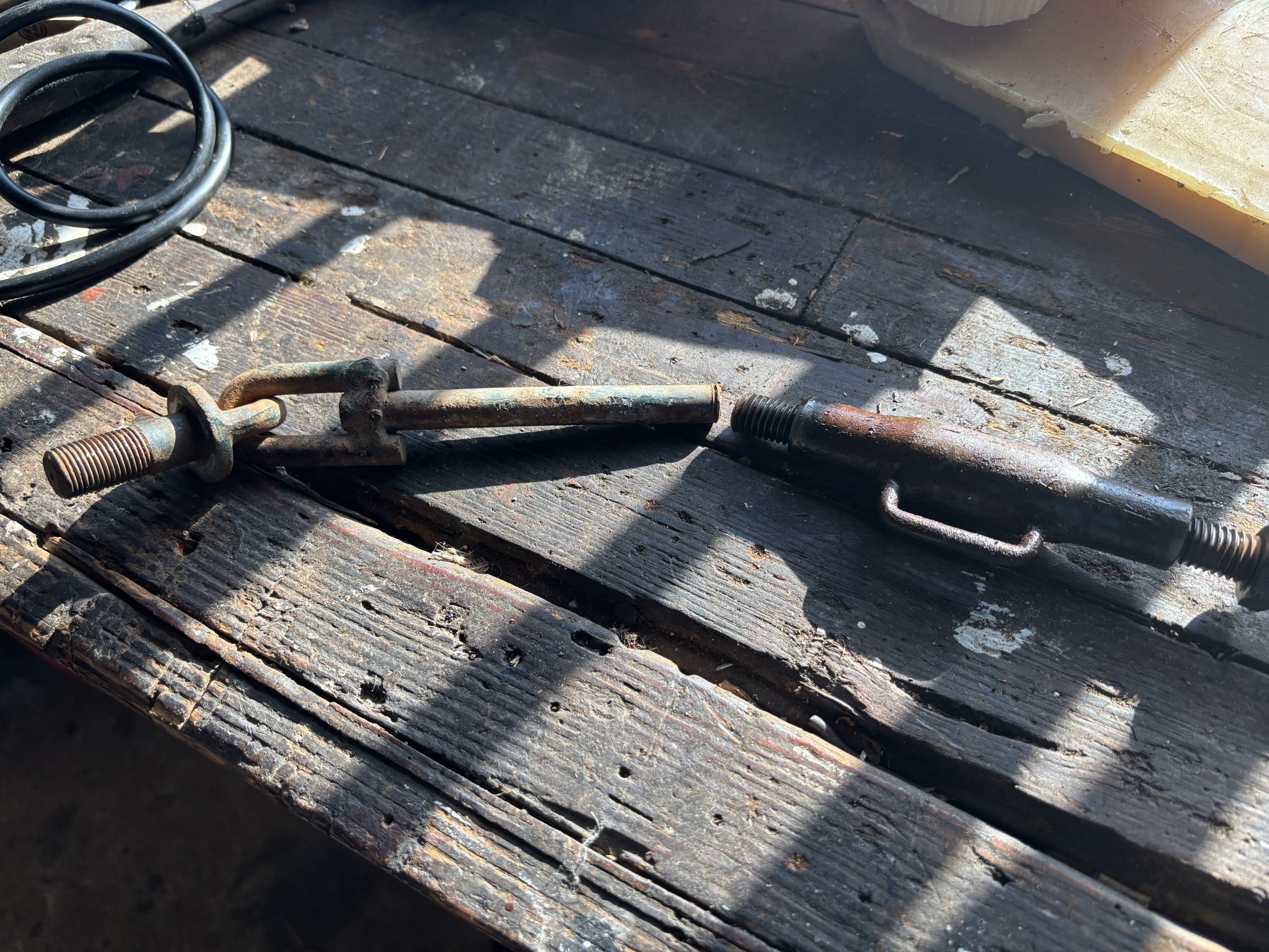

Broke lift arm turnbuckle stabilizer on my L275DT- what to replace assembly with?
timsch
'49 8N, L275DT
Jun 11, 2018
119
23
Houston, TX
I got impatient and heavy handed with a rust frozen threaded rod in the stabilizer turnbuckle and sheared it off at the thread. I'd consider welding it back, but that'd probably not hold up to the torque required to get the still stuck rod out even if I keep soaking it with Kroil.
I've seen similar turnbuckles, as well as chains, but looking into this, I found out about telescoping stabilizers. I haven't found any that will work for my L275 yet though. I don't know if there are adapter kits for some telescoping stabilizers.
The OEM stabilizer connected with a 16mm shaft going through the lift arm and a nut on the other side. I can salvage that part of it as needed.
What is my best option here? the tractor gets somewhat limited use, so I can deal with a little bit of a PITA regarding adjustments as long as it's a reliable solution.

I'd kroil, heat, wax or whatever to try and extract the threaded part. Small pipe wrench on it or grab it in a vise. See if you can find just that end of the assembly at a dealership. If you can't find it just buy a piece of left-handed allthread. You can cut the broken part out of the eye and weld the allthread into it. Short pieces are on the net for under $10.

It was a pipe wrench and a vice that got me into this predicament. Those threads are stuck pretty bad. Overnight Kroil soaking was not quite sufficient. I was heating and adding wax this morning, and I thought I was getting movement on one side, but then the other side that was clamped in the vice broke.
Maybe a week long soaking with Kroil would have worked. I'll probably need the tractor before then, hence my impatience this morning. I should have known better....

I had a similar situation.
I clamped the part vertically in a vise, and sprayed the threads (and tapped) daily with Kroil.
Took a couple weeks, but eventually the Kroil followed the threads, and I got the assembly apart.
PATIENCE!

A heavy duty turnbuckle of the appropriate size will do the job. Readily available at TSC or hardware stores. I have two purchased from TSC on my old B7200.

Don't soak, SUBMERGE the part(preferably quite warm) in oil, then walk away for at least 2 days.
You need patience to allow oil to slowly seep into the threads.

I'll try to fix them for backups. If I can make a sleeve to slip over the welded joint and then weld that also, the strength would be there. I'd lose a few threads, but will anyway.
I've soaked parts in diesel fuel before (not this part), without any success. I didn't heat them before, though. I don't know if oil would be different...
