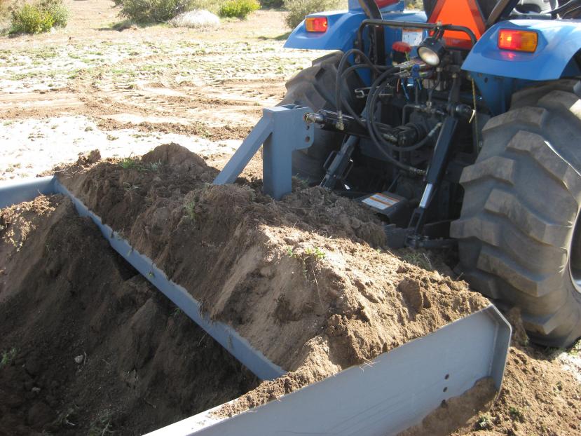

I built a grading scraper last year to take care of about a mile of cabin road. Used to use a rear blade cranked off at a sharp angle to knock off the tops of the wash board. always had to keep adjusting the blade height. With the grading scraper it's pretty much drop it and drive. It rides on as set of skids about 5 feet long that skim over the top of the wash board, while the cutting edges shave off the high spots and recycle the gravel into the low spots. It was a great investment.
Works faster and better than the back blade, and less feathering of the attachment than with a box blade. As for transporting larger amounts of material . . . I have had so much material in the scraper that the hydraulics wouldn't raise it from the the ground! I've had to back-up to release some of the load in order to raise it. This situation is most common with moist soil, or with the sod that grows in the center of the road.

Something like this? :)
