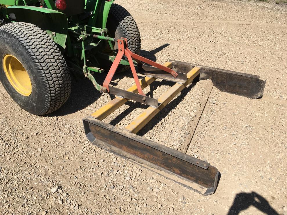

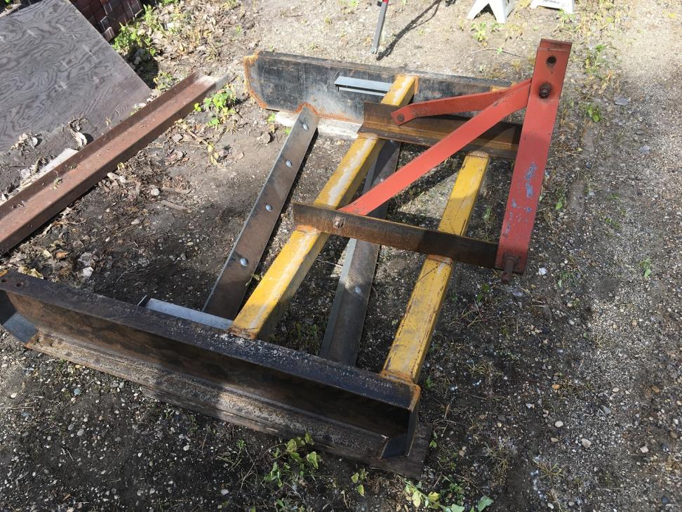

I had a box blade that was bought way back for use behind my older JD750MFWD (20 HP) Not long ago I became aware of how nice it would be to have a land plane but balked at the price of a new one. Since the box blade had two bolt on hardened blades along with a bolt on 3 pt hitch, I decided why not share those pieces to make a land plane. With some scrap heavy duty channel iron for the sides and a couple of cross pieces this was the outcome:
I can also lay a heavy channel iron "tray" across the top for extra weight but haven't found it to be necessary yet. Sure doesn't take much HP to pull it and does a terrific job. Next step is to sand blast and give it a Kubota orange paint job this summer. :D Probably could fab up a way to mount the scarify teeth to it one day. the overall width is just shy of 5 ft due to the angle of the blades from the 5 foot box blade.
