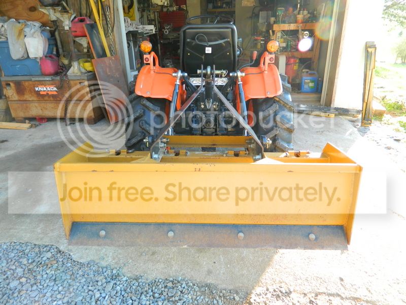

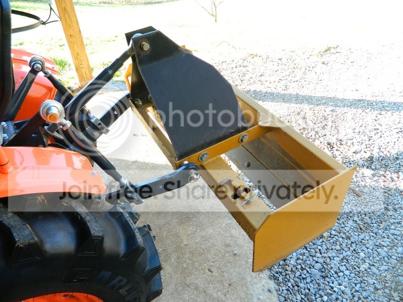

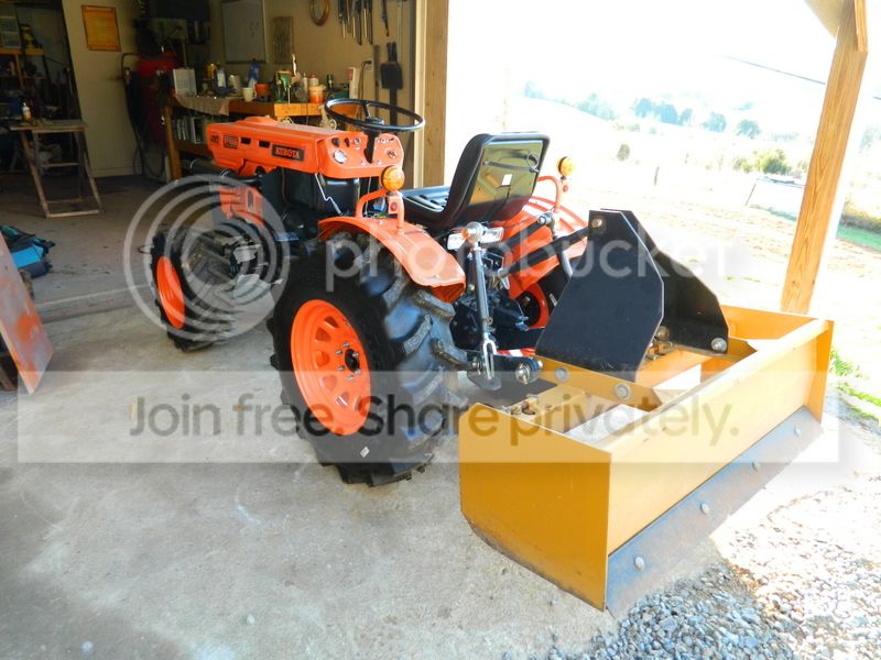

murph,,, how about a little more detail on that box blade
I had just brought up the box to break it down and paint it tonight, will paint to match the tractor.
Sold by State Tractor in White Pine TN. Local manufacture. $395
The rake is custom made for me, note the inverted turret, changes angle for the lower 3pt height of the compact.
Rake was also $395
There are local manufactures around the country, better quality and price than the big names.

Beautiful tractor Murph.

Ismurphy, seeing is how you own the beefiest looking 7100 I have ever seen I have a suggestion for you. Go to tractordata.com and pull up the B7100 and then go to the photo section. There's a contact for Peter on there, send him a photo of your tractor and in a few days he will get it on their site. I have my M9000 and L3000 both on there.
That is one cool tractor, really makes me miss mine.
