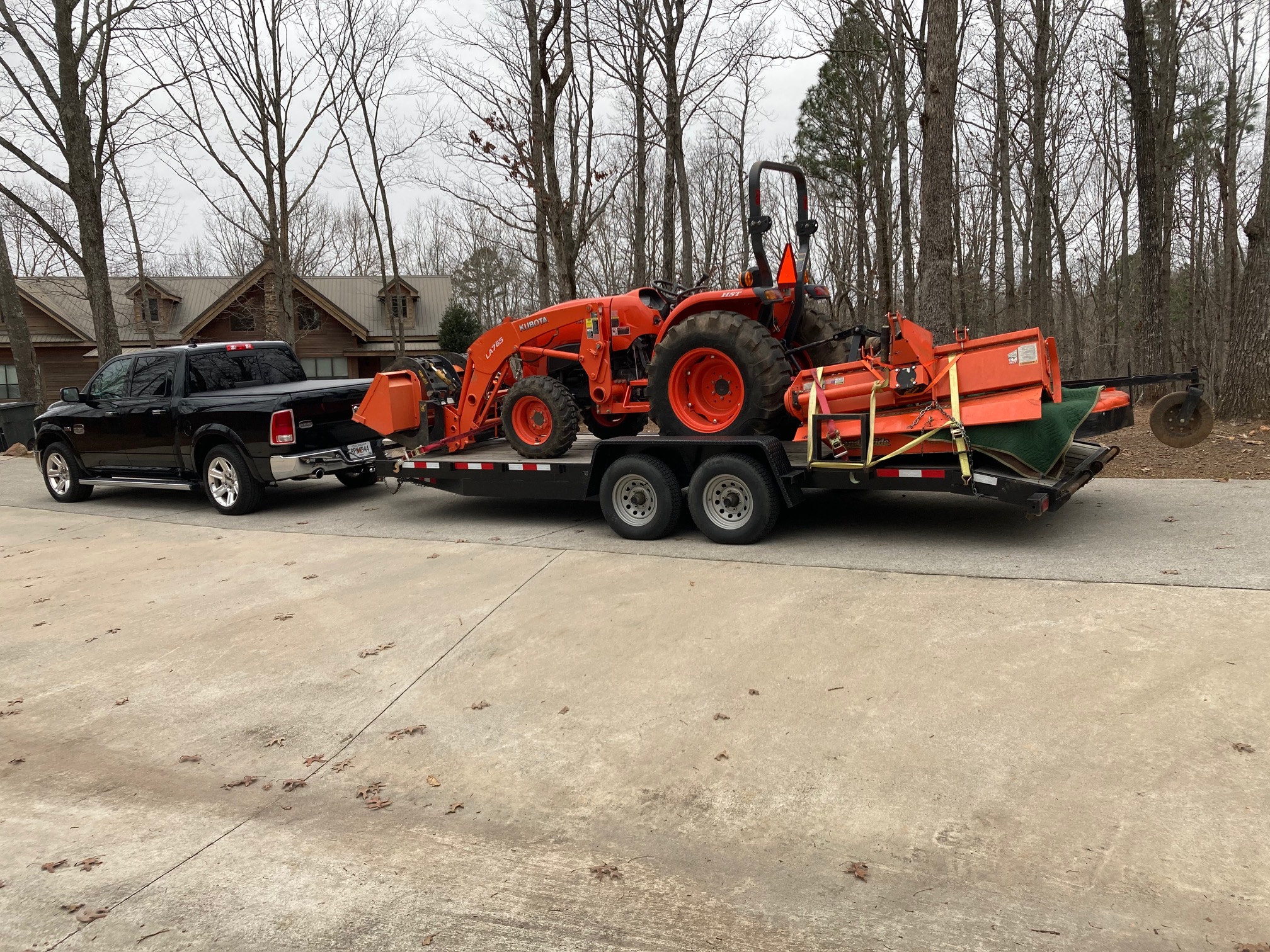

Welcome!!
Very creatively loaded up that trailer! lol

Welcome!!
Thanks! They guy had it set up that way when we got there. I wouldn't have thought about setting the tiller on the bush hog..
