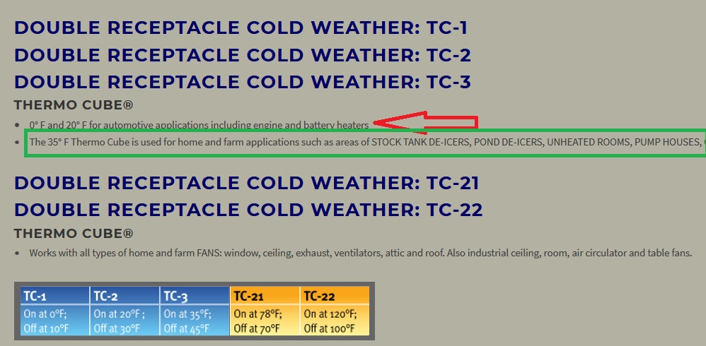

I think the thermocube turns on at 35 deg. If so, the heater would be on for a long time!
I think they have different versions depending on your intended application.
The Thermo cube for 35 F operation is designed for stock tanks and other water situations where you do not want freezing to occur. forum thermocube.jpg
There are two other temp ranges suggested for automotive applications. O F and 20 F T-1 and TC-2

On that thermocube doesn't it come on a 20 deg and off at 30? For me, in the weather we're having now it would not shut off for several days. The shut off temp is ambient air temp, not temp of engine block, correct?
Yes it does. Sorry I misunderstood your previous post.
