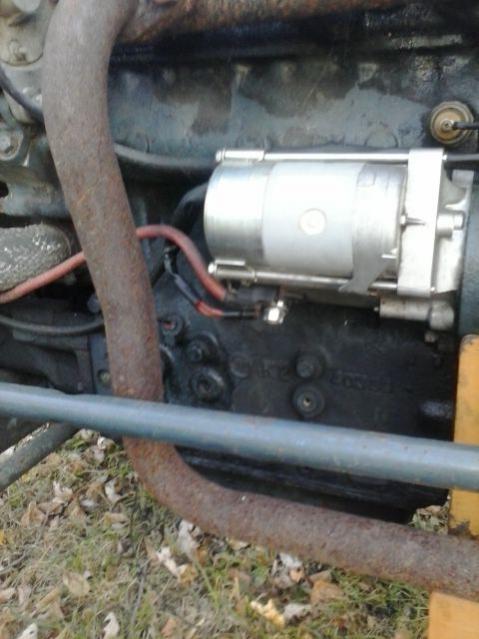

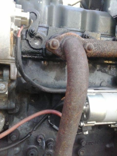

OK here is left side of engine. there is some approx 20mm press in ports in head by each exhaust port... and one 10mm? low on the block.
None behind the starter that could see. There is ( upper right first pic) the screw in port for a sensor. Not sure if it is temp or oil pressure installed in it. Are my eyes deceiving me?
Cglaza
L2500DT, BX2380, G6200H
Aug 30, 2015
176
Freeland, mi
That sensor would be an oil pressure sender sir. Your coolant temp sensor would be installed in the head of the engine. :)

Well..... :eek::p:eek::eek::eek::eek: ok now I'm embarrassed. This engine is not badly dirty, but just dirty enough that it TOTALLY masked the left side freeze plugs. Completely camouflaged; filled with dry dust making them same color as block. Looked at the engine a good 50 times and just now discovered them.
below is camouflage in its full glory
