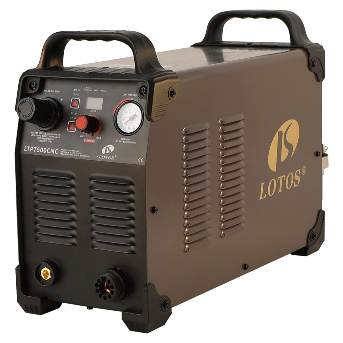

I have a LOTOS and have had excellent use with it.
Blazes right through 1/2 steel!
As do I.
https://www.amazon.com/dp/B0052OX876?ref_=ppx_hzsearch_conn_dt_b_fed_asin_title_3&th=1
For 200 bucks, you can’t go wrong.
It is a “game changer” in regard to metal working.
The Lotus is cheap, effective, and for basically 350 bucks (including tax, some consumables, welding gloves…blah blah blah) you’re cutting metal fast and easy. I love mine, and highly recommend it for the money.
Just yesterday, I used it to quickly and easily trim off some corners for a project I am working on.
