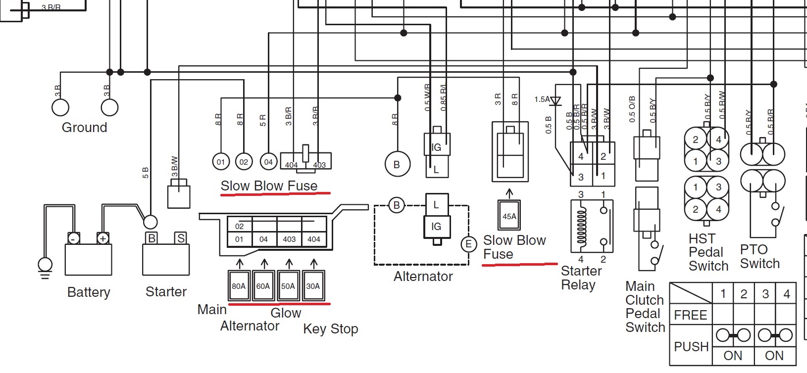

I looked at the wiring diagram for the L3130 HST model and was surprised to see 5 slow blow fuses in addition to many regular fuses.

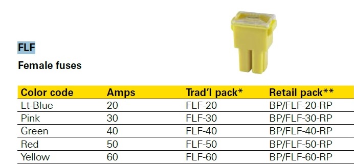

Here is a slow blow color chart up to 60 amps but the wiring diagram has one going to 80 amps.
Answer North Idaho Wolfman's question about what is or is not working now. It will help zero in on what color of fuse may have blown.
