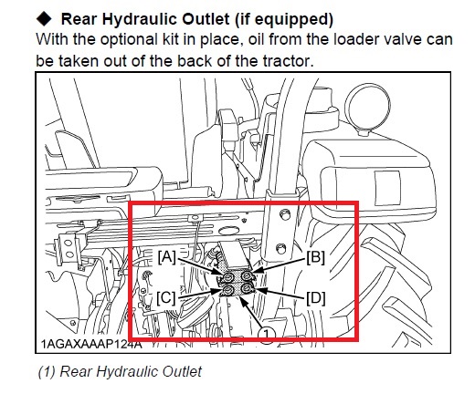

Does the rear of your L6060 have the rear ports labelled A, B, C & D?
The info on the attached pdf will become very important as we narrow in on what is going wrong.

I have these ports but they have never been used.
For some owners the backhoe hydraulic connection seems simple. Likely because, either at the factory or at the dealer, a power beyond loop exists to power the BH. This is why, when the BH is removed, there must be a loop of hose connecting the two rear BH ports back together thus maintaining the power beyond loop.
With the L6060, the owner does NOT have a power beyond loop at the rear of the tractor to connect into. He tried the third function but this did not work.
Both Lugbolt and Whitetiger have provided the proper solution which would see the tractor's power beyond loop extended to the rear of the L6060 by following the procedures in the BH92 installation manual for the connection of the hydraulic lines.
Alternatively, I think a pair of rear remotes will work if the the remote outlet's control lever is held into an operating position with a banjo strap. This is not an elegant solution but will allow the owner to see how well the L6060 works with his existing BH.
If the L6060 has more than one rear remote pair then care must be used in choosing the ones to use as one pair has a float function which will not provide power to the BH.
Remotes A & B from the illustration of the remotes in my earlier post will work.
If remote lever #1 is held forward then port A becomes the supply to the BH and port B becomes the return from the BH valve.
Dave
