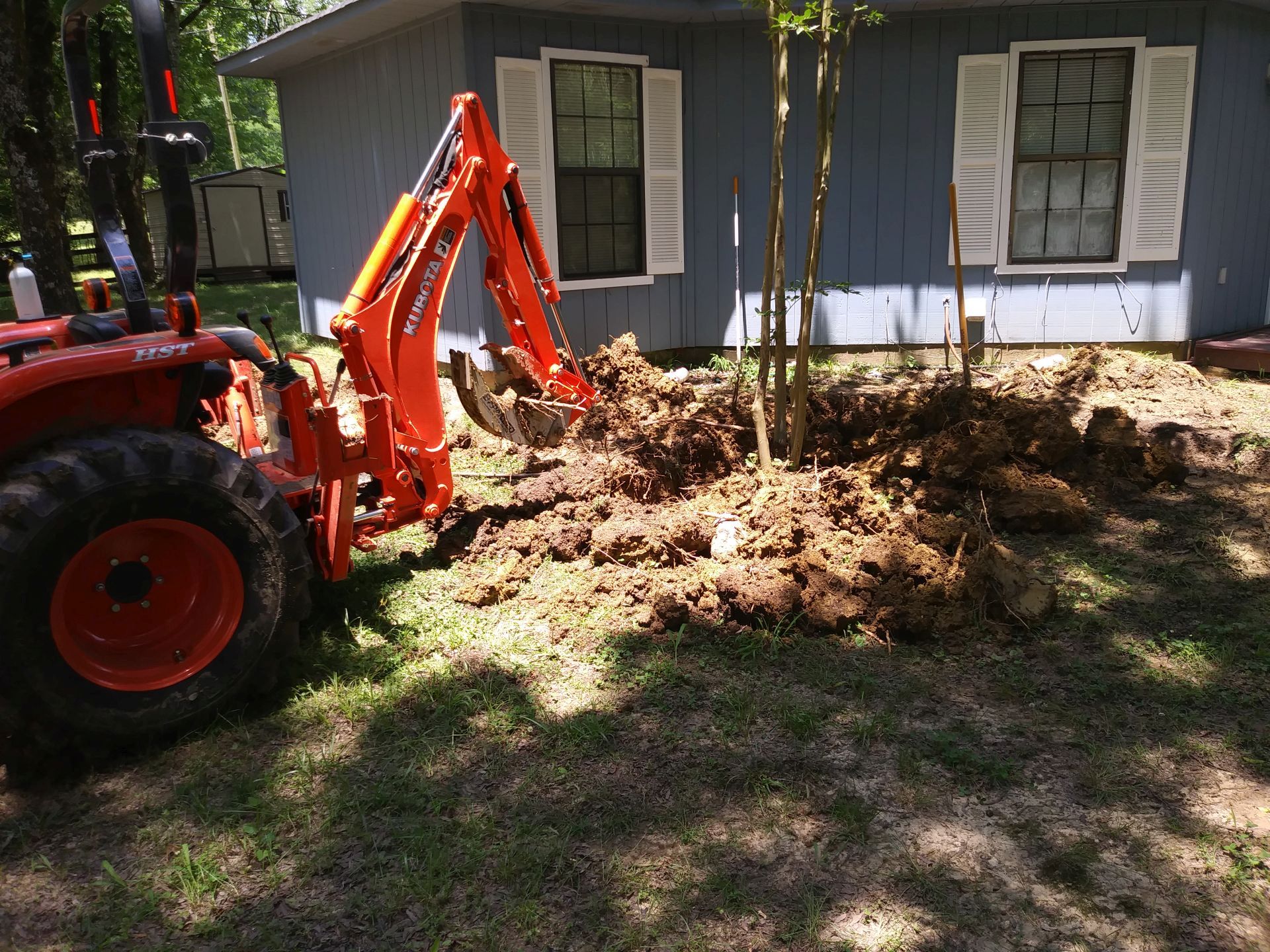

I just dug 150 feet of 4 foot deep trench using 16 inch bucket on bh77, l3301.
Including moving dirt from the trench into piles, it took all day (9-6 with a break in between). When you hit clay, it slows down and struggles a bit, but gets the job done.
I have 6 inch bxpanded bucket and don’t really like it honestly.
- Clay compacts inside and wont come out shaking bucket (got feeling this will be problem in 12 inch too)…not a problem with 16 inches
- For water lines, code calls for 12 inch plus pipe diameter trench (16 lets you run up to 4 inch pipe)…you can run electrical in 4 inch trench though
- If you got thumb, the trench bucket is too narrow so as you dig, the pins and thumb rub
- With 16 inch trench you can get inside and use shove to clean…cant in 4-6 inches
- If you hit rock, a tiny trench is too small to get it out
16 inches is about as small as I’d want and would prefer 24 inches. It’s an option, but I’m kinda doubting the backhoe would handle it well. Once I upgrade to L47, I’ll be going with 18 or 24 bucket.
