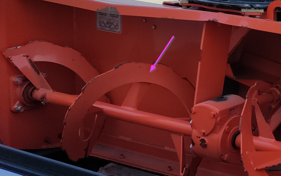

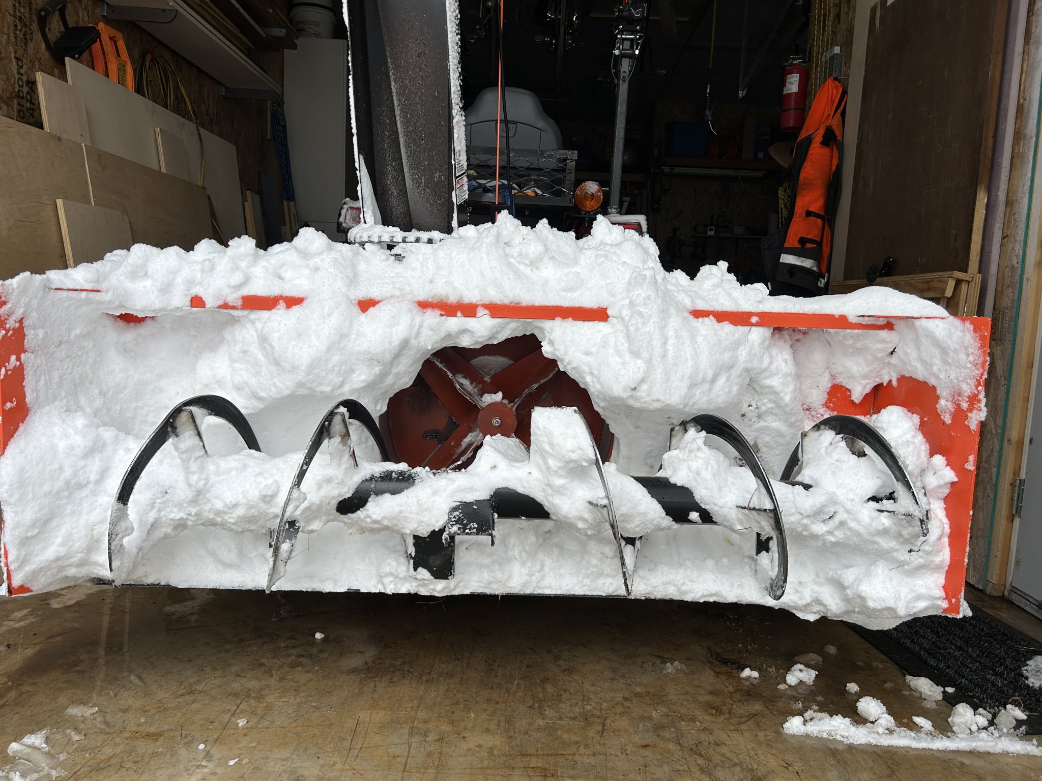

My 'toxic trait', as the kids like to say, is that I almost never buy a device without deciding some aspect of it could be better designed or engineered. Today, it's my LandPride SP1064 snow blower.
With a wet snow like we had this week, it never clogged in the second stage or the chute but it really packs up in the housing and builds up on the auger shaft. The result is it acts as half blower, half plow. On my first clearing yesterday, about 16" deep, I had to raise the blower a couple inches off the ground for the first pass because the wet bottom layer would fully pack up and let very little snow get to the second stage fan. Today with about a foot, but a drier bottom layer, it did better but you can still see how the blower looks at the end of the job.

I've had mixed results with Fluid Film in my SB1051 (little brother to your blower). Its good for about one snow blowing session, then have to reapply. This year we've had almost no snow, so just ran it as it was, same as what you're showing, packed main area, and with really wet snow, the chute also packs up. Worst case, I pull it back in the heated garage, let it sit for a bit and thaw out, then go again, but I may have a smaller drive that you. Maybe try the Fluid Film?

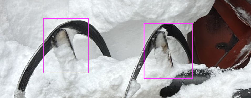

I wonder if your augers are reversed side to side. I'm used to seeing the smooth side of the augers facing towards the center so the snow doesn't get hung up on the bracing as the snow is being pushed inwards.

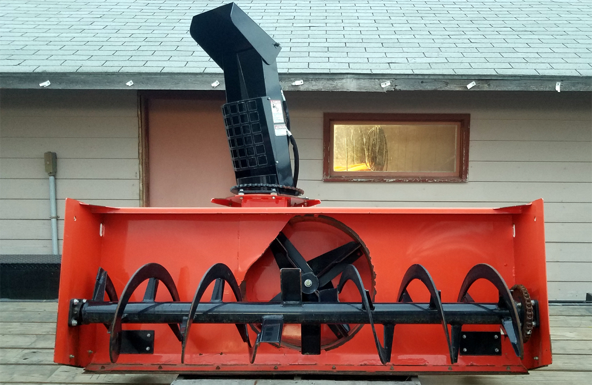

Compare that to my blower-

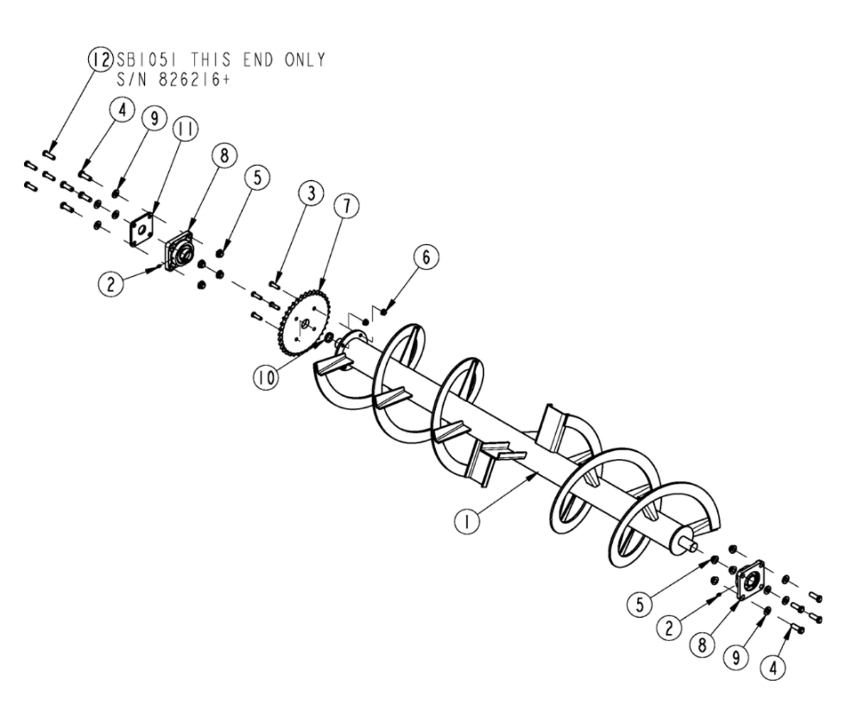

That's an interesting observation and you would think that the angle supports would not be on the side of the screw that's pushing the snow towards the center. However, the parts manual shows a one-piece auger that's arranged the same as the op's blower.
My auger arrangement puts the supporting steel on the back face of the screw, which seems intuitive.
I like this analysis. I don't know the age of my blower, but maybe LP learned something and revised the design to put the supports behind the screw helix.
