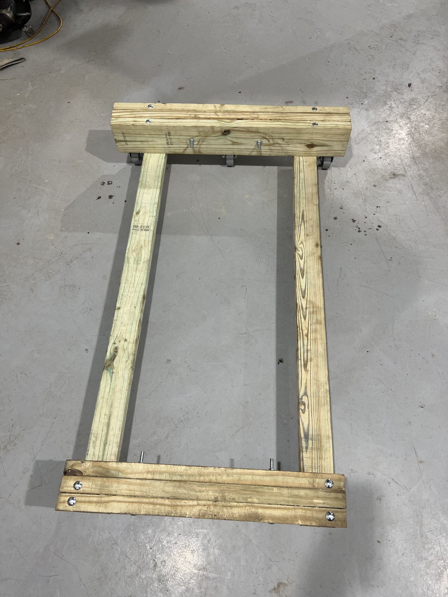

Got my dolly finished today. Well, almost finished. I want to add one more caster to the short section where the bucket goes. I’m hoping to try it out tomorrow. I was going to try it today but one of the grim joints on my left backhoe joystick somehow came undone. I have to fix that so I can extend the backhoe arm.

I need to shave about 1/4” off the wider end that goes under the stabilizers. I tried useing a hand plane/rasp but didn’t get very far. Can I use and electric hand held planer to cut across the three 2x6 bolted together?
???? Sure, you could. But a sawzall would be lots faster. ;)
and a chainsaw faster than the sawzall
honestly, I see guys make these things but have to wonder how careful they have to be when setting the bucket down on the one end. You have to put down pressure on the boom/bucket in order to lift the rear of the tractor slightly in order to get the pins out. If that down pressure is just past the wheels, it will lift up on the front of your cradle.
you will probably be better off using a belt sander than a planer if you’re going across the edges.
use rough sanding belts at first and it will go pretty fast.
you can probably rent the belt sander if you don’t own one

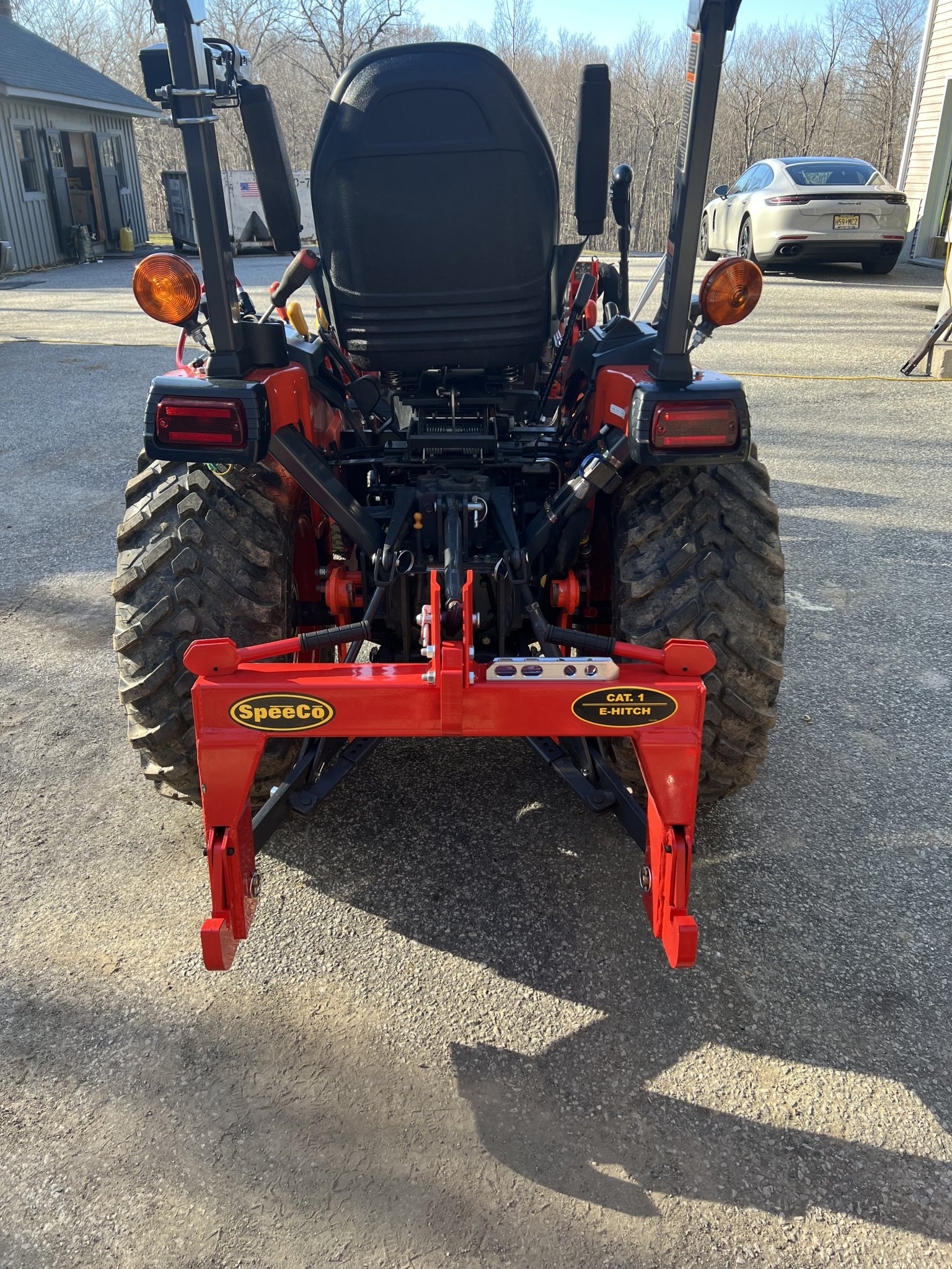

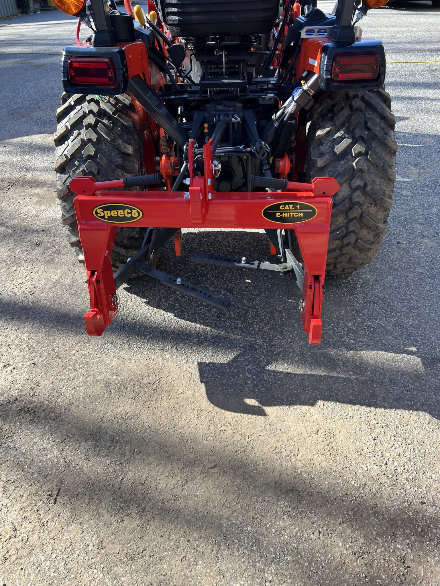

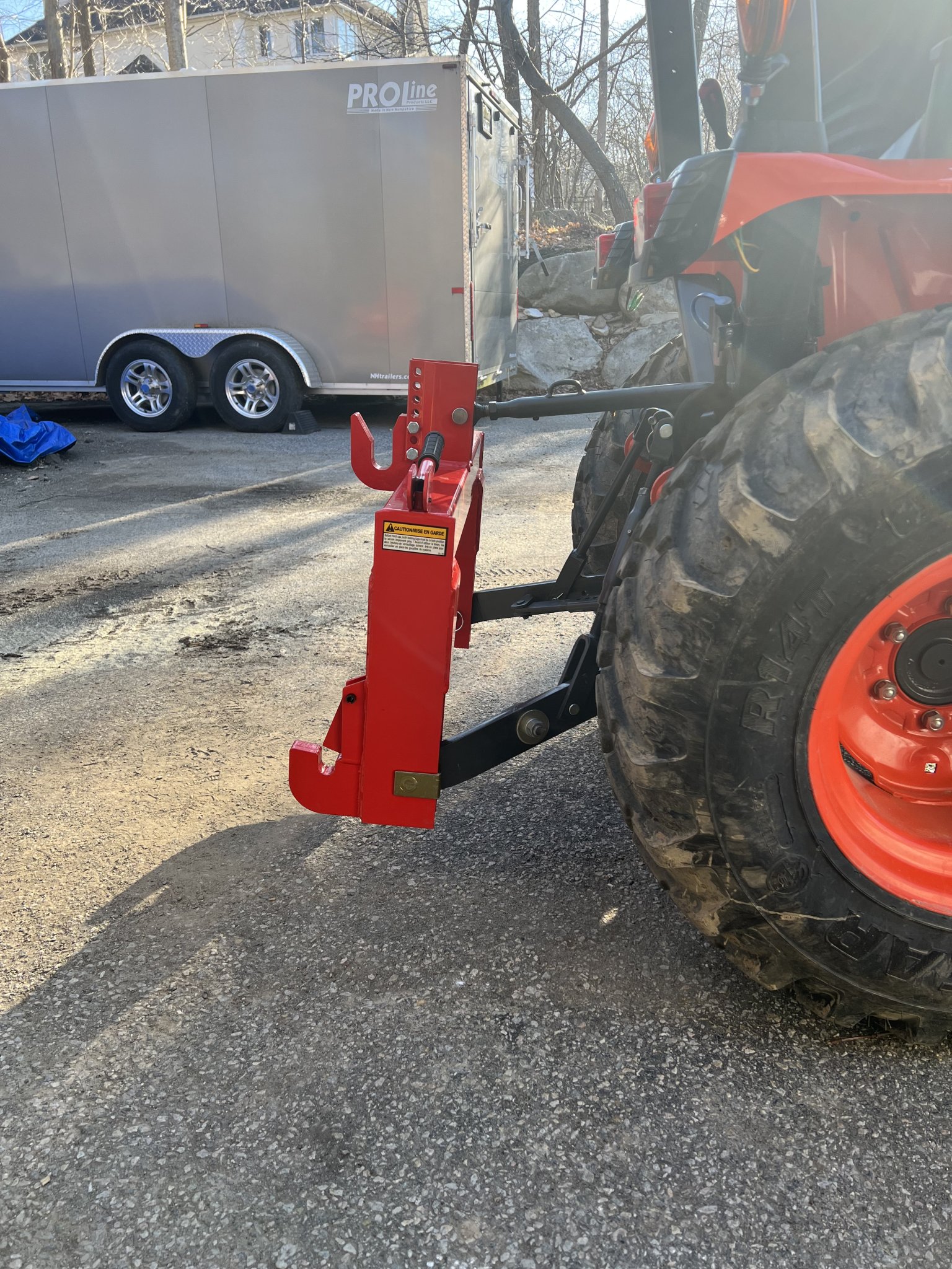

So I got my backhoe off for the first time today and tried to put in my Kubota 3-point hitch and the attach the Speeco Quick Hitch. I cannot get the quick hitch centered. I’m clearly doing something wrong. I had to turn the bar on the right to get the hitch level with the left side, but now it pushes to the left.

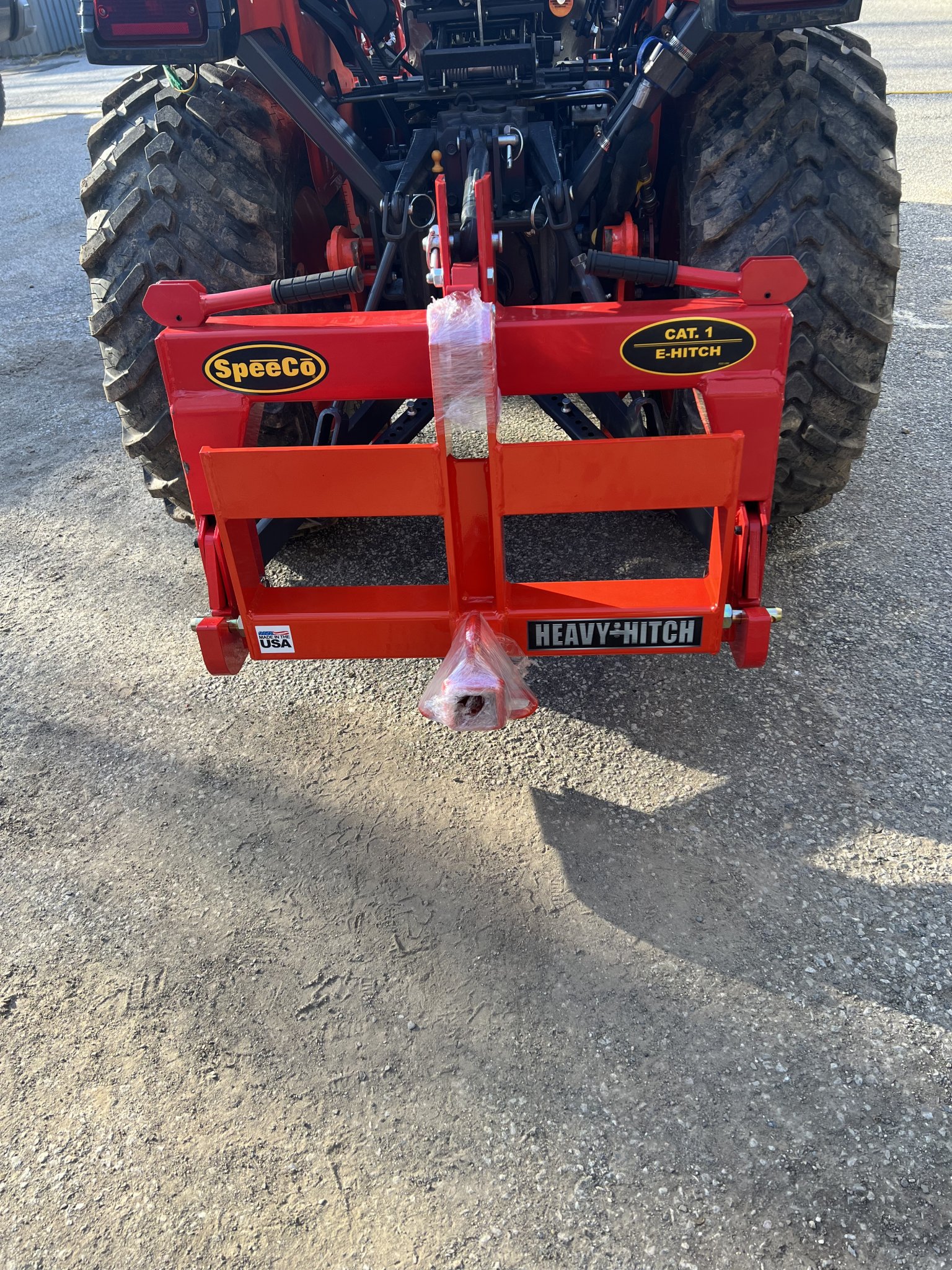

Ok. I realized a couple of things. Fist the ball joints were painted in place and didn’t move freely. I also attached the small arm on bottom. Looks centered now. As far as moving the top of the hitch to be level, should I use the small pins on the two bottom rails or turn the top rod to level it out?

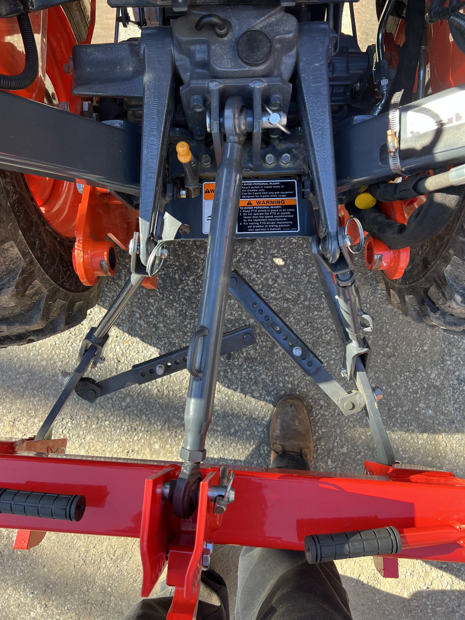

This shot show better how it’s not perpendicular to ground.

I also got a Heavy Hitch. Now I need some suitcase weights and also a top pin. Neither the QH or the HH came with a top pin.

In some of the pictures the vertical adjuster on the right side (looking towards front from the rear of tractor). looked like it was turned backwards. It looks correct in later posts. Just verify that you have it correctly installed now. It was the pictures from above that were obviously wrong to me.
this right side adjustment will tilt the implement so it is horizontal (parallel to the ground) or one side can be higher than the other.
the top link is also adjustable and will tilt the hitch to vertical (from the side of tractor) or tilt it forward and backwards from vertical.

I’m not sure. How do I tell?
You just need to extend the top link to make the quick hitch perpendicular (vertically level, plumb)
You are correct. I had it twisted the wrong way. Thanks for the info on using the tilts.

Use 'rustcheck' or similar on the all the ball joints and pins, Remove toplink, disassemble and apply neversieze, then screw it back in. Anything that's supposed to move or be adjusted, oil/lube it NOW before you go play. Sure, remove the excess but be sure they are lubed ! If water gets in, rust forms and can WELD things together really,really good. Yes, takes awhile but inevitable.....
