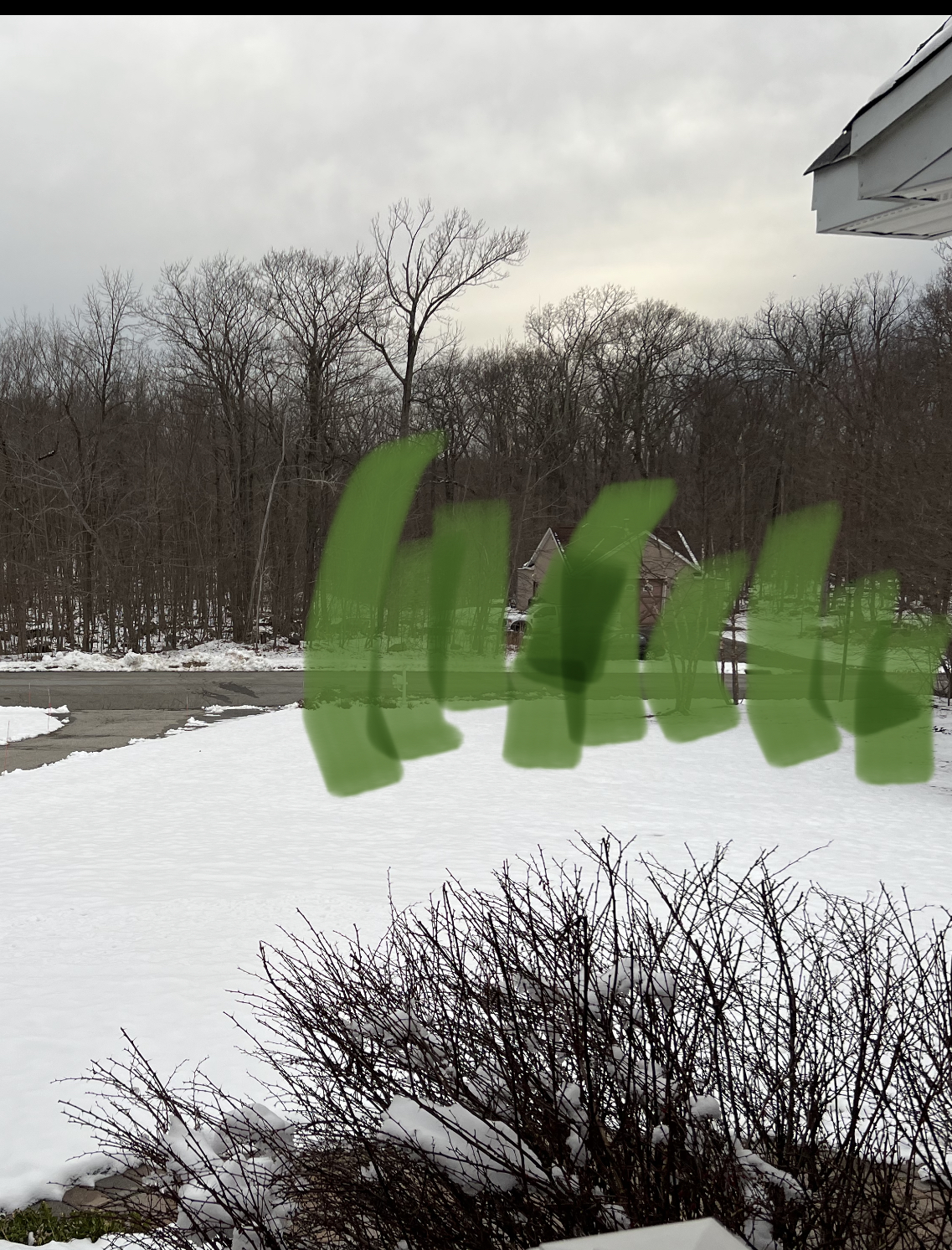

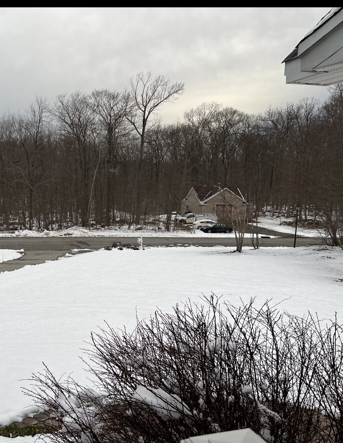

Another question about planting trees. This time in front yard. Similar to what we want to do for privacy from the back yard, we were also talking about having a screen of trees 🌲 on one side of the front yard. When you sit on my front porch, you see my neighbor’s off to the right.
Well, there are two options for you as I see it.
Options:
1) You could install a bunch of trees near the road as depicted in your picture. It would take a bit of time for them to fill in. However, I will say that your eye will seem to stop at the new tree line and you won't notice the neighbor as much. If it's really wet, that would limit you to certain varieties of trees, or you'd need to correct the situation or modify the area by raising (mounding) it.
2) You simply plant a single tree where that barberry is located off of your porch. Something like a nice Blue spruce. Slower to grow, but a real beauty. Best part is that it will only take one tree to take care of your issue. Barberries suck anyway.
If you chose the first option, keep in mind that you'd need to back them off the road a bit so you can see when pulling out and to also keep the road salt from plows off of them.
My vote would be option 2...and I've planted hundreds of "landscaping" trees for the very same purpose. The nay-sayers will tell you that the tree planted next to your porch will get too big. I say, so what? When it does, you just replace it.

Question about the line of trees at bottom. Nobody ever drives up that street (we’re at the very back of the development) except the mailman (and me). But we probably get the most snow (in NJ) because we’re not too far away from High Point, and they do love to salt the roads. Is there anyway to protect trees/shrubs from the salt, like maybe putting up a fabric landscape fence in the winter?

snow fence would help. but be sure to check on set back requirements with your twp before you plant those trees. They often "own" much further into your yard than what you may think.

Personally in the front yard I would go for a more natural /random spacing that a wall of trees, but it will work. The mistake many make is planting the trees too close together. Verify full size canopy diameter and plant based on that. You can also stagger them to compensate for the gaps between each When They are mid growth. Get trees that grow faster or you will be dead before they are large enough to cover the area.

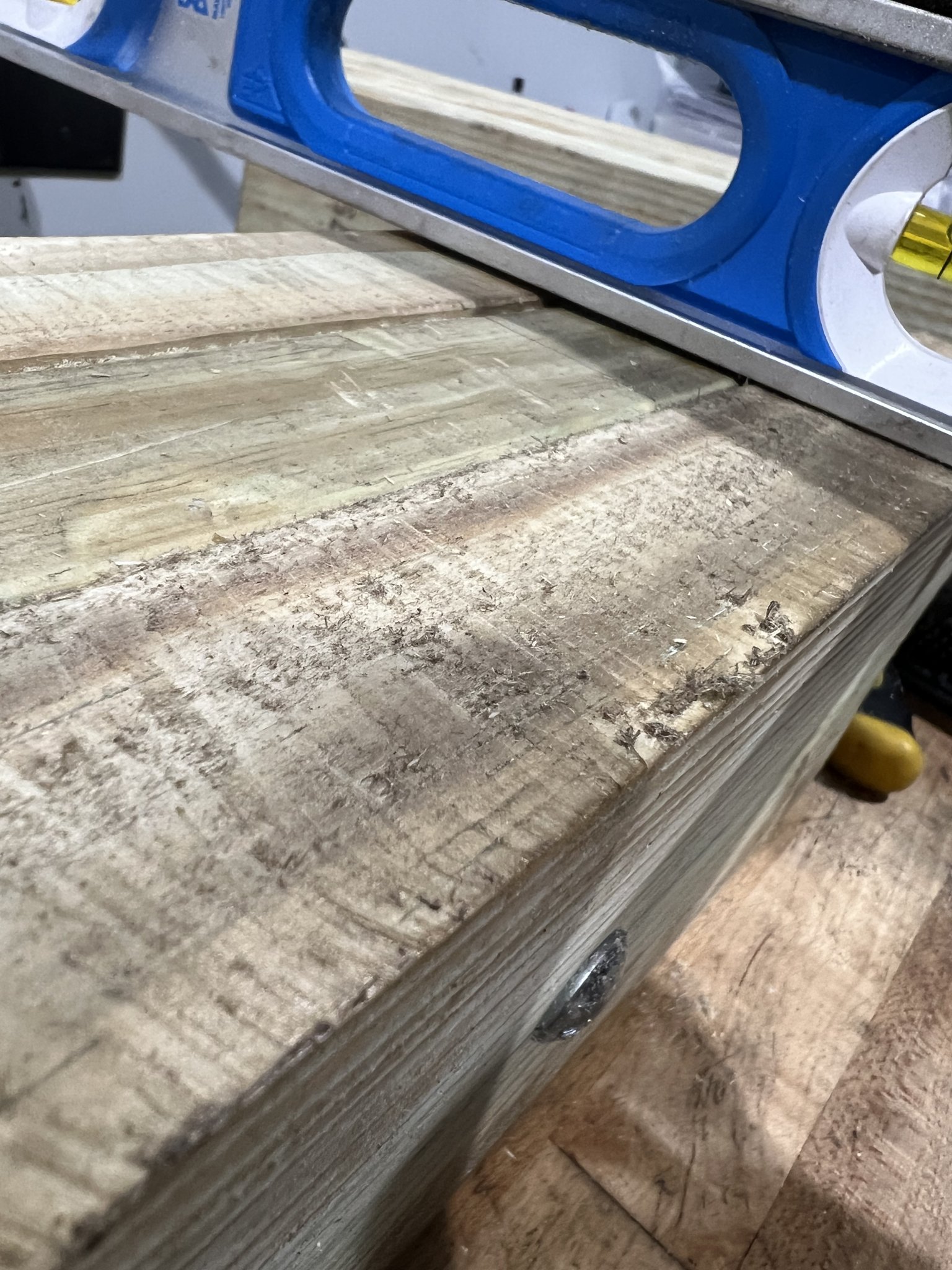

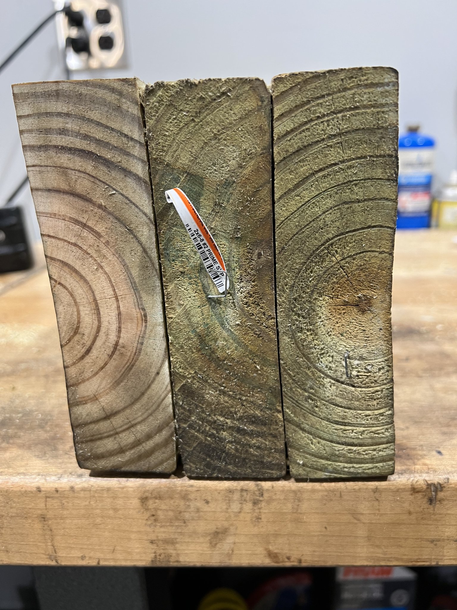

I worked some more on that dolly today. I should start out by saying I know nothing about working with wood. I noticed that when I bolted the three 2x6 together, they didn’t come out very flat. I used a cheap Harbor Freight plane to try and make a level surface across the theee joined pieces of wood. My question is that is this the type of situation where you would typically use a belt sander or an electric hand-held planer? Here are some pics to show before and after with cheap HF planer.

Forgot the after shot
This shows my bad woodworking that I’m trying to fix. I realize this is just a dolly for a backhoe but I’m using it as an opportunity to try and learn.

Racer -
I don’t know the backhoe dolly plan you’re working from.
Only guessing that your backhoe could care less if your laminated 4.5x4.5 is off 1/8” in its profile when you build your dolly.
Especially pressure treated lumber is off a little in many aspects imho. Often hard to find straight ones.

Its all about crowns and cups. Your backhoe wont care though.

fwiw....
the right 2by6 in post #75, should have gone the other way.....
if you'd screwed 2 together ,then the 3rd, they'd be square and level PROVIDING they were all milled at the same time.....

Is that because of the grain or because of the way it is bowed?
good tip on bolting the multiple 2x6 together. I’ll remember that for next time.
