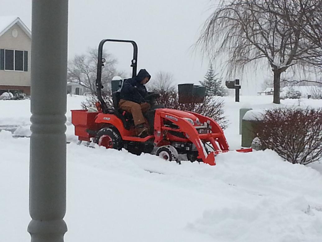

dwk121
BX1870 fel,54" MMM, ballast box. 3ph triball trailer hitch.
Jul 4, 2013
81
United States Falling Waters WV
My BX1870 has turf tires.The rear tires are filled and I use 350lbs Of bagged sand in the ballast box. We had 12 to 14" snows this past winter and my driveway is asphalt up hill. No problems in 4wd wet or dry snow. As stated more rubber on the ground. My last tractor had Ag tires and would only get me half way up the drive before stopping. I am very impressed with the turf tires.
