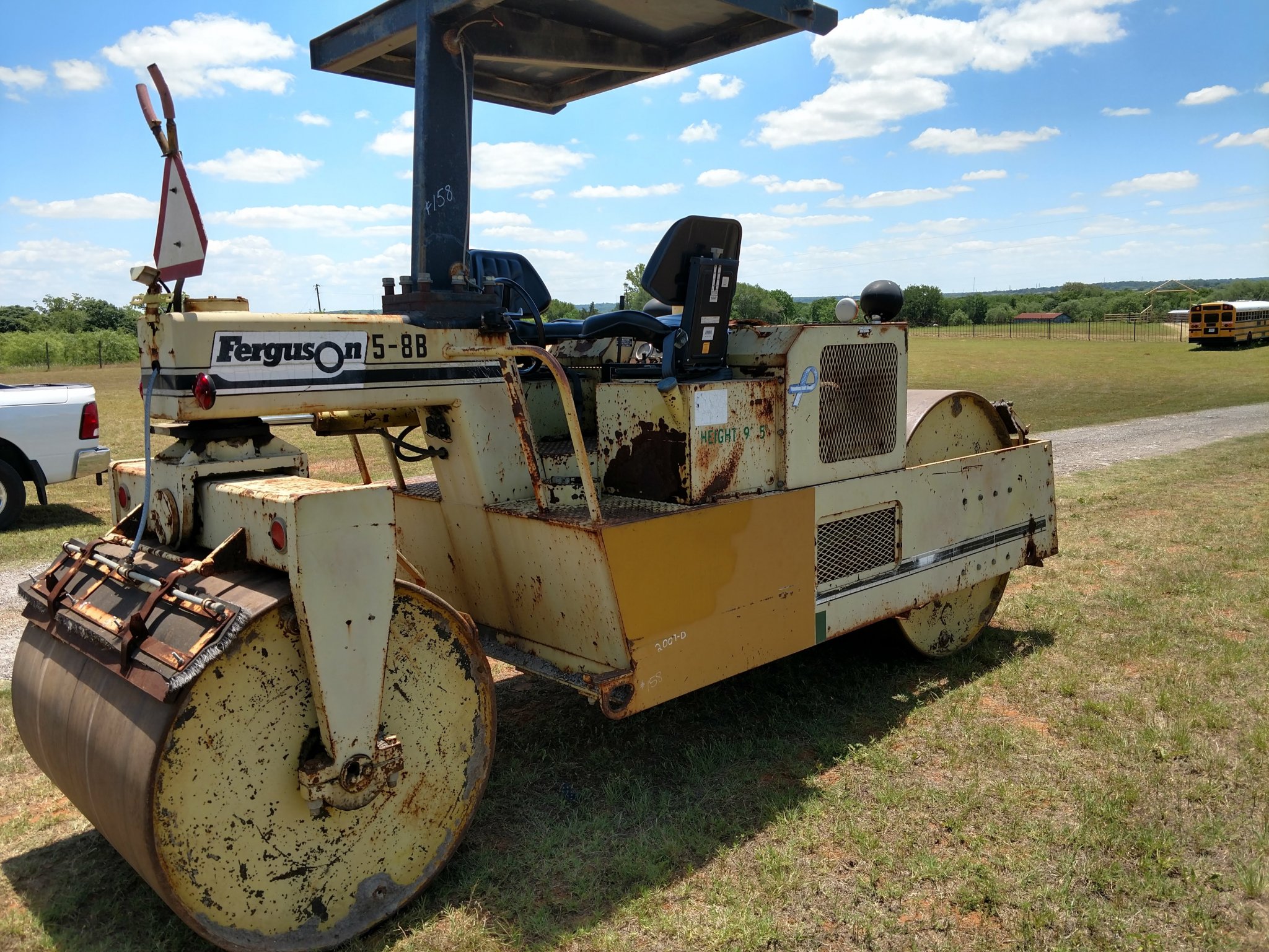

Ruts from Trucks are nothing compared to the hog damage on my 10 acre turf aircraft runwayI repaired with this Ferguson Compactor Roller when I found the damage so bad my little 9N Ford couldn’t even drive over it. No kidding!
I tried discing it...didn’t work. Tried tilling it. Didn’t work. Waited until it rained and ran this over it a couple times.... Yep! This did it! For 57-cents per lb. (14K lbs) Fun to drive.
(FUnny story about this... My 16 year old grandson was sitting in the seat absolutely spell-bound as I taught him how the Hydrostatic-drive works. He’s got a girlfriend at school and about to get his driver’s license, so I looked him in the eye and in my most-solemn voice said to him:
”Chase... now listen up, son! If you work hard and make Good Grades this year in school....(at this point he’s looking intently into my eyes...expecting some great-reward from his Pop-Pop...)..... I’ll let you TAKE THIS OUT ON DATES!”
YOU SHOULD have SEEN HIS FACE! 😂😅🤣😅😆
