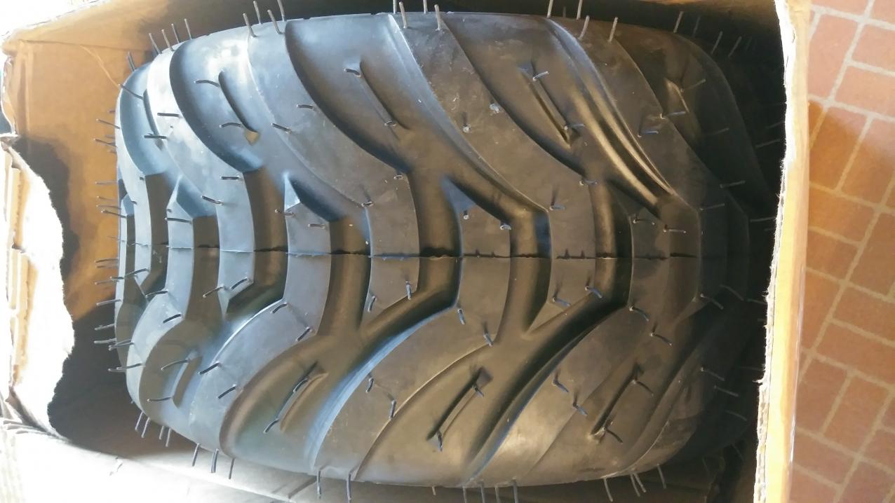

I just got in the ones I ordered - here is a picture of what they look like, seems like a well designed tire.
And for a reference - ALL those tires on the front end of the BX series scut are 4 ply......which is sad! These are 4 ply also, but I hope that the bead will seal and that little bit of air will stay in them!
Ordered these - $89 bucks for TWO shipped! SO if by chance they dont do what I wish, then I will back up ten and punt!:p
Bottom line - the tires on the front end from Kubota are sad excuses for tires (R4) - other than the HST fan - it is the weakest part on the tractor IMO.

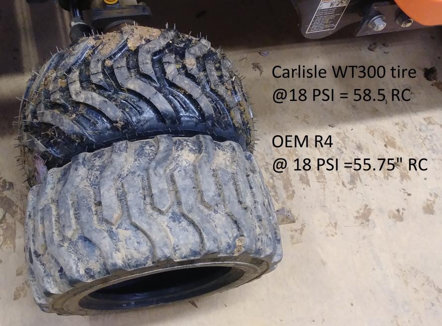

Well....
ordered Carlisle WT300 tires from summit racing.......$89.00 shipped to my door for both - $10 to place on rim......
Total $100
here are the side by side with RC's
time will tell ifn they work well:D
thanks NoBiffBetter for the heads up;)

Very subtle differences....I wonder how much difference it really makes? Please continue to provide feedback as you evaluate them in the field. Sure seems like a viable replacement tire. Thanks for sharing!

Is that difference in RC acceptable (on a 4x4)?
I am wondering the same thing ....doing the math.....the OEM is 95.3% of the new tire, or another way of looking at it is that the new tire is 4.9% larger than the old one.....
if I release some air ....like to 15 or 14 psi, I will check that RC.
Largest difference is that the newer tire does NOT have those edges like the OEM - all the grip is centered, almost like an AG based tire, I went out in the very soft yard and cut donuts and had very little rip up on the front end.
If they just hold air ....I'll be impressed! ;)
