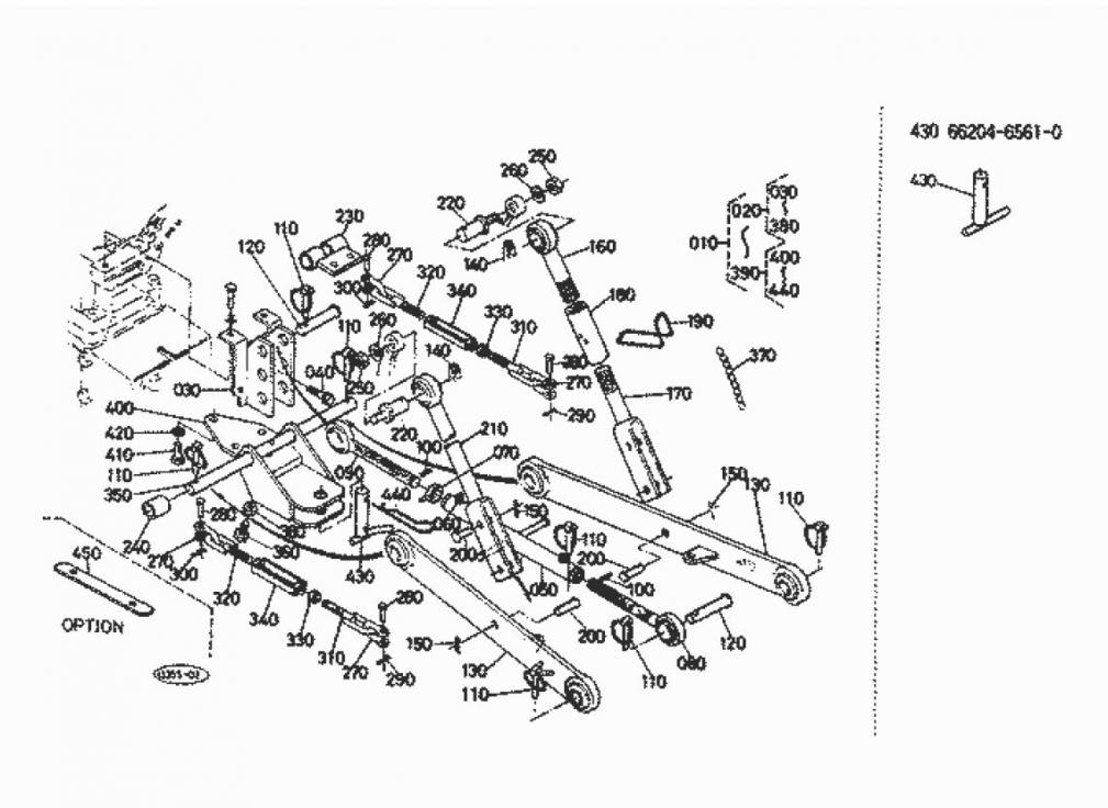

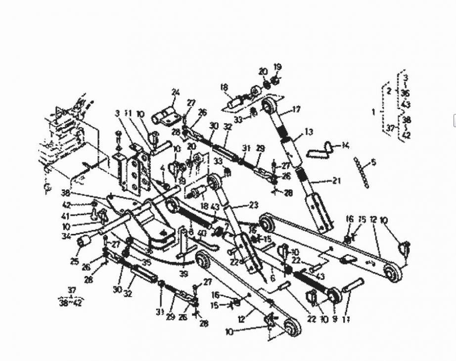

If it's a typical B7100, the rod is (should be) held in place by a bolt & locknut on through under side of the trailer hitch- the bolt sits in a dimple in the rod. The fact that yours turns means that the bolt is either not tight or missing, which is common, they work loose & fall out.
The original rod in mine was not hard, and when I modified my 3pt setup, I made a longer rod from a surplus hydraulic ram- not hard either. It has never bent, so my guess would be it does not have to be hard. Back in olden times as an apprentice Toolmaker, I spent a good part of two years straightening things such as this, and I would cold bend it in a hydraulic press (10 ton minimum) with v-blocks & dial indicators. I would guess it could be straightened within .005 TIR, if someone wanted to take the time. (it probably wasn't that good new:D)
Here's a drawing of the hitch with clamp bolt.
