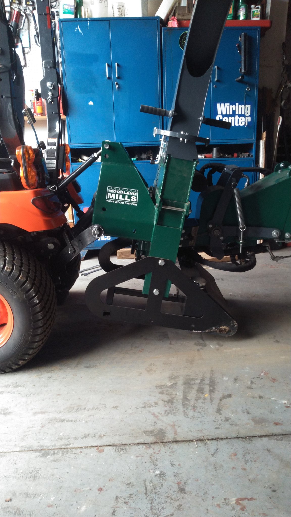

Beginner 3 point hitch question

You need a shorter top link.

Does the BX have multiple holes to stick the top link in on the tractor side? Put it in the lowest hole (still May need shorter link like Army says though)

What the hell am I doing wrong???
Thank you.
I agree with Army Lifer and FordTech 86. The top link is too long for the implement. I wonder about the PTO to implement drive shaft. It look like it is sitting at a pretty sharp angle. Kind of hard to tell from the photo, but I would give that a check after you get the top link squared away.
Good luck with it, and let us know how you make out with the problem.

Thanks guys.
Broke the DS shear pin so will be resetting the whole thing now.
(NON technical terms): Tightening the turnbuckles attached to the lower arms helped too.
The chipper does in fact have a lower slot for the top link, will try that too.
Thanks again.

From the picture it looks like you may still have some adjustment left in the top-link. It would be a cheap fix if you could get another few inches shorter by screwing it down to the shortest length possible. You may have already tried that?
Doesn't look like and insurmountable problem. Since it is a chipper and going to sit on the ground when in use. Can you just use a chain or strap, instead of the top link, to carry it around to your work area and set it down? I've never seen one of those in person. So just throwing out an idea.
3,020
4,767

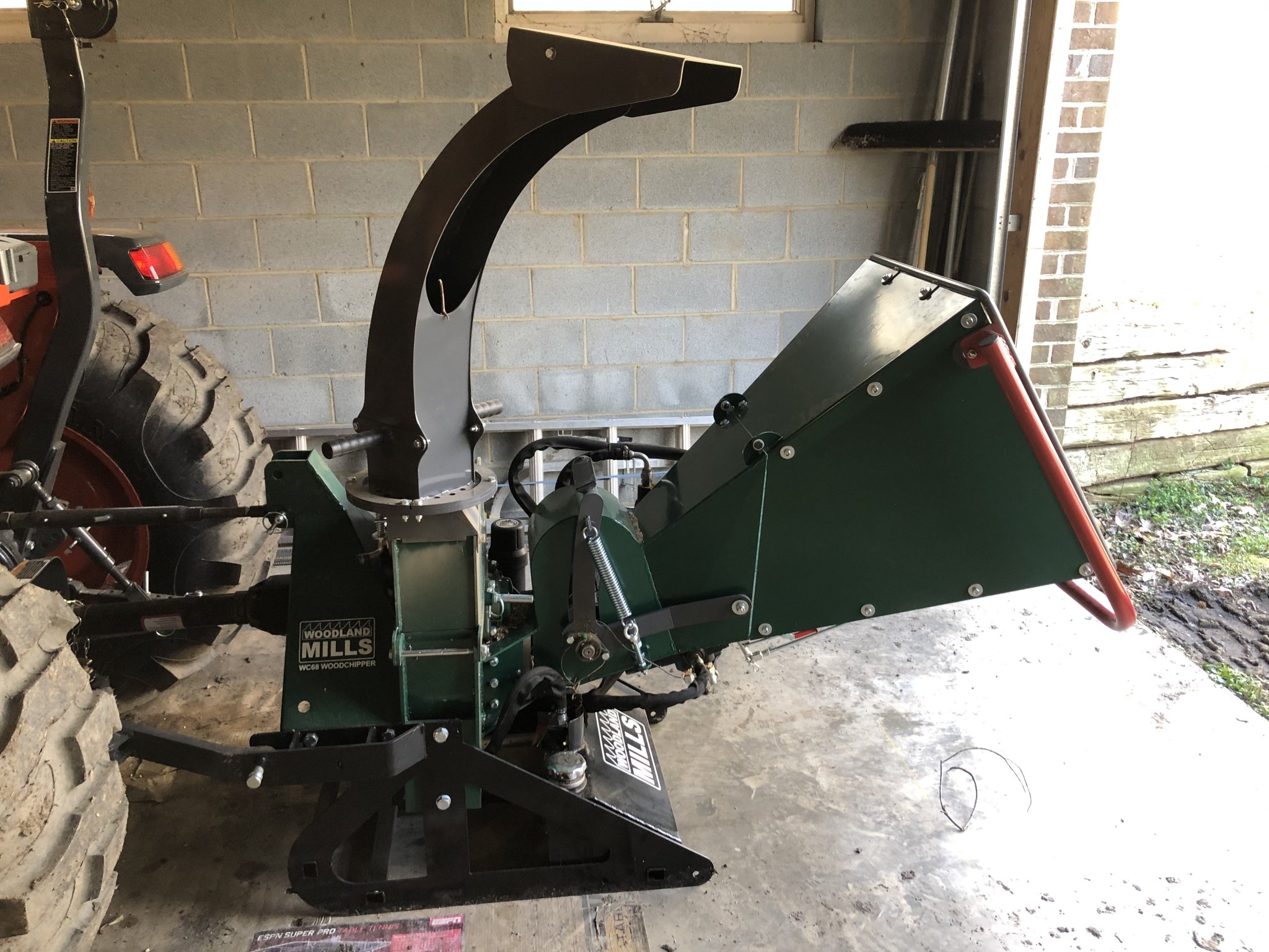

It should look like this when it’s sitting on the ground. The PTO shaft should be close to level. The U joints on the PTO shaft aren’t going to be happy with those crazy angles, particularly with the heavy tilt of the chipper making the angle at the chipper and tractor unequal. The shaft doesn’t have to be dead straight but the implement needs to be level so the angles at both ends are the same. If they’re not the same it creates internal stress in the shaft as it rotates and yes I can explain that if you want but you can look up the physics of U joints and probably get a clearer explanation. So yeah, you can’t really run it like that.
From looking at your pic your toplink is exactly way the hell too long and if you wind it all the way in you might get it to just way too long but it still won’t be right. I’m truly impressed you even got it hooked up being that far off.
Suggest disconnecting the toplink. Lower the hitch so the chipper is sitting flat on the floor. Measure between the center of one of the toplink holes on the tractor and one of the toplink holes on the chipper. Whatever that distance is, you need a toplink that has that distance within its range of adjustment.
As previously suggested, I suppose you could rig up a chain to substitute for the toplink as it’s really only needed for transport but I suspect based on the length of your toplink v the link of your lift arms this isn’t the only implement your going to have problems with so I’d be looking for a shorter toplink.

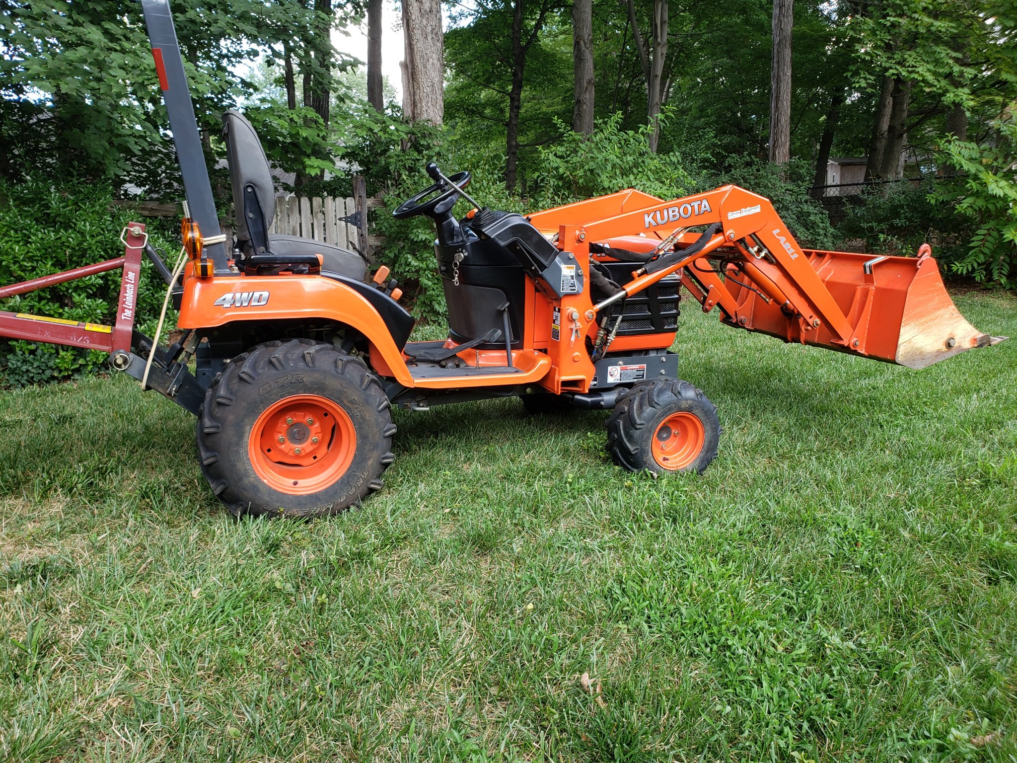

Here is a 3 pt implement on my little BX. I think it is the same top link as on yours but you may notice the top link is shortened as far as it will go and that is just enough to get the implement level. Yours "should" work the same. but try to get the PTO shaft as straight as possible, as others have noted.
You have probably also discovered there is only one attachment point for the top link on a BX.
