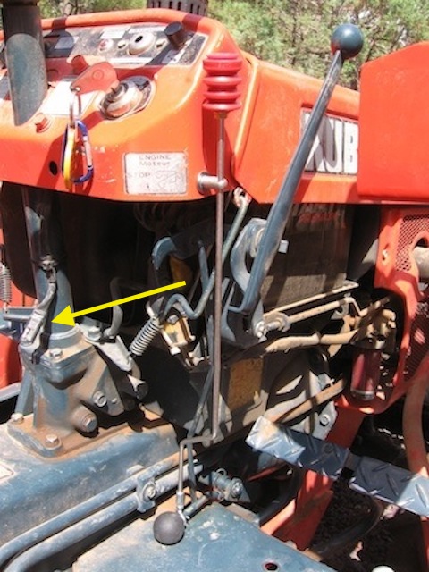

Probably depends on your time between uses and the weather it lives in. I'm in Arizona, arguably the hardest climate for batteries on the planet. And I sometimes have to go 2 months without starting some of my vehicles due to family obligations.
In my situation, I know for a fact I'm gaining battery life & reliability.
Found a pic of the tender connector on the tractor:
