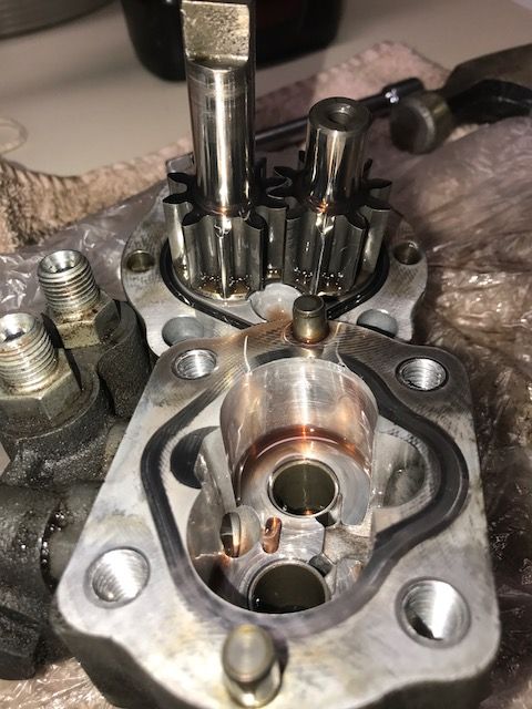

Wolfman - thanks for the reply. There's a snap ring on the far end of the governor shaft where the tabs broke off that hold the shaft in place. It got broken along with the tabs which allowed the shaft to slide back and forth in the housing. When the fly weights would move the thrust washer it would just slide the shaft instead of moving the governor arm linkage therefore allowing the engine to rev up to full throttle.
I pulled the hydraulic pump off and pulled it apart - it spun freely and had no debris of any kind inside. I looks really clean in there which leads me to believe something dead headed causing it to lock up and the unfortunate chain reaction.
As it is I will still have to get a new pump because the outside seal got chewed up by the broken tabs from the governor shaft tumbling around in there between the pump face and the roller bearing.
Next step is to try to figure out what may have dead headed. That pump only supplies high pressure to the steering ram and the lift ram inside the transmission case. Man this is getting deep......
Any more input would be greatly appreciated
