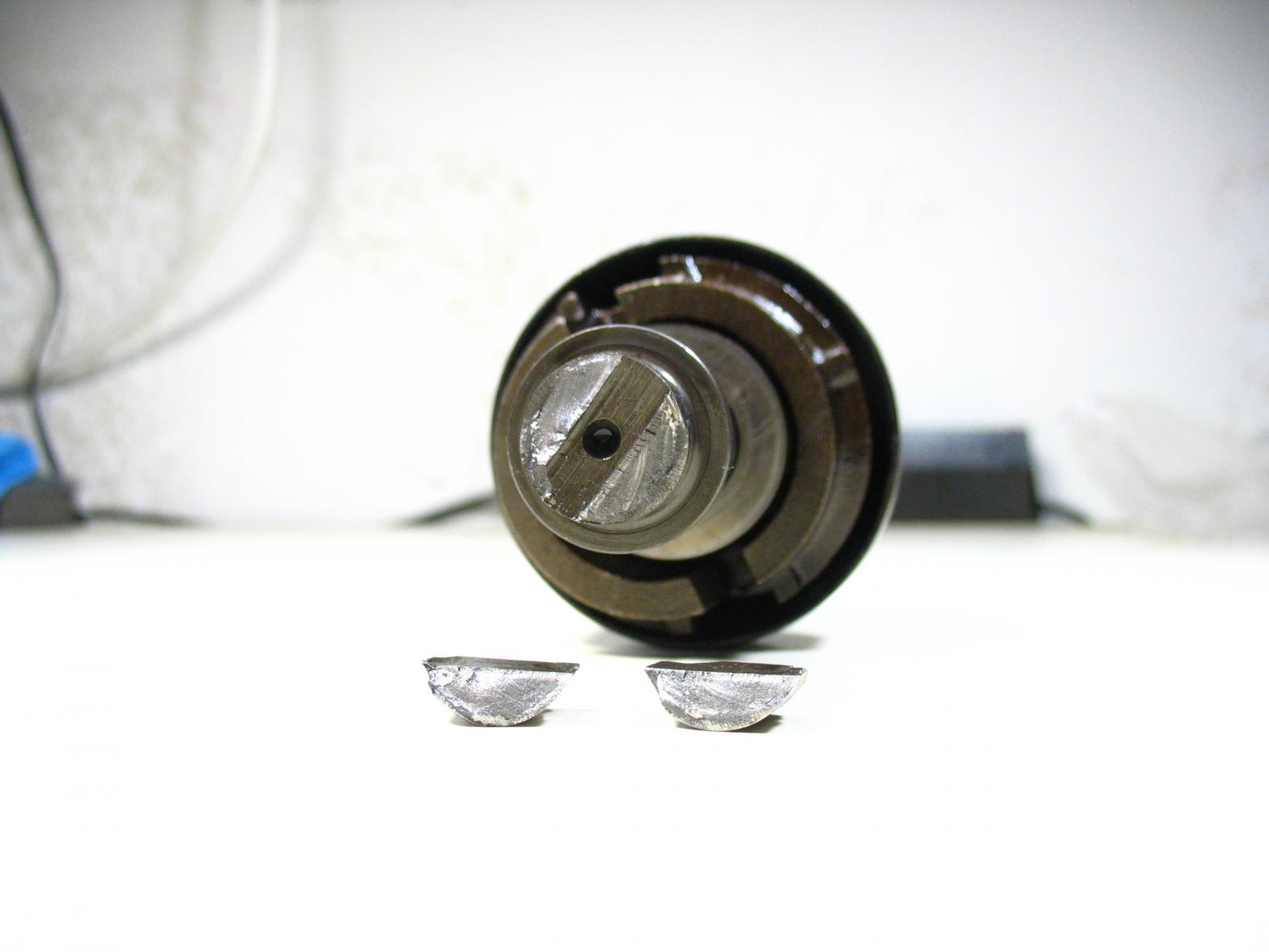

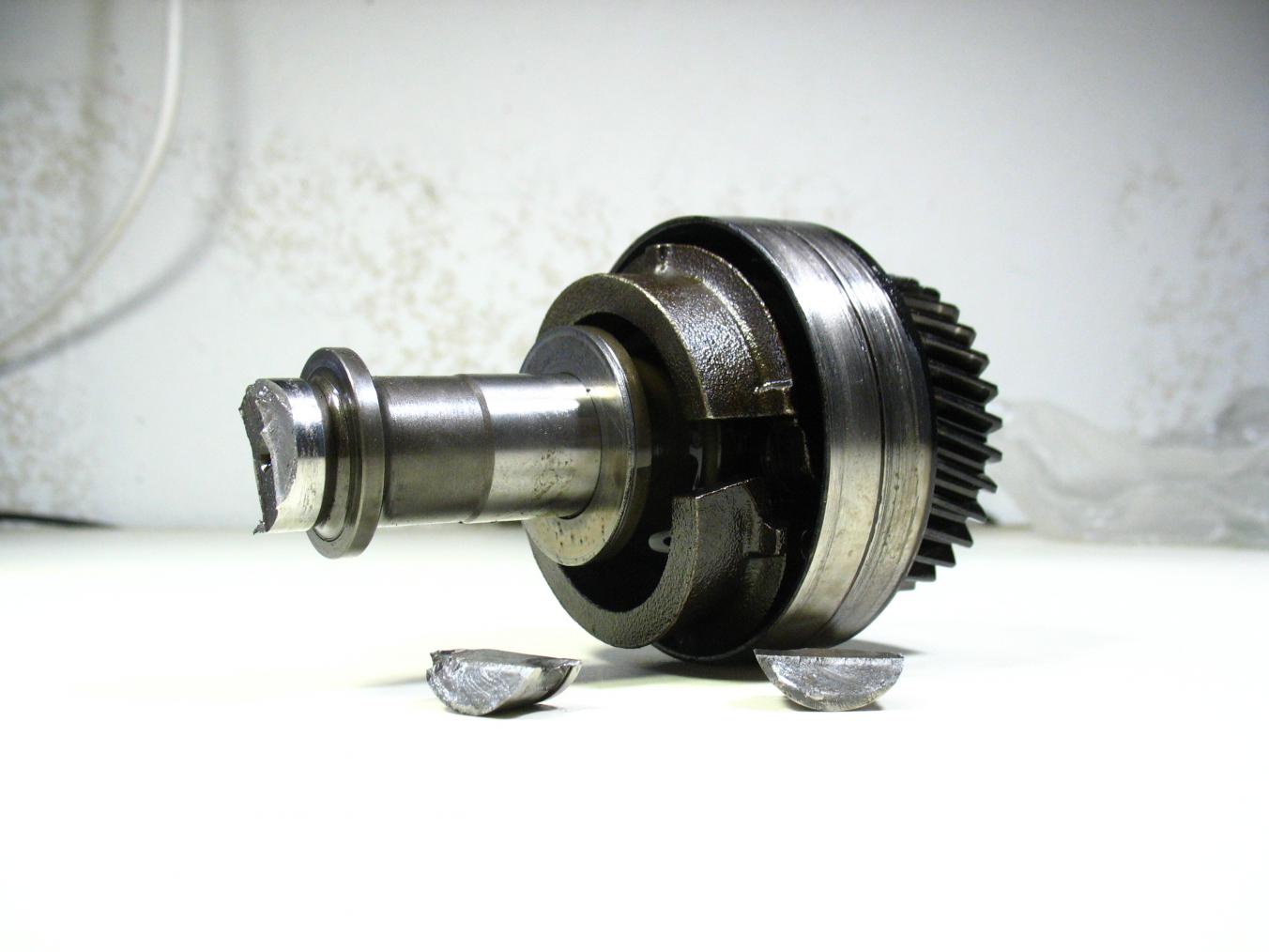

So here's an update for anyone that is interested;
I pulled the front cover off the engine and removed the governor shaft and just as I suspected it was broken - the 2 fingers on the end of it had been sheared off and the thing was flopping around a bit in its housing. There is a roller bearing in the back where the fingers are and up at the front is a solid bearing / babbitt setup where the gear is. The babbitt has been beat up a bit and will need to be replaced along with the shaft but I believe the block is ok.
The fingers on the back of the shaft run the hydraulic pump on this particular Kubota mower.
Now the big question is what caused these fingers to get broken in the first place? I thought I'd try spinning the hydraulic pump itself before putting anything back together to see what happened. I put my cordless drill to it which spins at about 600rpm. At first it spins up full speed no problem but after a few seconds it starts to build pressure and slow down to a crawl. I switched the drill to the low range setting to give it more torque and it essentially did the same thing - spins up full speed at first then slows down to a crawl. I dont have any experience with hydrostatics or hydraulics like this. Does this reaction from the pump sound normal or is this an indication of a problem that lead to the broken shaft?? If I have a pump or hydraulic problem here I want to fix it before firing up this engine again with a new shaft, etc.
Any wisdom would be greatly appreciated!
