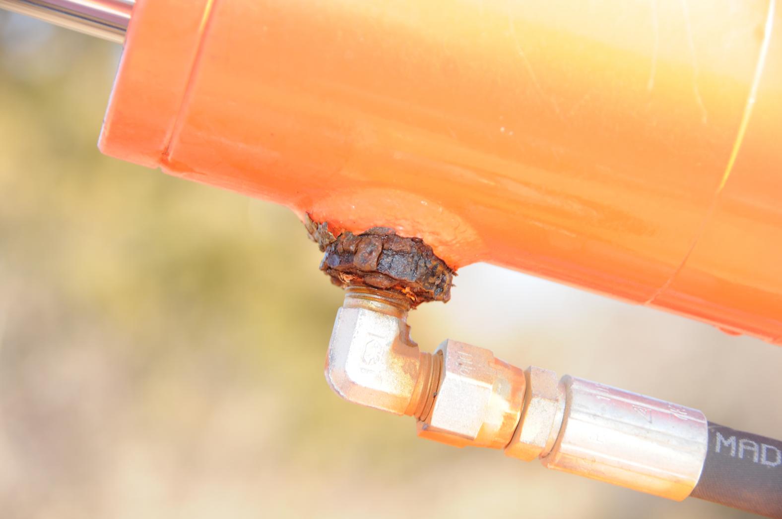

Hi all, I have a nearly new L 4701, my pride and joy.
I bought it with the Kubota backhoe with a hydraulic thumb.
In less than 2 years some of the fittings where the hydraulic lines thread into the pistons completely rusted to the point where the entire fitting was unrecognizable.
Interestingly fittings that were exactly the same adjacent looked almost brand new.
These are quite clearly "slag" metal fittings supplied either in error or by intent.
Kubota must be having this problem nationwide . They do not want to acknowledge they have an issue.
I hope that the company has the courage to get out front of this.

Bet it's Powder Coat! The film gets broken where the fitting threads in and corrosion starts. But the film strength is high enough that the corrosion continues rapidly without breaking through and it'll rust at an incredible rate because it stays contained under the PC film. So-so metal quality makes it even worse. Wouldn't wish powder coat on anybody. Haven't ever owned any powder coated steel item that didn't eventually rust terrible. B&S had some issues with certain body parts on Simplicity tractors in the early 2000's (Legacy driveshaft tunnels) prep wasn't washed off properly and the parts would almost dissolve under the powder coat finish. By the time it showed through it was too late, it was junk.

It's rusted under the paint on the cylinder side of the connection.
He put pics in the OP.

It is interesting to see all the theories.
I have never pressure washed this tractor. It is exposed part time to the air on the island bit as I said in my original post other fittings show no rust what so ever. I included a photo of both conditions. The rust is a complete breakdown of the fitting.
I have been a contractor for one year shy of 50 years. The only time I have seen anything like this is when lesser quality metal finds its way into a manufacturing process or system. It is not all fittings just some.
My dealer replaced all the hydraulic cylinders on the back hoe just in case.
They found one that they ordered had the same paint blistering around a brand new part and had to order another.
Kubota is not standing by the dealer but the dealer is standing by me.

Sure looks to me like a little bit of careful wire brushing and some Orange 2 Kubota paint would cure the issue.:D
Seems to me like a whole bunch of ado about nothing.

IDK. I’d be afraid to wire brush that, it looks ready to crumble.:eek:

If it was (crumble), it would rupture and leak, it's a pressure fitting. Just surface rust from poor prep, nothing more.

That is more than just surface rust in the first picture. Looks like a metallurgy issue that hopefully is isolated to just one fitting. Resembles the underside of what our vehicles look like from the salted winter roads here in Wisconsin.

Hi,
I uploaded another picture. It is a close up and shows quite clearly the complete failure of the fitting. The previous comment suggesting a "metallugurical" issue is spot on. I never expected this kind of issue from Kubota. They need to face this openly. I cannot have the only machine where this is happening. For those of you suggesting a simple fix this new photo says otherwise.
The dealer has replace the units-my deep appreciation to them but before that I was very concerned that what was left of the metal would, in fact, blow out.

Yooper - Coming from you, I think Dave has a point....my first thought was "so what," looks like upstate New York....
Does look like the fitting(s) are eroding badly, but not all of them....:confused:
Yooper - warranty or not, wouldn't you want to get those fittings out and replaced...while you still have something to get a hold of?
That fitting is not welded into the cylinder, is it?

Yes the part of the fitting that's bad is welded to the cylinder, so a cylinder replacement was the smartest answer.

Wow, that third pic is really telling.
What I suspect happened is that the maker of the cylinder (Kubota or a subcontractor) got a bad batch of the barstock used to make that weld-on bung.
(if it was a system wide material failure, everything on all cylinders, including the cylinders, would be in similar condition)
Having worked in aerospace my whole career, I'm quite familiar with disasters caused by suppliers substituting inferior materials. It usually happens when a supplier gets an order for (example) 100ft of certified XXX barstock, and they only have 85ft on hand- some knucklehead in the warehouse substitutes 15ft of non-certified YYY barstock to complete the order. Most manufacturers seldom test every piece of stock supplied, (kinda defeats the whole purpose of having certified, single source suppliers) so some crap makes it to the product.

Bill is right on! I'll guess that the welding pulled out something in that fitting(silicon, Bill?) that led to this happening. The dealer absolutely did the right thing and I'm glad it worked out for you, Dave. That right there is a loaded gun!
