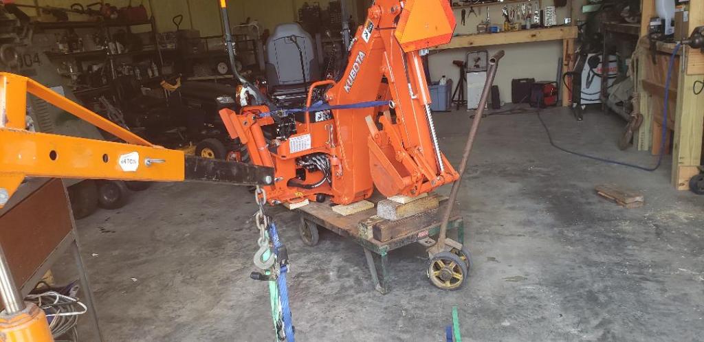

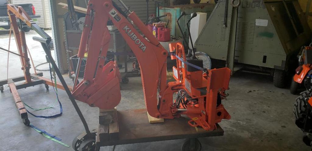

I was thinking about making one for my bx23s.. took some measurements and found it was about 4 feet long curled up then remembered I had one of my old carts from the Howard Hughes factory in van Nuys ca and it was a perfect fit... very stable.. just have to use my cherry picker to lift the bucket side up once detached from the tractor..
I have a thing for carts.. very handy when moving 400 to 1300 pound generators around

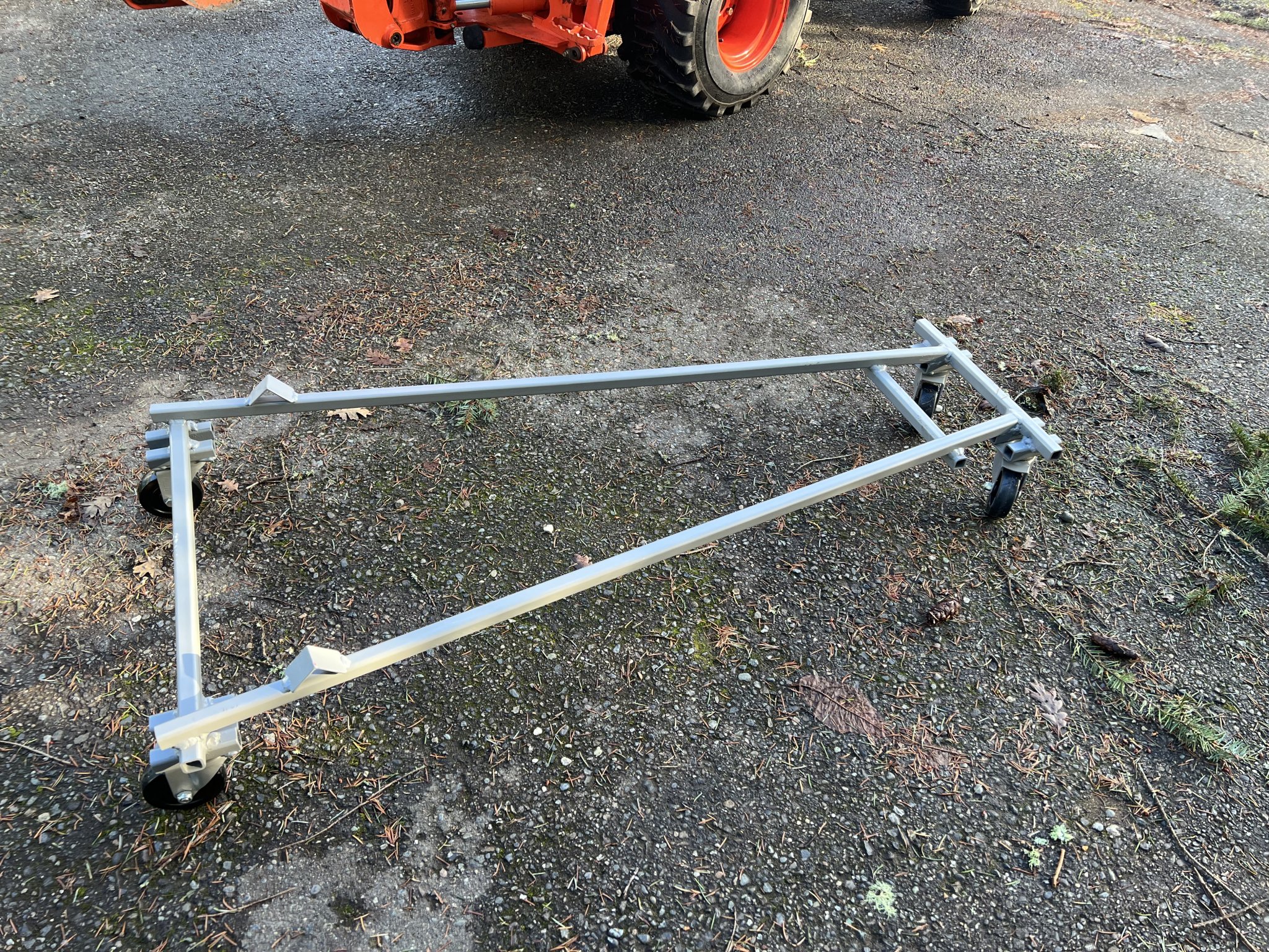

I got them today, now I just have to draw up a set of prints and scan them.
For those that want the piece list....
1 1/4 squre tubing.
54 1/4 x2
27 x1
11 x1
16 x1
1/8 thick 2 inch angle 1 inch long x2
1/8 thick pad 3 3/4 x 2 1/2 x4
Fixed castor that is 6 inch high x2
Swivel castor 6 inch high x2
The pads match the castor. If you use different castors, make the pads to match. Critical part is that castor is 6 inch high, not the wheel size, castor height.
Most of the tubing is boxed in the end. looks great, but not necessary. Some of the ends are also cut at an angle so it looks better but again, not necessary. I will mark the ones that are angled on the picture. I cut mine at 8 degrees.
1 1/4 squre tubing.
54 1/4 x2
27 x1
11 x1
16 x1
I just had to thank you for the specs you provided that allowed me to build the backhoe dolly. I have struggled putting it on and taking it off for years. I hated doing it so much I would turn down the occasional paying job. I would only deal with it if I had to. I’m 73 and just completed a welding course at our Jr college. I made it with 100% materials I had on hand. I just thought I would test it out and took the backhoe off and on 3 times in less than 15 minutes. WOW! That is going to make life much easier. The only change I made was 1” square tube with 3/16” walls and I only had 5” casters. I made a few modifications and BINGO it worked perfectly. I can tell you that if I was selling Kubotas I wouldn’t sell one with out a dolly. Thanks again so much.
