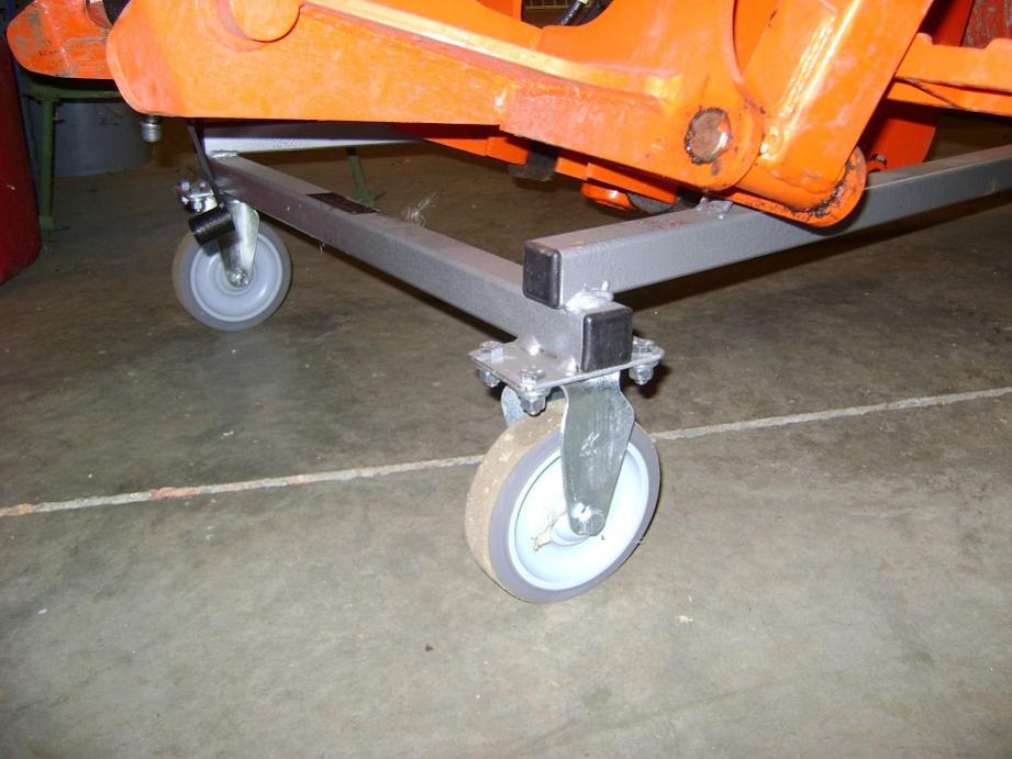

Kept flip flopping back and forth and ended up ordering it. For those that are interested in buying one, it is well worth the money. Nice paint job, end caps in the tubing and good quality castors. The welds aren't great but I'm kinda picky and I'm sure they will hold for what it is designed for.
Better yet, now I have the pattern to build one for a friend that also has the BX25.

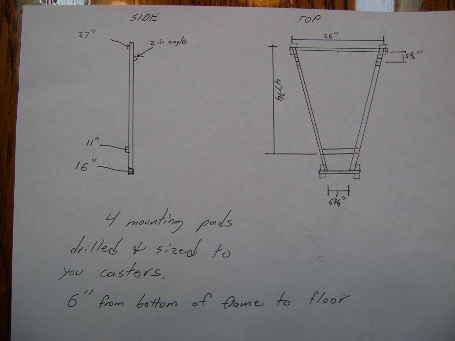

I got them today, now I just have to draw up a set of prints and scan them.
For those that want the piece list....
1 1/4 squre tubing.
54 1/4 x2
27 x1
11 x1
16 x1
1/8 thick 2 inch angle 1 inch long x2
1/8 thick pad 3 3/4 x 2 1/2 x4
Fixed castor that is 6 inch high x2
Swivel castor 6 inch high x2
The pads match the castor. If you use different castors, make the pads to match. Critical part is that castor is 6 inch high, not the wheel size, castor height.
Most of the tubing is boxed in the end. looks great, but not necessary. Some of the ends are also cut at an angle so it looks better but again, not necessary. I will mark the ones that are angled on the picture. I cut mine at 8 degrees.
