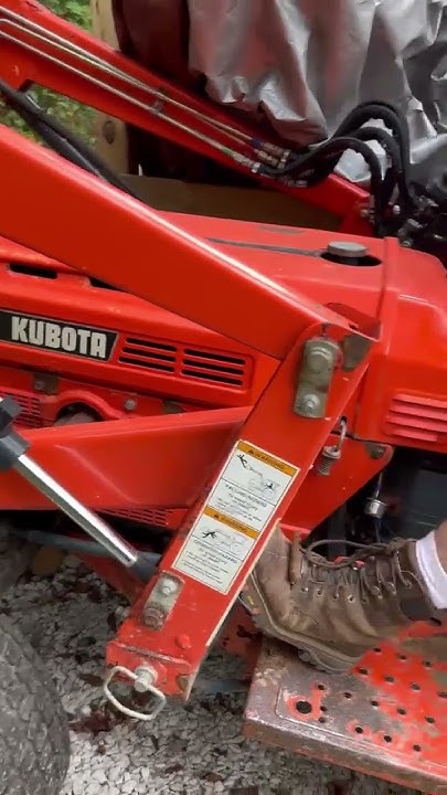

New owner of an older b8200, and put her to work last weekend. First time really using the tractor and it was epic. Moved large stones/logs, dug out a little stump. Well this weekend (i live 2.5 hours away from my property/tractor) i go to turn the tractor on and hear the click of the starter. The fan turns, as does the belt. Alternator (or what i think is alternator) is spinning. Battery tests at 12v.
So i took a video and while i wait the manual to get here, i hope someone would be kind enough to give me some tips.

Can you see how many volts the battery has while cranking?

The battery is dead!
Pull it out and have it load tested.
The other issue it could be having is it could be hydraulic locking from something in the hydraulic system putting pressure on the pump.

My B6200 is a similar to your B8200. It really sounds like your battery is weak.
What you are calling the choke in the video is the compression release. The engine should be turning much faster with that pulled out. I have only needed the compression release in cold weather to get things moving.
I will try to remember to video my b so you can hear the difference.

I also agree it sounds like your battery. However, it could also be your neg/pos cables as well as the terminals at both ends. Check to make sure they are all clean and tight.

The electrical has been "worked on". Given its age i'm not surprised and knew that walking in. The various warning lights don't light up at startup as i would expect but i could be wrong. Likely will snag a battery on my next trip up and snug up the connections.

Pulling the knob out releases compression on the cylinders so the starter can spin the engine faster. The engine will not start or run with the decompress knob pulled out. You pull it out to get the engine spinning nice and fast and then push it in to start the engine.
Also note that if you pull it out with the engine running the engine will shutdown with one hell of a nasty valve clatter.

For future searchers who may find this thread, my battery was indeed bad. Took it over to the local auto parts for a free test indicating bad health and a new battery install immediately solved that issue.
Thanks to all those who replied.
