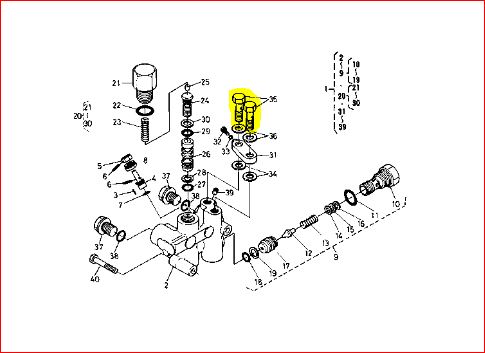

I thought that area was for power steering. I was wondering about #37; there are three of them. They are shown hooked up in Aerollands post with North Idaho Wolfman from 4-28-15 under hydraulic failures. It was a 3 day post 4-27-28 &29 of 2015. Thanks

I'm sorry you are exactly right, they are the side port and not the top ports.
The bolt and washers for these are:
66591-36250
67111-37180
But looking at the plugs I'm also thinking you might be able to get away with using Boss O-ring fittings, they would be a lot cheaper and a lot easier to hook up. ;)
