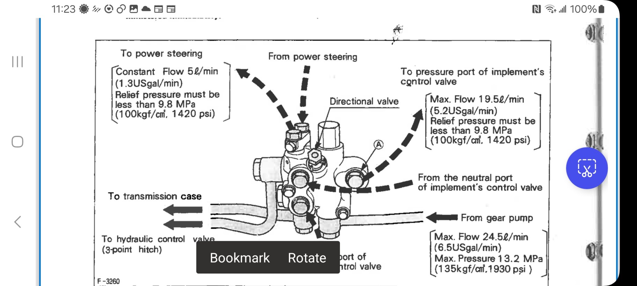

Basically gonna follow the one thread on here but have a few questions.
My 8200 is a 2 wheel drive hst. I have no plans to put a fel on it as it's only 2 wheel drive.
So doing this and using the valve block by the brakes, do I need a 5 port jd steering or can I use a 4 port one?
If I use a 5 port, can I just t the aux and the out together and go back to the return on the valve block by the brakes?
Thanks in advance

You need a flow divider to split the output from the hydraulic block into two separate circuits. One circuit feeds the PS valve and the other powers the 3pt.

I only skimmed that but if I understand correctly all B8200s had two PS ports on the OEM outlet block. That block is a priority flow divider so all you need is a PS valve with 4 ports.
PSout on tractor block -> pressure in on the PS valve
PSrtn on tractor block -> pressure out on the PS valve.
The other two ports on the PS valve go to the steering cylinder.
You might want to pay attention to the flows and oressures shown in the Kubota manual and compare them to the requirements of your PS system.

Careful with terminology.
The OEM block is your power beyond. It splits the PS flow off to the valve and sends the excess if any to "power beyond".
If you ever put a control valve (TnT??) on the tractor you we would simply turn the selector on the block to the implement position and that will reroute the excess flow to aux valve using the other two ports on the block. The TnT vslve would return power beyond back to the outlet block.

You do need Power beyond, as that what the three point uses.
33,318
8,660
You have power in and power out, so Power beyond.
Hydrostatic steering works just like any other normal hydraulic valve.
9,709
5,125
PS does not supply the 3pt.
On some models the PS circuit is a separate independent circuit created by the priority flow divider. The loader, backhoe, rear remotes, and 3pt are fed from the excess flow side of the priority valve.
On other models a tandem hydraulic pump is used. The PS circuit is supplied from one section and the second section supplies the loader, backhoe, remotes, and 3pt.
9,709
5,125
Think about that. When you turn the wheels you would lose your loader and 3pt hydraulics. Not good.
That's why PS is a different isolated circuit that returns to tank or on some HST machines acts as the charge pump.

Doesn't matter if you're going to have a FEL on it regardless. the FEL would hook up to different hydraulic ports. The b8200 hydraulic block has dedicated PS ports.
So you can use a 4port, or a 5 port with PB, like I did in the above guide, and loop it into the return.
Also, all these years later, i'm still amazed folks keep finding that thread.
Update, I recently broke the bolt holding the cylinder to the frame, after all these years. I replaced it, but just be aware you can break it if you're not careful. It's an easy fix and definitely better than breaking anything else.

Well since nobody answered my question I had to ask Google.
The 4 port 318 steering valve is a simple open center steering valve. If you use the return port to power a fown stream valve (a loader, remotes. 3pt) operation of the down stream valves will put the actuators in series with the steering cylinders resulting in loss of steering and/or down stream operation. It was and is a bad and potentially dangerous idea.
Because of that JD replaced the 4 port valve with a 5 port version. The 5 port valve incorporates a priority flow divider and steering vslve in a single housing. The flow divider section separates the inlet glow into two independent circuits. and isolates the steering flow from the downstream flow. The PS flow has prority and returns straight to tank. Any excess inlet flow is sent to the down stream valve.
If you connect the 5 port valve to a B8200 PS circuit you do not need or want the 5th port and if used it should return straight to tank. That effectively makes it a 4 port valve.
Now if you wanted to use a JD valve to add PS to a B7200 the opposite is true.
The B7200 does not have a built in priority valve of its own and you would need the 5 port steering valve. In this case you MUST move the selector valve on the tractors block to the loader position and use those two ports to connect the PS valve. Pump OUT on the tractor would go to pump IN on the steering valve, AUX out on the steering valve would return to implement return on the tractors block and PS out would return direct to tank.
Alternatuvely, if you had a 4 port steering valve you could use it and a standalone priority flow divider like this one to emulate operation of the 5 port valve.
You would connect the IN port on the flow divider to pump OUT on the tractors block and connect the excess OUT port on the flow divider to the implement return port on the tractors block. The priority port on the flow divider would them feed the 4 port PS valve which would return straight to tank.
