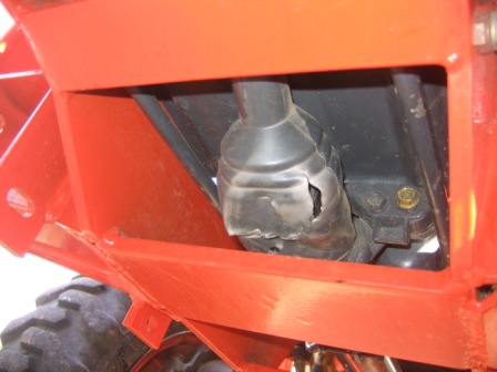

Hi Guys:
I'm not hearing a whine but more like a "ratcheting" or "grinding" sound, but not all the time, so that is a problem. My 3-year "powertrain" warranty expires Dec. 5, so I was curious if y'all thought the sound might be coming from the cover on the transmission shaft (?). Photo attached.
Hope to hear something from you guys.
David

Hi Ed:
I'm a newby owner of a 2007 B7800 and am hearing a ratcheting sound coming from what I think is the powertrain, but not all the time. The warranty expired Nov. 5 but my dealer has about a month to make the claim after that, so I've got about two weeks left to figure out what's up.
I've attached a photo of a plastic covering on the shaft which might be making the noise and wanted to check with you.
If this is the cause of the noise, I don't understand is why it's not making the sound all the time.
Any insight you could give me would be appreciated.
Thanks.
David
dusty-t
Feb 17, 2009
974
Mountforest Ontario
I am not Ed nor do I have Ed's expertise. But just from an old grease monkey I would say that is the source of your sounds. And it looks like damage from the outside.:D Dusty

Hi.
Been busy lately so haven't been on the computer much!
I doubt that your problem is caused by the cover, it could very well be caused by whatever damaged the cover though! are the u-joints inside the cover OK? I'd get it into the dealership right away so they can fix it up under warranty.
Ed

Thank you both. The dealer's picking up my Kubby on Monday. I'll report back what they say. I was just curious if it might make sense to cut away this plastic and see what I see. Maybe the sound would go away too. Save me a few bucks, anyway. They charge $80 to pickup&deliver back the tractor. Cheaper than buying a trailer which I'd use once or twice a year. Thanks again.

Again, thanks guys for your input. I promised an update on the funny noise coming from under the tractor (no, it's not a troll).
The dealership says it's the damaged plastic cover ($80 to pickup & deliver the tractor from 6 miles away, and the minimum $80 for one hour (really, did it take them more than 5 minutes?) for labor.
The kicker is that they says it's a $500 job to replace the plastic cover, so guess what? I'll live with it or cut away the cover and fabricate something else to protect that spot, or take another person's advice and simply cut away the plastic cover and forget about it.
For now, I'm fixing up my neighbor's shed where "Kubby" will hibernate for the winter. I'll already missing him.
