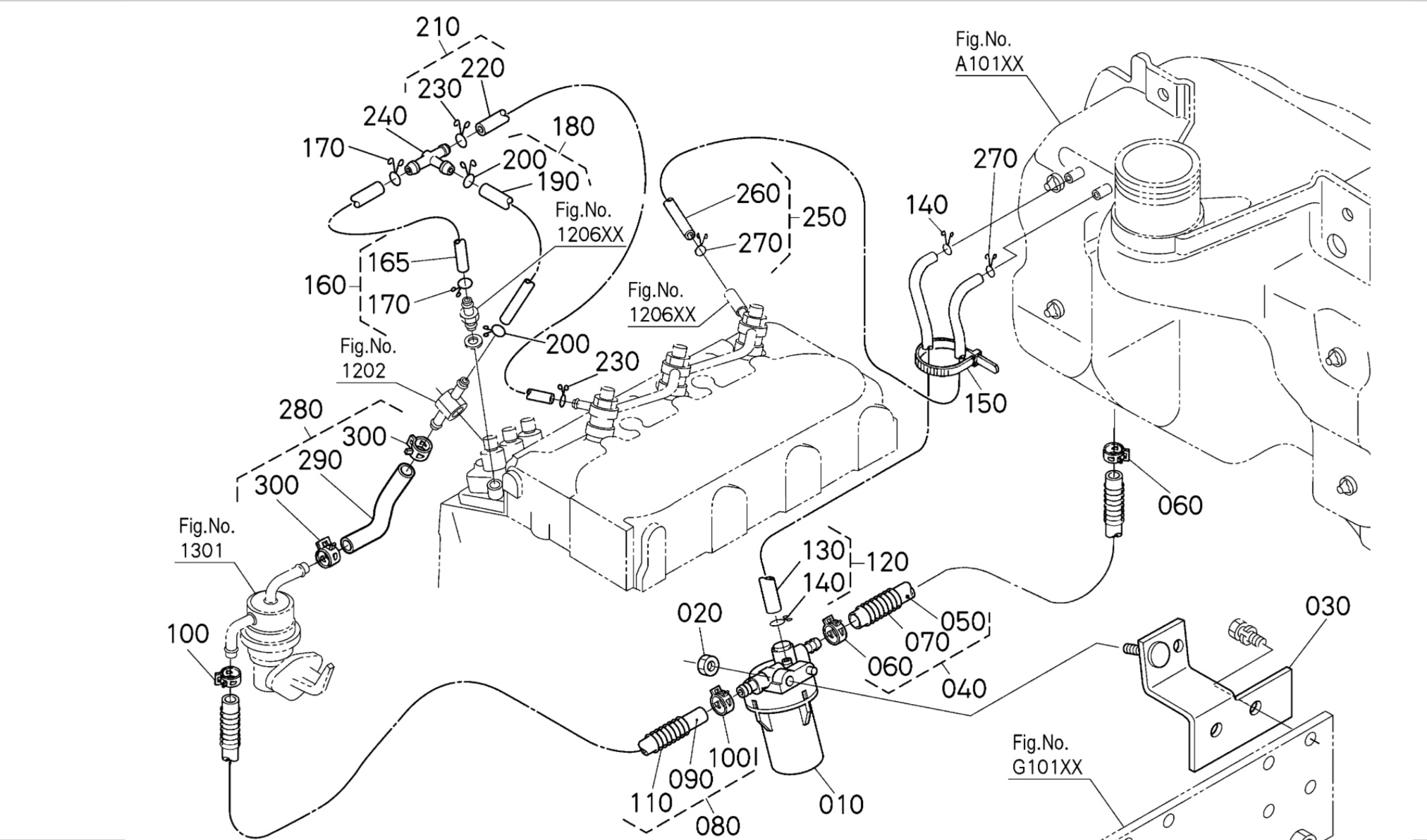

So I received new OEM injectors. Took off the injector fuel overflow pipe, pipe is plugged between center or middle #2 injector and number #3 injector (closest to rad). Openings in overflow collars are extremely small, no way any kind of wire will fit into it. Will try compressed air but no way of knowing if piping will be clean completely so there are no future injector plug ups. Can not order new overflow pipe until Tuesday because of Labor Day holiday.
One other note. Is there any reason that a person should not separate the collars leave some piping stubs attached to the collars, discard the hard pipe between the collars and use hose and clamps between the collars? Both ends of the overflow pipe header are hose anyway - one back into the injection pump and one back to the fuel tank.

On my L185 there are rubber hoses used for all the over flow between #1 and #2 and the tank. The clamps are pretty simple spring wire clamps so not able to hold too much pressure.
Could you post pictures of what you have going on? I would like to see what is going on out of curiosity.
Your illustration looks similar to what my tractor looks like except more complex.
Thanks Russell. My tractor is the same as yours. Middle injector #2 relieves excess fuel to #1 and also to #3. From #3 to injector pump via rubber hose, from #1 to fuel tank via rubber hose as well, with simple spring clamp at joints as you point out. In my tractor excess fuel over flow line from #2 injector to #1 injector and from #2 injector to #3 injector is 3/16", appears to be brass. I can blow air from #1 to #2 thru the brass tubing. I cannot blow air from #3 to #2 indicating blockage.
Since it is hose leaving injectors #1 and #3, i am thinking one should be able to cut the solid tube over flow line berween #2 And #3, clean out the debris and use hose to reconnect.

Yes you can cut the hard lines and replace with hose sections.

Russell - did I clear things up in my explanation?
Yes you cleared it up.
And to be perfectly clear, the diagram above is for your tractor not mine. My tractor dumps all excess fuel back to the tank, while yours circulates some back to the pump and some back to the tank.
If needed, you should be able to remove the injector lines and remove the fuel return portion of the injectors to clean them out. But you may not be able to buy those parts so be careful.
It is just curious that someone used hardline to replace rubber hoses. But perhaps that is how the factory did it? I don’t know. Not sure how hard line is connected to the injectors either.

Alberta
Thanks Russell. The injector fuel overflow pipe is a factory item. I will post a picture later. I will take a picture of the injector assembly to possibly show how it relieves fuel to the solid "injector fuel overflow pipe" as Kubota calls the set-up.
