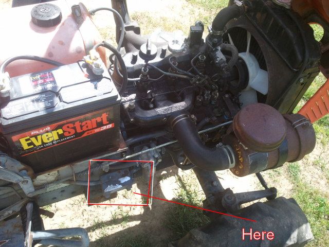

The only box I see is the hyd. pump itself. Its attached to the fuel pump. The steel lines at this pump operate my 3pt rear implements. I do not see any other box halfway up the frame. I thought the ports I posted in my pics are for adding front implements. My manual states:

If you like I can send more pics. I was planning on using my rear blade and your blower at the same time. I may have to turn the above mentioned control valve to operate only one thing at a time perhaps. That is not a big deal compared to not having a blower at all. I can call a dealer and ask about all this. I tried taking more pics of my hyd. pump and the steel lines that go under the seat to run the control lever for the rear lift arms but they turned out to dark to post tonight.

I called the a Kubota dealer in Ill. The service dept. recommended I just buy a newer tractor with a blower already included. He said he can't find the block you are talking about. My other problem is that if I try to use my diverter valve I think I will be closing off my hyd. pressure to the rear. My valves leak a bit and my blade will not stay in the up position for long, so it will fall and drag until I raise it back up again. I have uploaded more pics so you can see what I have. These are all on the right side of the tractor as you are sitting on it. The dealer told me the block you are talking about should be by the rpm lever for the rear pto. You can see it in my pic but it is on the left side. So I guess I am a bit confused. To be perfectly honest I am almost ready to buy a whole tractor with a blower.

In the very first pic on photobucket there is a plate of sorts by the brake pedals. Is this where the hoses and bloc are supposed to go? Not knowing how to hook this up and a dealer who tells me I need a new tractor is not going to make me visit Iowa. There is another dealer I used to visit about 60 miles from my house. i don't visit him any more since I paid him $200 to fix my non starting tractor and when I got it home it still did not start. I fixed it myself with a new $10 battery ground cable. The dealer also told me I needed a $2000 engine rebuild. That was about 10 years ago and I have done nothing to my tractor since my $10 fix. My tractor still starts and runs fine.

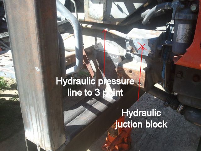

28,713
5,129
visora,
The block that Big Kahuna points out would only work if your tractor had the needed female junction block on the tractor already, by the pictures it doesn't look like you have one on yours. Here is a picture of mine and it shows what it looks like and where it's located.
If yours doesn't have the block you have 2 options,
Option 1: Cut the pressure line and put fittings on that line to be able to tap into the pump pressure, this will allow the 3 point to also work at the same time.
Option 2 : Tap into the bypass valve and make a return line too, this will not allow you to use the 3 point at the same time.
Here is the block, rectangle with 4 bolts on the cover.
