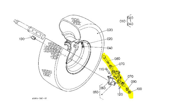

B7300 Left Rear squeaking noize.
BAP
Dec 31, 2012
2,550
680
Check the lugnuts. Sounds like they have loosened up.
28,996
5,333
The other very common cause of that type of noise would be a loose hub, check that the bolt for the cotter locks are very tight. ;)
Bearings very rarely make squeaking noises when they fail.
