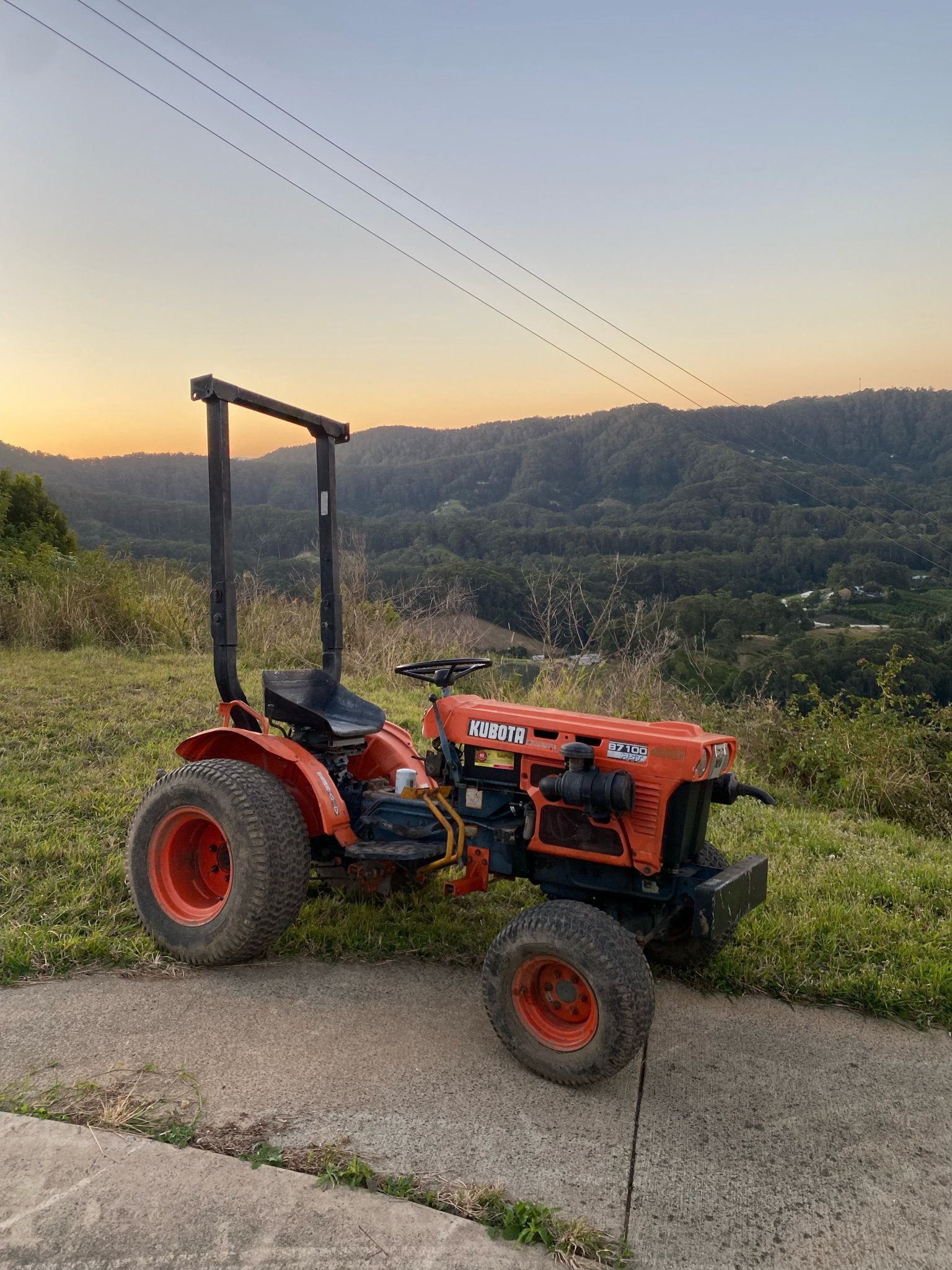

Having grown up on a hilly property with a B6100 geared version that worked so well at maintaining the grass/weeds on the steep hillsides.
I now have a property with steep hills and I have just acquired B7100HSTD 4WD to hopefully help maintain my property. It came with mid mount mower, I think it is RC60-72H from looking at pictures online as there is no identification numbers left on the deck. I need to find a service manual for the mower, but I also want to get a slasher/bush hog to be able to back up banks and over edges.
I am hoping the B7100HST has similar power as the B6100 geared did. There wasn't much the B6100 couldn't handle.
I don't know the history of the tractor and it needs a full service, clean and flush radiator, all filters and fluids changed, grease etc
It also has a couple of things that need fixing and looking at

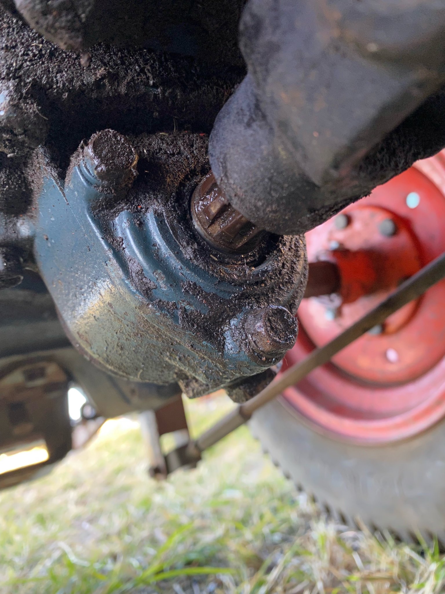

-Front wheel drive shaft cover spins with the front wheel drive shaft. Rubber boot is not attached and seems to be a lot of friction between the cover and the drive shaft. I have read a post on how to fix it, assuming I can get parts.
- Rear 3 point hitch lift doesn't seem to stay up over longer periods of time and when it drops it pulls the lift lever handle back, then when you start the tractor the hydraulic lift makes all sorts of noise trying to raise the 3 point lift because the handle lever is stuck back. I read this couple be an O ring in the cylinder or is it something else? I find it odd that it pulls the lift handle back?
- Rear PTO seal looks like it might be leaking, I need to investigate
Upgrades I want to do
- It has turf tyres, I need Ag wheels and tyres or put Ag style on the turf wheels/rims, which I read people have done. Not sure which would be better for hills? The B6100 had the skinny Ags but with spacers which worked amazing or do I go for turf wheels with Ag style tires (I don't think the lugs are as big) but they would be wider, Which would have more grip?
- New Seat
- Canopy
- Front grill guard
-Front carry all/platform
- Front end loader (this is a bit of a dream)
I have not driven the tractor much because I don't want to without out giving it a service so I am not sure what other issues it might have, however I don't want to spend money servicing it, if it has too many issue that need repair that make the tractor worth it.
What would you recommend I do?

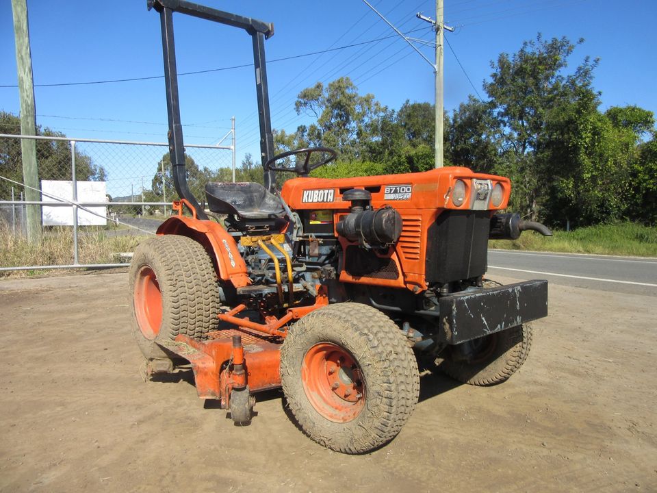

As my B7100 HST needs some maintenance and repairs etc when looking at parts I have noticed there is a new and old version of the B7100 HST. I have read the forum on how to look up the serial number, 6 stud wheels, B series model year matrix PDF etc but I still can't tell what year mine was made or if it is the new or old version.
Serial Number: B7100HD542XX
Engine Number: D750 AH
1650 hours
6 stud wheels
Number stamped on rear wheel: 6 89
Can anyone tell me if it is the old or new version?

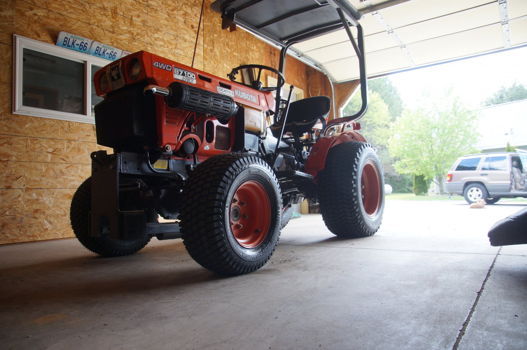

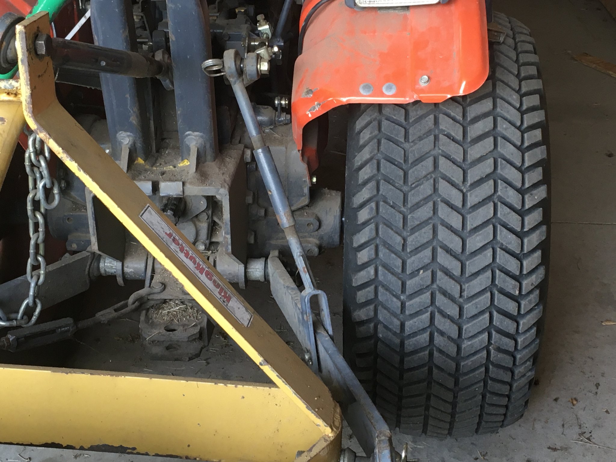

Yours is the newer style B7100. It will have more power than a B6100.
I put these on my B7100 turf rims, and they worked very well-
"Well I now have a set on my tractor that meets all the requirements above. They are as follows:
Rear - 29 x 12.50 x 15 (RC = 88 inch @ 15psi) Carlisle TRU POWER
Front - 20 x 8 x 10 (RC = 62 inch @ 25psi) Kenda K378"

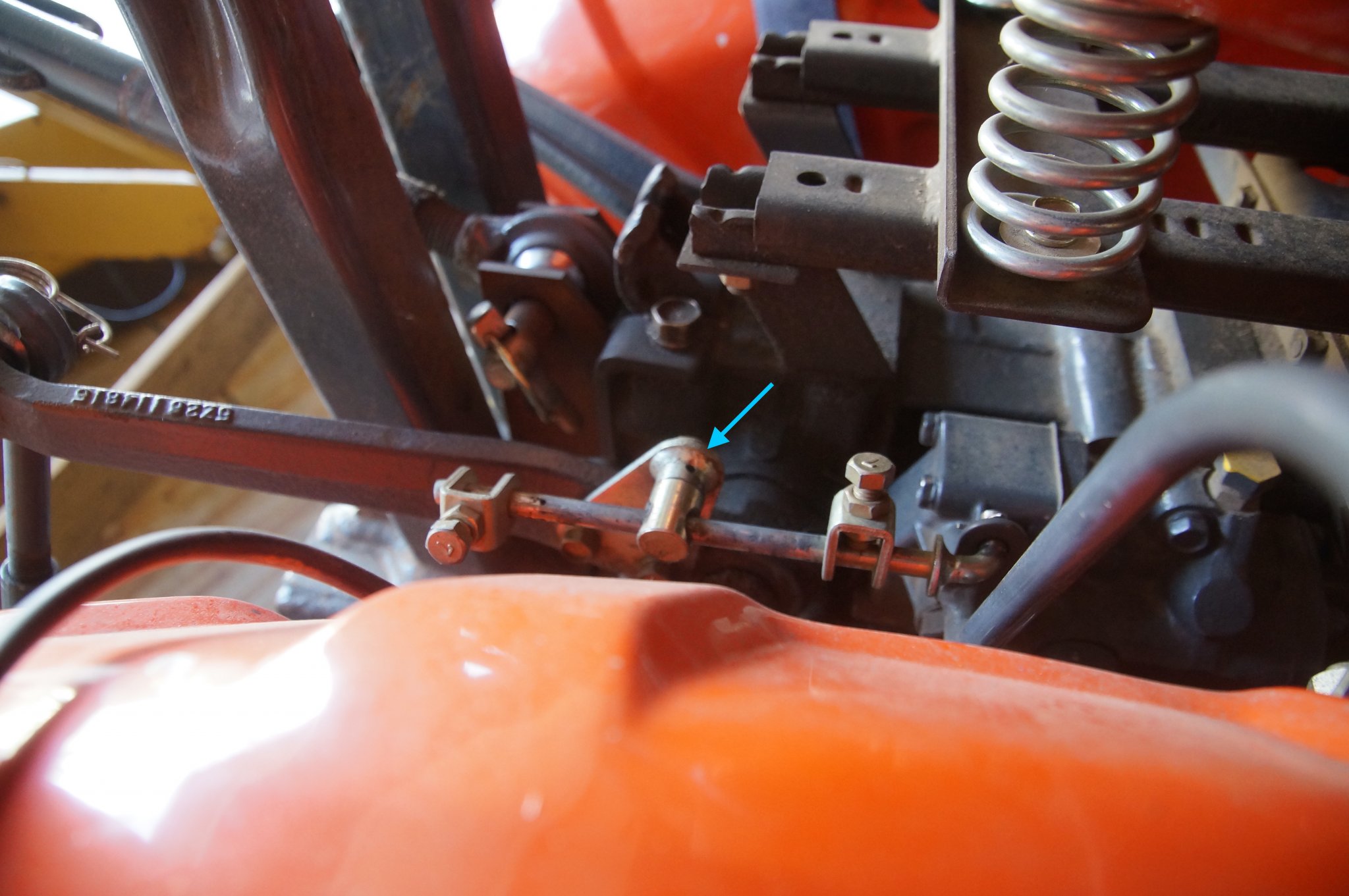

The 3pt pulling on the handle is probably pretty simple. There is an adjustable stop on a rod hooked from the 3pt rockshaft lift arm to the actual valve handle you pull on. The stop serves to push the handle from 'raise' to 'hold' when the 3pt raises to the stop. At all other times the rod is supposed to slide freely and not push or pull the handle. Yours is probably binding due to wear or misalignment.

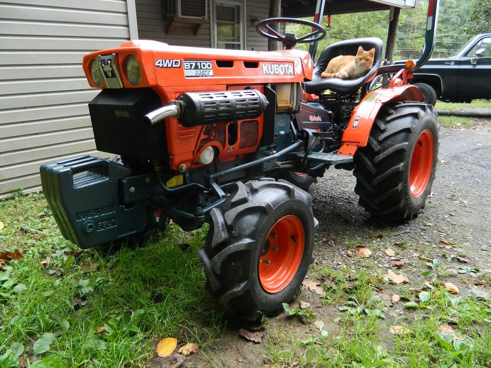

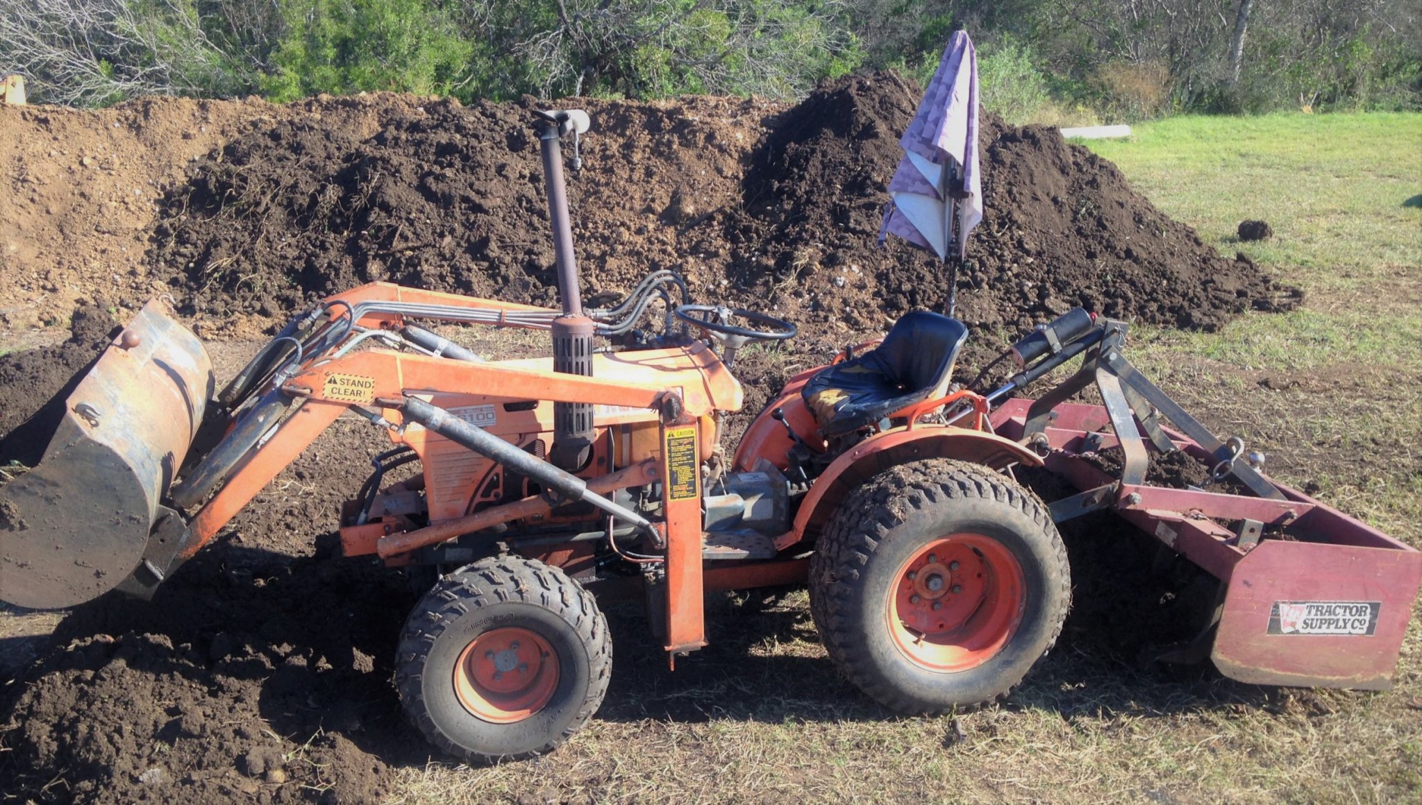

Congrats on acquiring a late version HST B7100! I think you will enjoy the capabilities of these compact work horses. Your machine has a few interesting additions/changes from what I am used to see. The "box" that is around the exhaust pipe between the exhaust manifold and muffler caught my eye.
You might want to give your turf tires a chance to see how they preform before changing out. I have turfs on mine and constantly impressed with the traction in a wide variety of terrain, conditions and implement use. I use a front 50 inch snowblower on the front, 6 foot back blade, 4 foot box blade, 5 foot landscape rake and did have a 4 foot brush cutter. I never lacked power and it seems as if the tractor is well balanced between HP and weight/traction.
When I purchased the tractor used with 900 hours the front turfs had been replaced with a "trailer" non-turf tires. Last summer I got around to ordering and installing a proper sized turf tire and instantly could feel a increase in front end traction.

My three point lever started acting up, it seemed to be binding and the lever would be pulled from the center position without hitting the stops.
What I found out was that the "barrel" that the rod with the stops goes thru was not pivoting. The blue arrow is pointing to an oil lubrication hole that I had neglected. The barrel would not rotate and would bind up the adjustment rod, after oiling and freeing up everything was working proper again. You might want to check this on yours along with the adjustment stops.

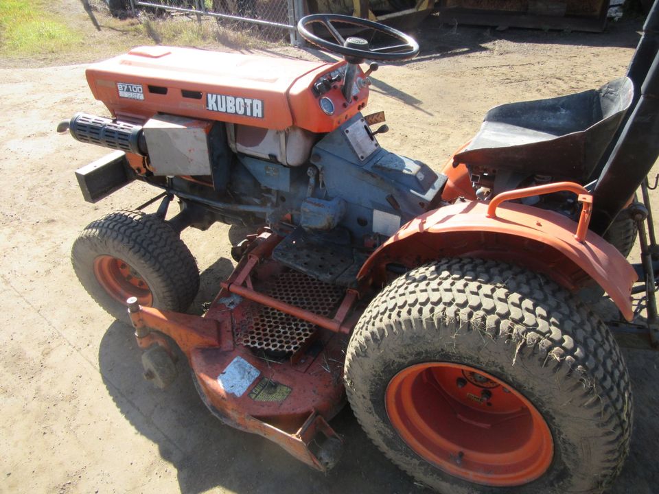

Your tractor looks great! Such great condition, thanks for sharing, I think I will end putting these tires like these on
Thanks for your reply and sharing some great info and pics of your nice looking B7100, the hand controls look great!
The box on the muffler caught my eye too, I think it mast be a mod because I have never seen it on any B7100s

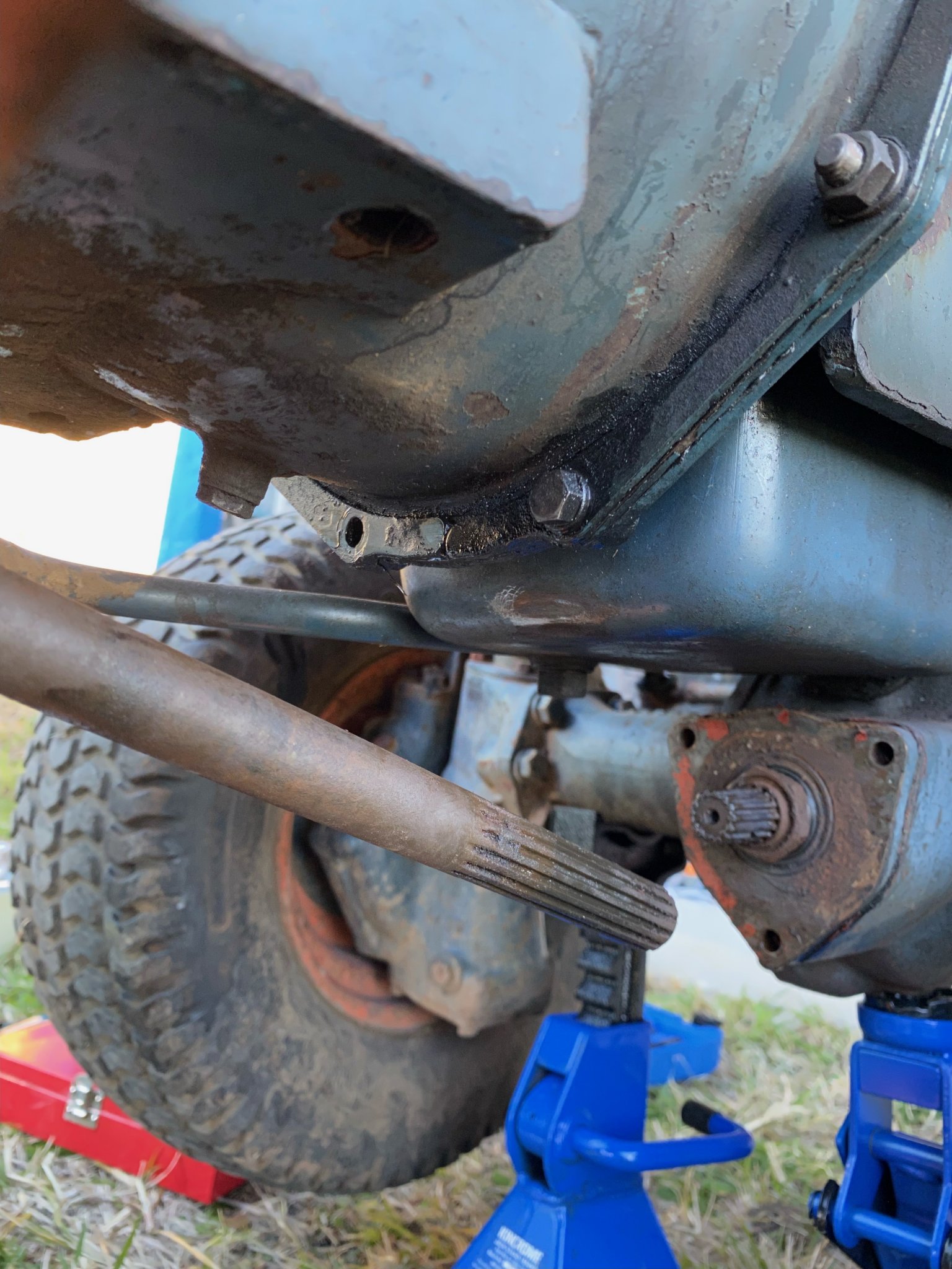

Today I disassembled and removed the front driveshaft because the cover and rubber boot were all spinning with the driveshaft and I didn't want it to cause any more problems. The rubber boot is pretty much had it, stiff and falling a part. the seal/bushing at the other end of the drive shaft cover seems in pretty good condition however the rubber is also falling apart where the circular spring goes around the rubber. The brass bushing seems ok, it seems like it is suppose to let the driveshaft spin around it. There is a shiny spot on the drive shaft where it goes, so not sure why the cover started to spin. I will clean drive shaft and see if I can get a new rubber boot and bushing from the dealer then reassemble.
Once I removed the front drive shaft I took the B7100 on my first drive. It did not disappoint, it seems like it has a good amount of power, the wider turf style wheels seem very stable. I went up and down some steep sections (I need more weight on the front) and I was impressed with the HST being able to adjust speed on the fly compared to the geared 6100. Even slowing right down then changing direction, and how it stays at that speed on the slope and does not seem to run away.
One thing I was not sure how it was going to work was the ability to use the split breaks while going up a hill when the front wheels get light. With the HST you cant really press the forward pedal and brakes at the same time compared to to the B6100 geared. However the speed set seems to do this all though I later found out mine is not working correctly, more on this later.
Does Diff lock work in reverse with the B7100 HST? I could only seem to get it working going forward, the diff lock pedal went down in reverse but only one rear wheel was spinning.
Other things I found that need addressing. (I never know if I should start new threads for these things, so please tell me if I should.)

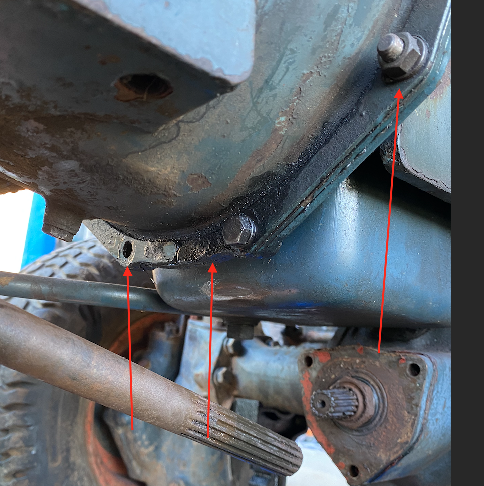

Missing bolt and leaking oil at the clutch housing see pic. It looks like the clutch has been apart because there is a bolt missing at the bottom, a different style of bolt that is in backwards compared to the others. There is also oil leaking, I am hoping it is just because the bolt is missing? I have cleaned the oil so see if it comes back and I will get a new bolt.

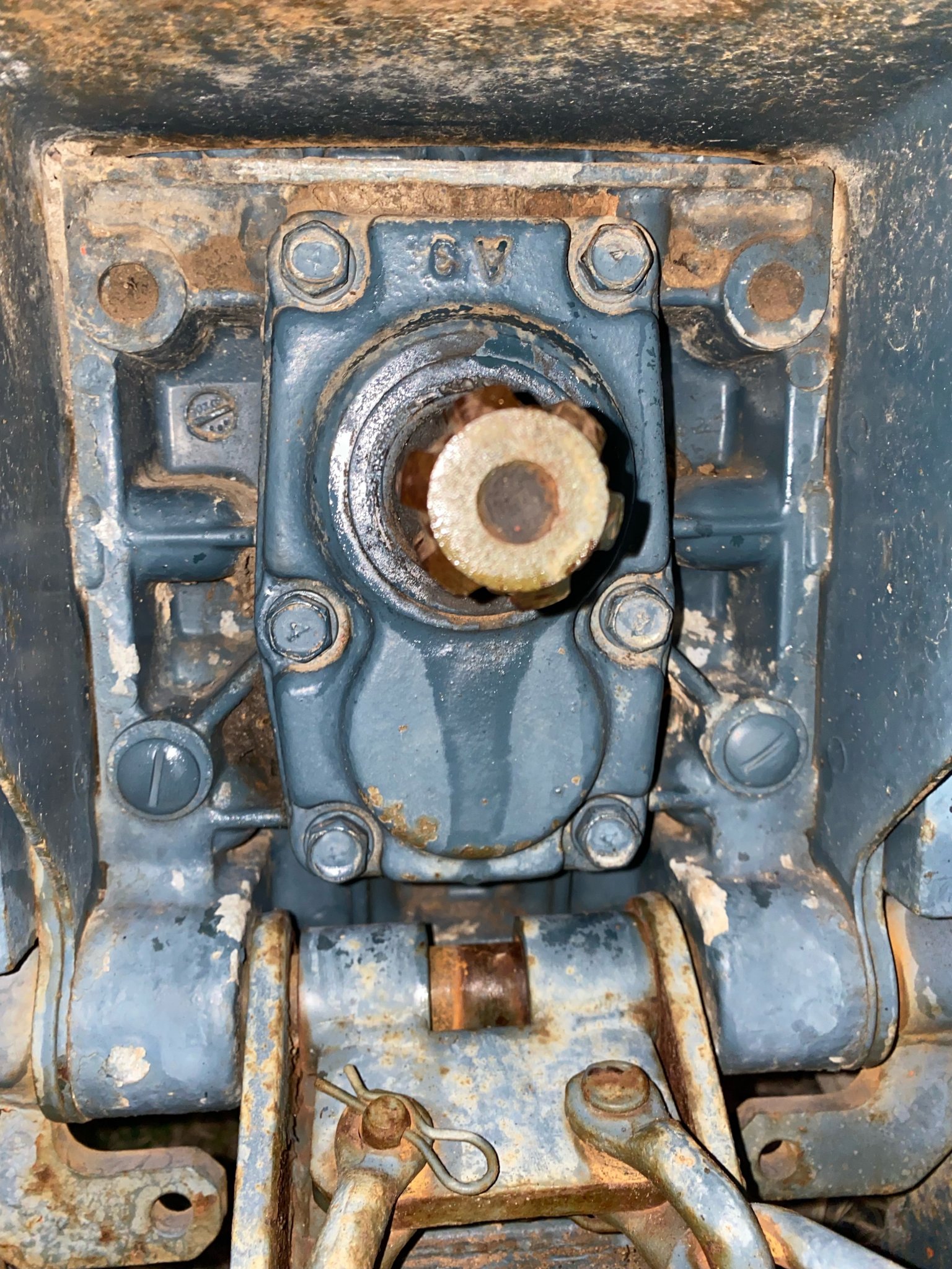

Leaking oil out of the rear PTO, I cleaned it before first drive and it came back. Looks like it needs a new seal? I have seen a pos video on this doesn't look too hard assuming I can get the part

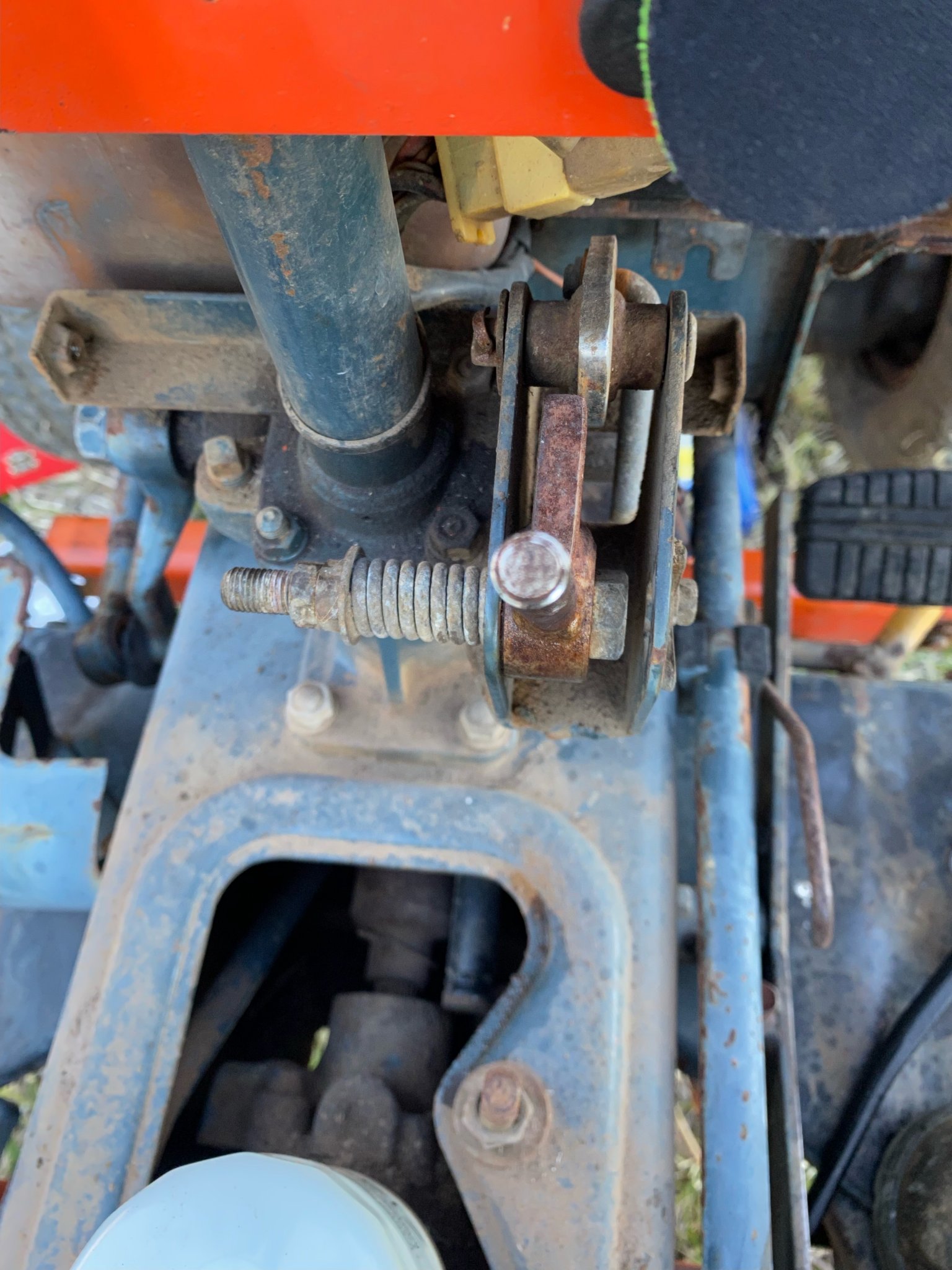

Speed set lever, does not line up with the plate see pic, there might be some parts missing? it is hard to tell how it is assembled in the parts diagram, is the head of the bolt supposed to sit in the bracket so the bolt doesn't turn? Can anyone post a pic of Theirs?

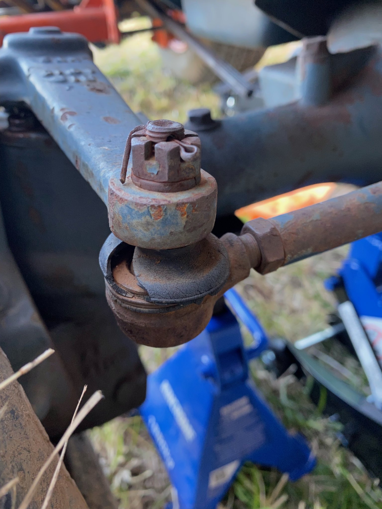

Rubber boots on steering linkages are falling apart, do they need to be replaced or can you go without? Do you need to grease these?

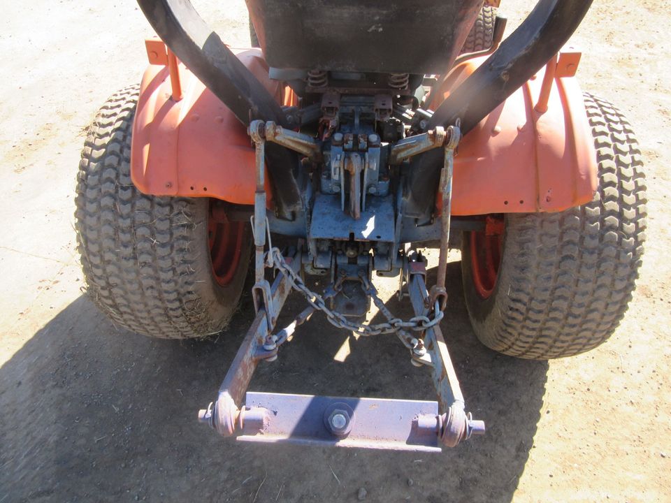

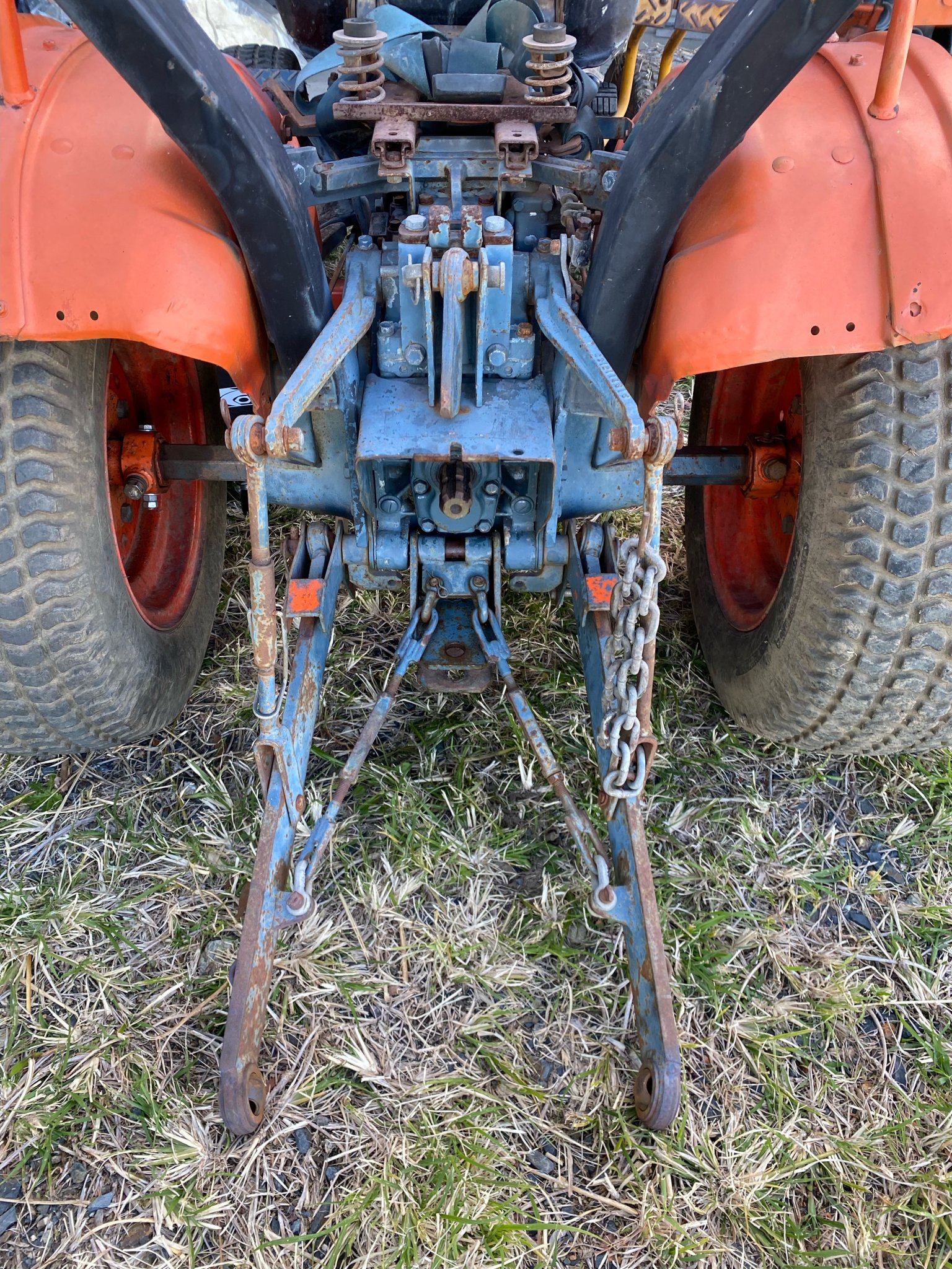

3 point hitch lift rods seem to be on the wrong sides? I have seen other B7100s with adjustable lift rod on the right and they should be on the inside of the lift arms not the outside?

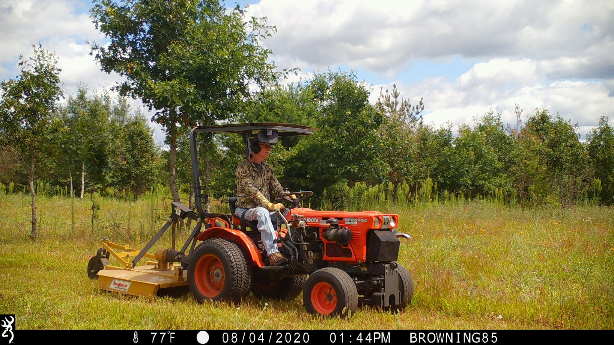

Thanks for posting the great pictures of the condition and up coming repair work! I do not know what is the "right" thing for you as far as repairing this tractor or looking for one in better condition but I for one will enjoy your progress if you should decide to push forward.

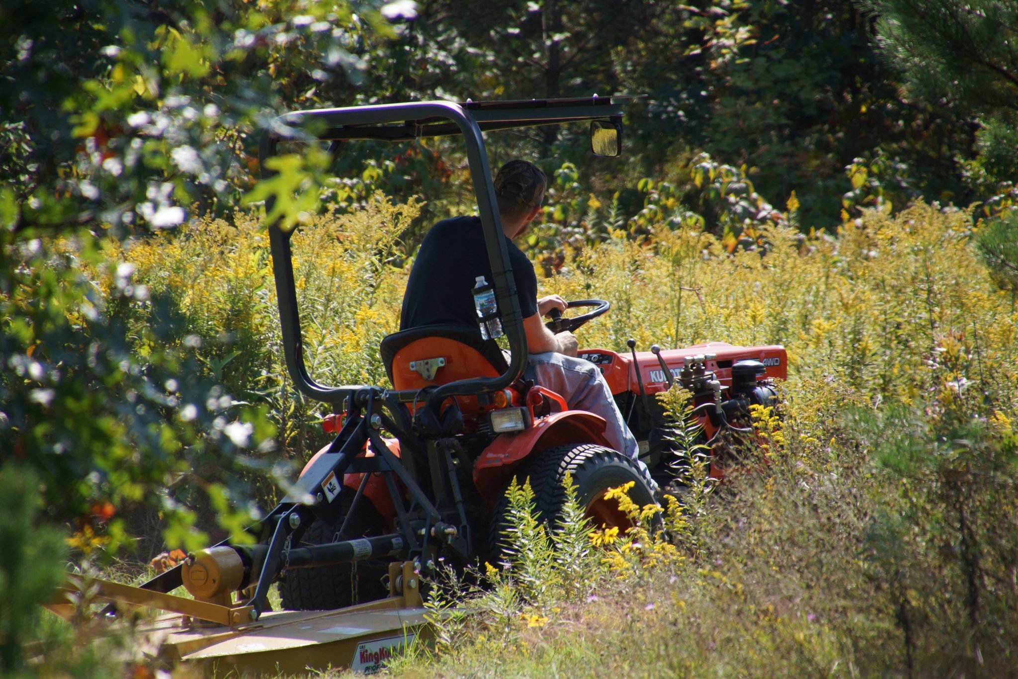

I ran a 4 foot King Kutter brand rotary cutter on my B7100 for 4 years without any issues. I traded it to my buddy, he wanted a small cutter for his BX and I needed a larger cutter for my L2501. I already miss the 4 footer on the B7100 for getting in tight spots around buildings, trees etc.
I ran the cutter into some pretty thick/high cool season grasses but of course would adjust my travel speed to match or take less than a full cut.
I do have some hills on my land and the majority of time I would run this cutter in high range. A few times in the really thick stuff I would mow in low range.
This picture is my son cutting some thick golden rod and grasses.

The leveling lift arms are on the inside with the adjustable one being on the right hand side as viewing from the rear of the tractor.
