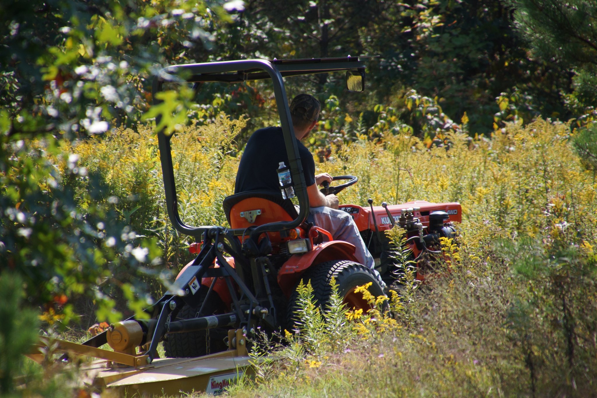

I ran a 4 foot King Kutter brand rotary cutter on my B7100 for 4 years without any issues. I traded it to my buddy, he wanted a small cutter for his BX and I needed a larger cutter for my L2501. I already miss the 4 footer on the B7100 for getting in tight spots around buildings, trees etc.
I ran the cutter into some pretty thick/high cool season grasses but of course would adjust my travel speed to match or take less than a full cut.
I do have some hills on my land and the majority of time I would run this cutter in high range. A few times in the really thick stuff I would mow in low range.
This picture is my son cutting some thick golden rod and grasses.
Thanks for that information, really helpful, it makes sense about slowing down in the tough stuff, and I sort of doing that with the B6100 all those years ago, I cant remember what size slasher it was though. I was amazed what it would cut back then.
Great picture of your son, I have also just noticed your canopy did you make it? Looks great

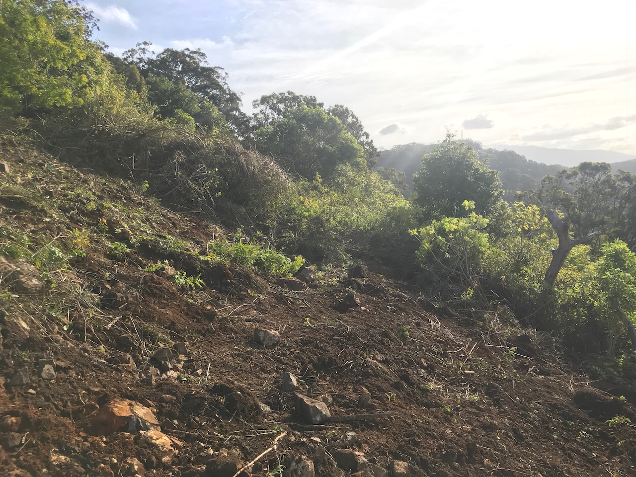

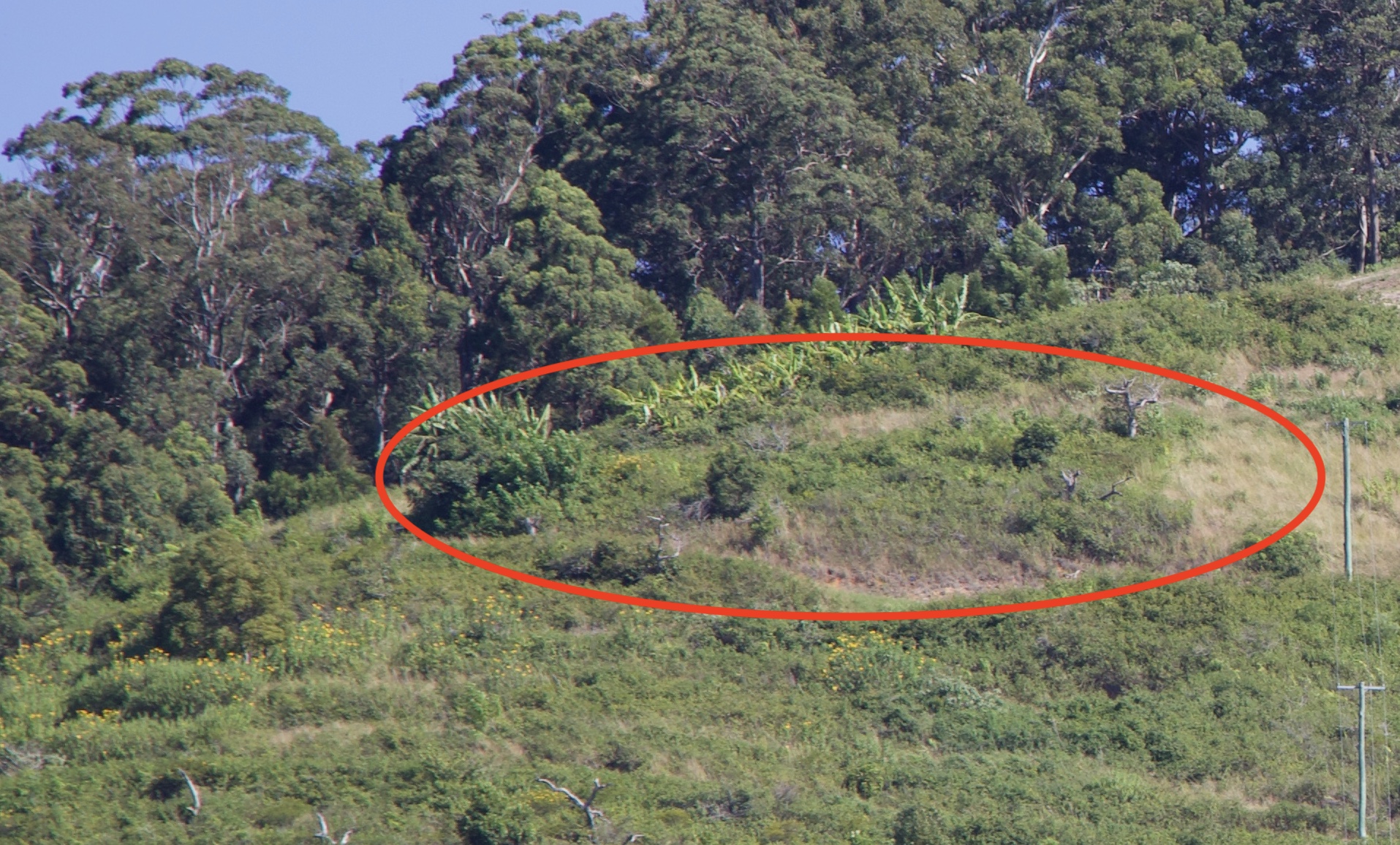

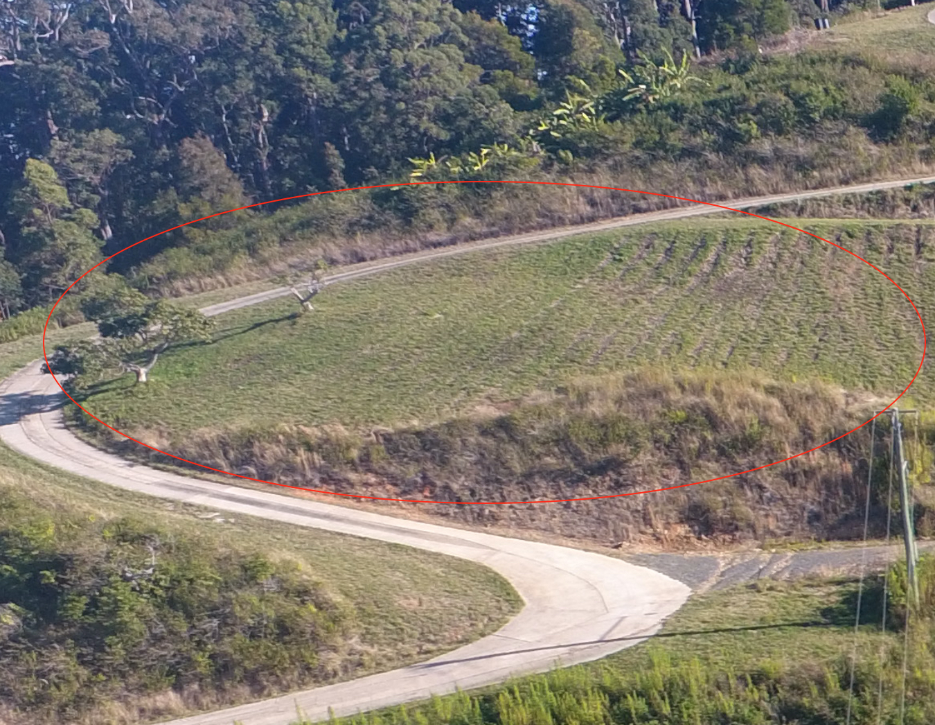

My property is pretty steep and has loose rocks. I have slowly been clearing the brush and moving the rocks and the grass grows back.
Here is a pic of an area that was overgrown with brush.
Here is the same area (slightly different angle) after it being cleared and regular cut to keep the weeds down and allow the grass to grow back. I pay someone to cut it with a huge John Deer 4WD Tractor which is why it has ruts. I am not concerned about ruts at this stage where the property is at.
This is what it was like when it was being cleared.
I know the B6100 with skinny Ags could have handle the slope and surface just fine. I am thinking that standard turfs might not have enough grip and I am thinking maybe maybe the turf wheels with the Ag style tires like @hodge posted above. What do you think would be the best wheel tire set up for me?
Thank you , yes I did make the canopy. I was fortunate that I had a few shops in the area that did the square tube bending and the top which is 3/16 plate(overkill yes but the plate is what I had on hand). I had a "slight bend" put on the top to shed water. One of the biggest reason that I put a canopy on was that I needed a hand hold up high that I could pull myself from my wheelchair up onto the seat. For two years before the canopy I was twisting in my chair and using the steering wheel and the hand hold on the fender to push myself up. Long story short, this twisting motion caused a rotator cuff injury. I must say after having the canopy on those hot sunny days it was nice!
In this picture you can see how the square tubing bends match up great with the bends on the ROPS. The slight bend in the top plate is also visible. Besides the hand hold it also gave me a place to mount a rear view mirror. This picture was taken at a buddies land. At the time he did not have a way of mowing the driving trails on his 80 acre property.
Seeing the slopes you're talking about, i agree with you. One of the things that's going to be different between turfs and ags is what car people would call 'breakaway' of the tire, or how quickly traction fades as the tire begins to slip.
On an ag tire which has some tread partially 'sunk into the ground' (if ground is not super hard), when you begin sliding the tires basically have to continuously dig new ruts for the tires to slide in (sort of like a plow being drug through the ground). Traction doesn't exactly go from 100 to 0.
On a turf tire which is 99% just 'sitting on top of the ground', once you begin sliding down a hill you might as well be on skis. The traction does something more like going from 100 to 0, making recovery much more difficult.
There is a term called 'stiction' which refers to this difference in friction based on the relative speed of two surfaces. I didn't know that until recently..
If operating on steep slopes I would prefer skinny ag tires, but set to the widest setting to avoid tipping sideways. The rear 'drive hubs' can be moved to different positions on the axle to widen or narrow the rear width, and the wheels can be flipped inside out to stick out further. The front wheels can also be flipped inside out to make the front stance wider. However, AG tires are directional so if you already had ag tires on it and wanted to flip the wheels to the wider setup, you would also have to dismount and flip the tires on the wheels. If you don't have ags and would be installing them facing the direction you intended in the first place, that is not an issue.
The downside of course is you will leave marks, but i'd rather have my tires leave marks on the ground, than for my face to..

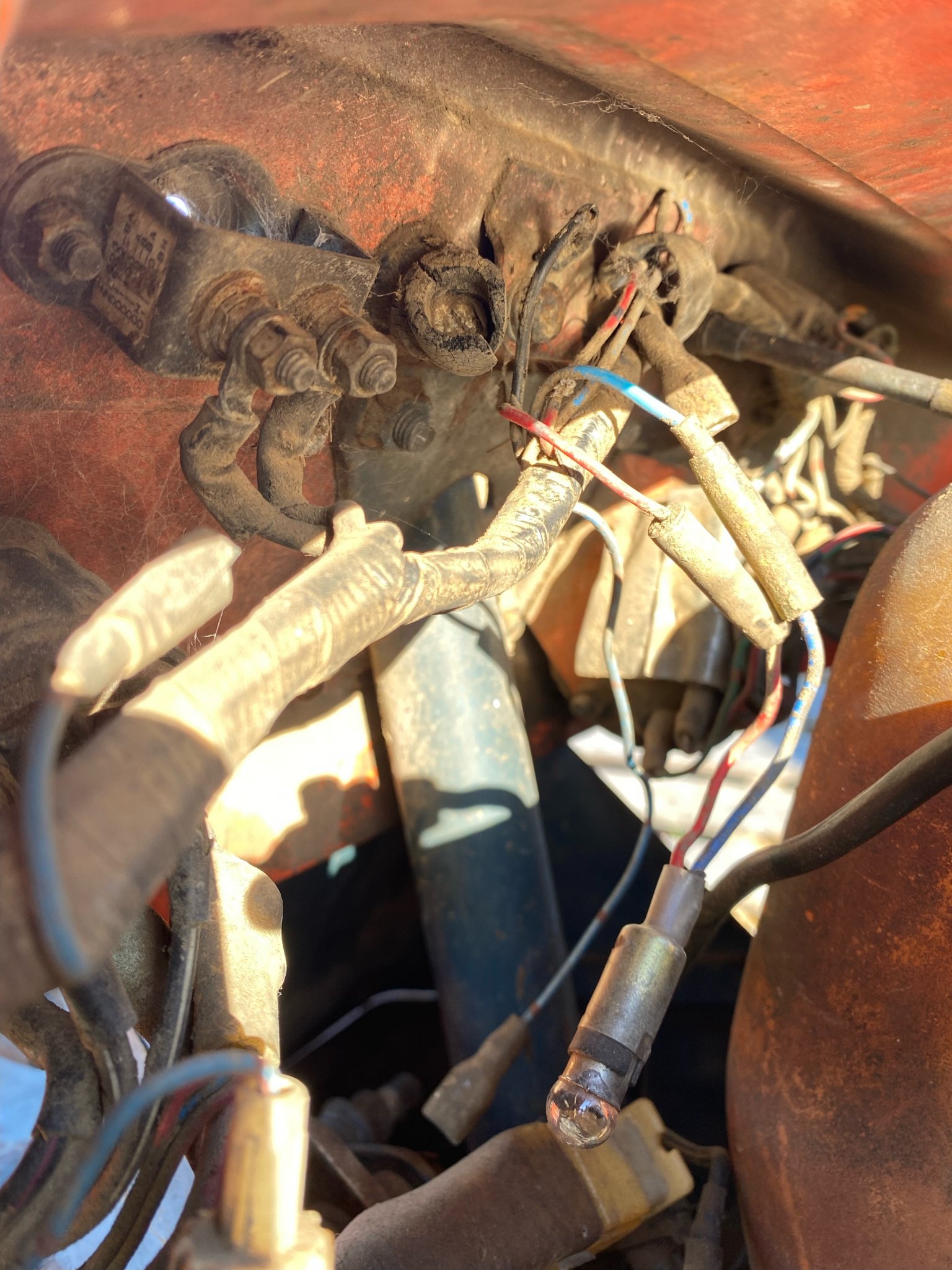

Check the light bulb and see if it works.
There is a rubber boot that holds the light bulb in front of the red lens, that might be the culprit, It looks like there should be 12v going to the switch (normally open) and then when oil pressure hits it it closes the switch turning off the light. I have replaced all 3 of my oil pressure switches here in the past two years, due to leaking oil and not staying closed with good oil pressure.
I have even have replaced a key switch when one point was not out putting 12v anymore.
Does your hourmeter work?
And, check the fuses in the dash, they are the glass tube type. There used to be two spares in a bag stapled around a wire in the dash
Leave the turf tires on and try the hill, then you will know.

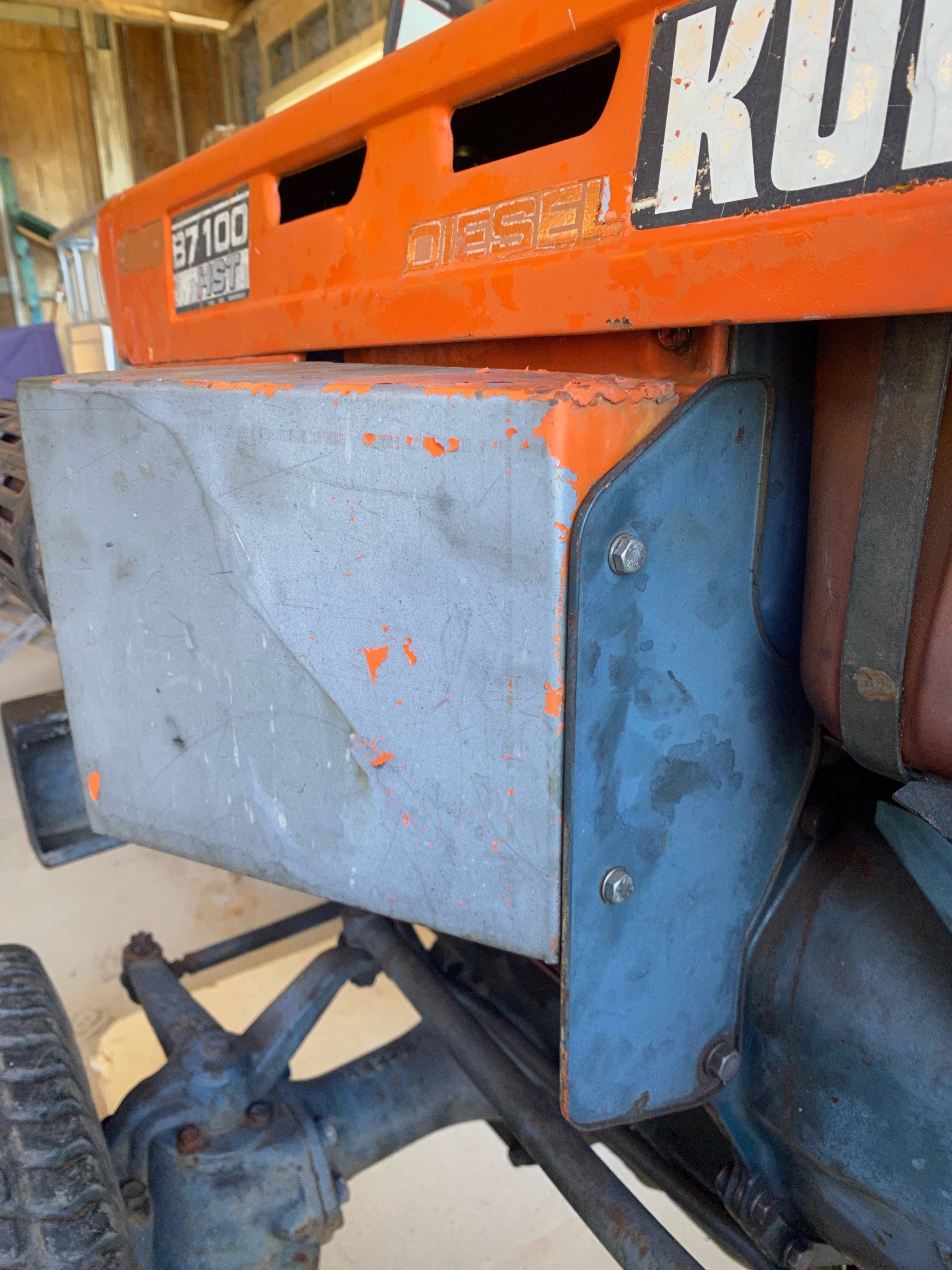

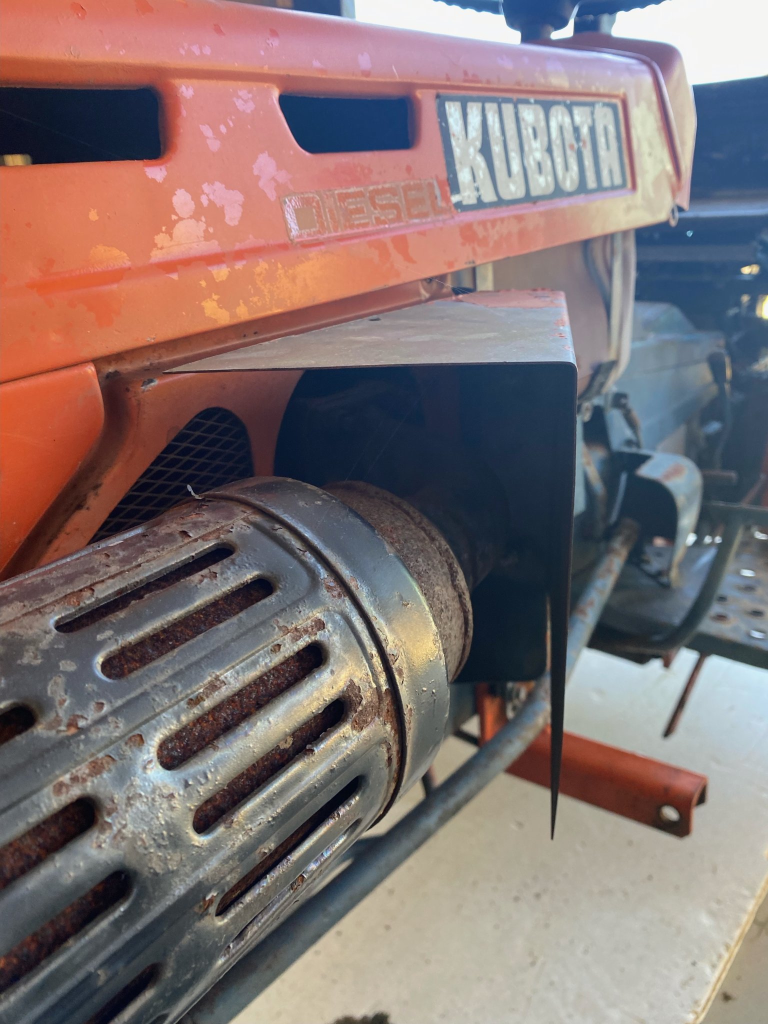

Can you a better picture of the shield that is around your exhaust. It looks interesting, and something I might make for mine.
My hour meter does work. Clicks over both on glow warm up and while the tractor is running.
I found the oil pressure bulb dangling down behind the dash, confirmed it didn't work. I then opened the three fuses, all were OK but very dirty, I cleaned the best I could then reseated. Then the oil light started working :) the problem is, it is behind the dash haha
The rubber boot seems to be at a right angle? and degrading badly. Is there a way to get the globe in there without the rubber boot? or do I need to try and get a replacement?
All the wires are super dirty behind the dash, any clue what the best way to clean them would be? or is it safer just to leave them alone?
The exhaust shield is interesting something I have not seen before. I asked the guy I bought it off about it and he acted like it was standard.
Pics of the exhaust shield, certainly interesting
Thats awesome you were able to build the canopy and have it serve multiple purposes and stop you from hurting your shoulder getting on and off, I did see the hand controls on your B7100. I like the idea of hand controls. I am still getting used to the foot pedal speed control, it seems really touchy. The mirror is such a good idea! I had not thought of that.
Thats a lot of trails too clear! It looks like your B7100 is doing a great job clearing them with the 4 foot cutter. Do you have to clean the front shield often when mowing?

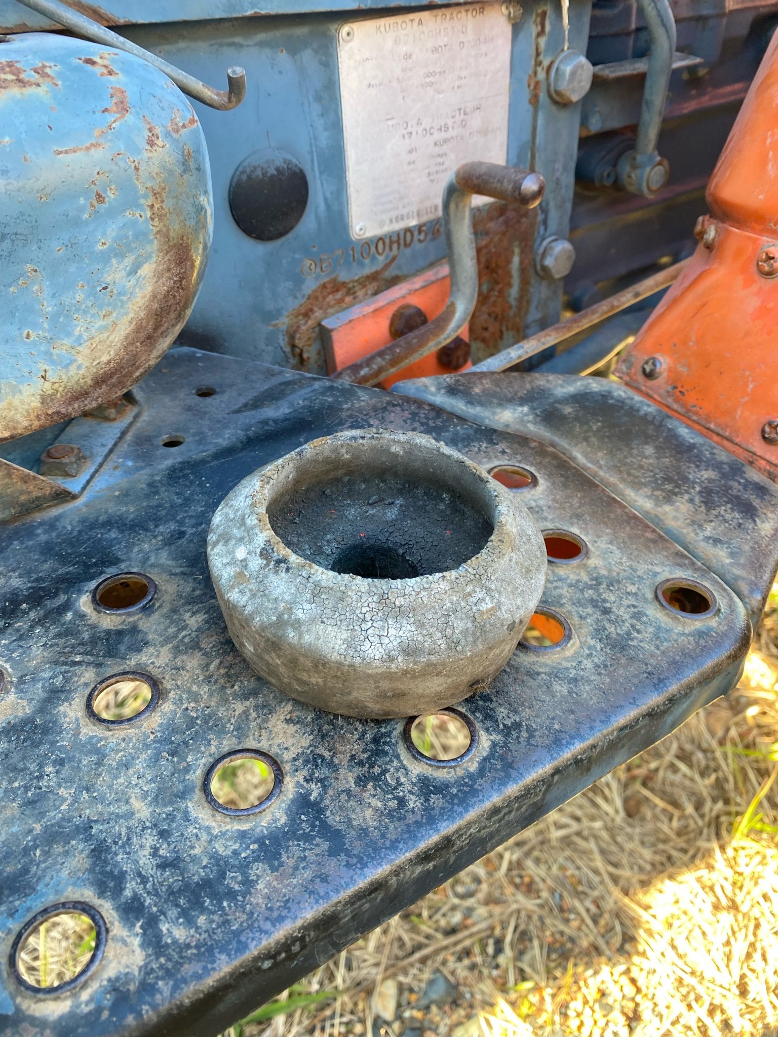

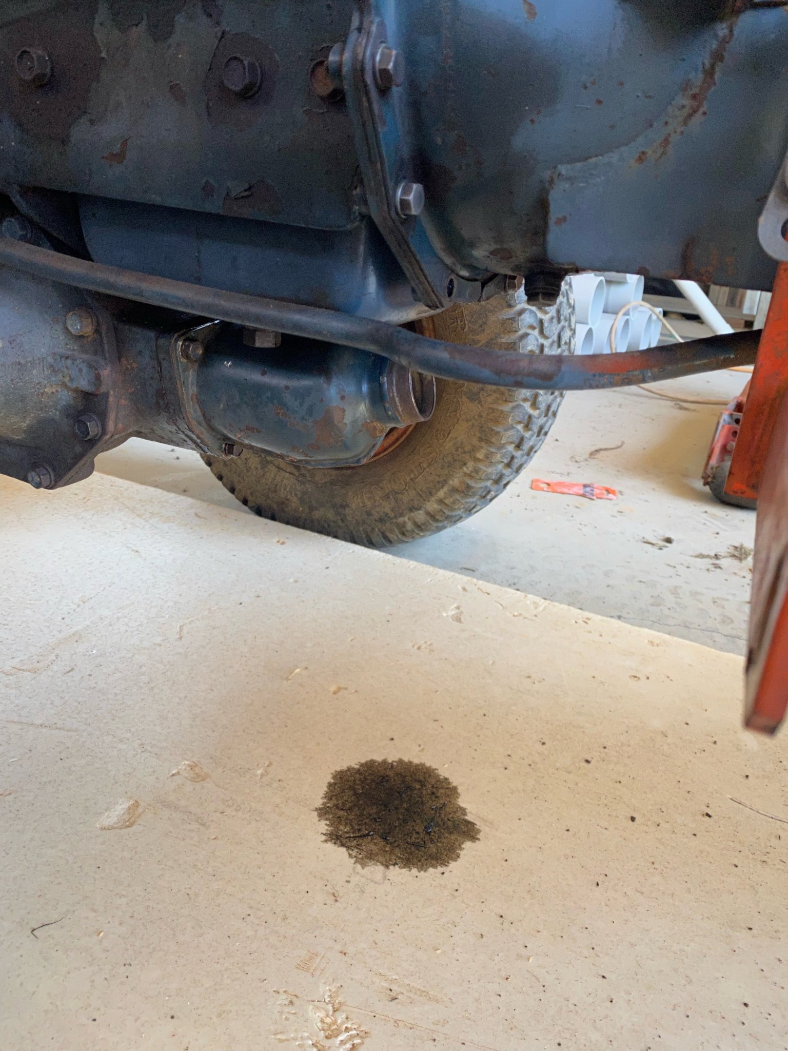

I didnt get to do much with the B7100 today, I did manage to get the oil pressure light working as described in post 33 above.
I cleaned the oil leak area a few days ago and today there is a definite oil leak that seems to be coming fro between the mating surfaces where the missing bolt is. if you zoom in you can see an oil drop under the missing bolt. I am still hoping putting a bolt there will fix the leak.
I also found this rubber boot in the tool kit tunnel, Does anyone know what it is for?
