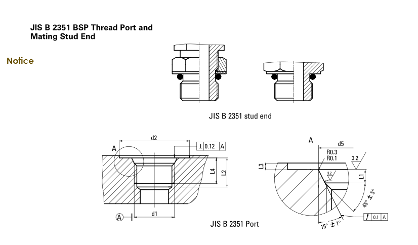

I have one here somewher - I will dig it out. That description seems to indicate it can be used with either a flange or banjo fitting. The Kubota parts book is clearly banjo.
Paranormal you got it covered but better check the threads on that port. "Normal" is a setting on a clothes dryer. Could be metric ORB, BSPP, SAE, ORB or something more obscure. The pump dexcription should say what it is.
The Problem is, it is only mention AS Site from the Ports.

I don't know what the difference is between "JBSP" and "BSPP". The adapter you show in post 36 might be the right thread but seems to have an o-ring. The pump has a flat surface and originally sealed with a flat copper crush washer. It is hard to tell for certain from the picture if the pump outlet also has a bevel to retain an o-ring.
If it does, and if the thread is correct, then that adapter is an elegant solution. Please let us know how it works out.

My German consists of about three words but the use of 1/2" and 3/8" sort of rules out anything metric. My bet would be BSPP rather than a North America standard. The iron washers with bonded rubber are probably for use with BSPP adapters. You can also purchase port adapters with integral elastomeric washers. They are a third style and made specificly for BSPP port applications. Getting it to seal is one thing - getting it to seal reliably is another.

JBSP is just the Japenese version of the BSP standard . (J)BSP has at least three standard ways of sealing parallel threads - a solid (e.g copper) crush washer, a steel washer bonded with an elastomeric inner ring that basically acts like an oring, and a "real" o-ring port - the BSP analog to a SAE orb port.
