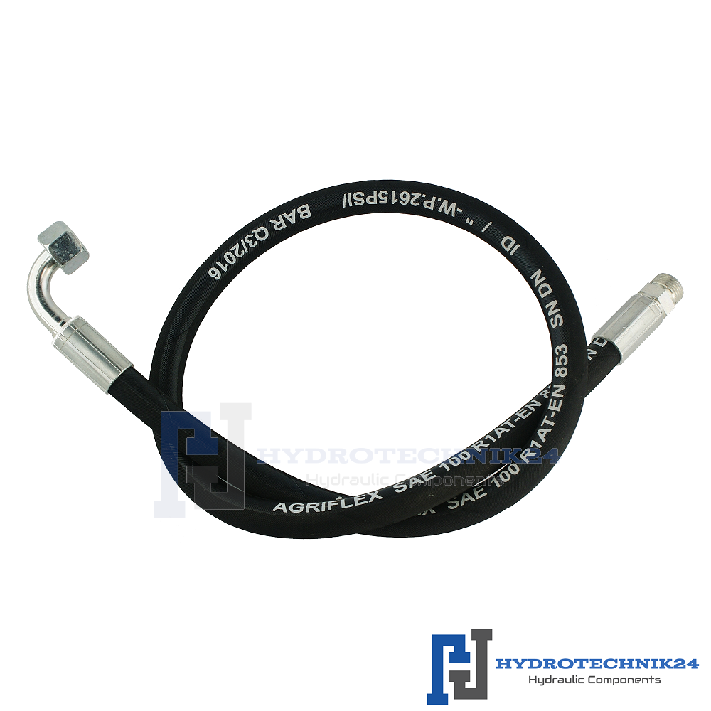

Okay..
Thats i would get the SAE 100 2 layer R1AT 330bar ~4786psi.... It is only 20 Cent per Meter more...
R1AT is a one wire hose. R2AT is a two wire hose. Either will work fine.
I think the corresponding European standards are EN 853 1SN and EN 853 2SN but don't hold me to that.
Not to beat a dead horse but the R16 (EN 857 2SC) and R17 (EN 857 1SC) hoses are much more flexible and in the case of R17 more compact.

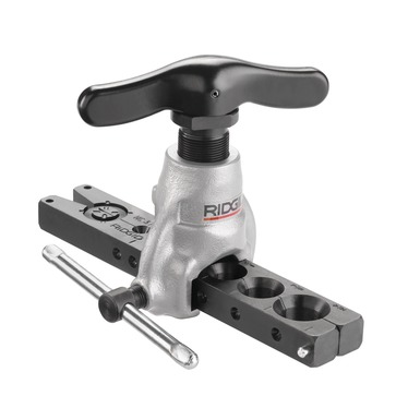

So if he can't find the appropriate banjo connector, he could cut the outlet side of the pump line off before the hydraulic block and use one of those adapters for the line to the 1st control set. Then a second adapter to the 3PH line from the final PB port.
Sounds like a plan, then.
