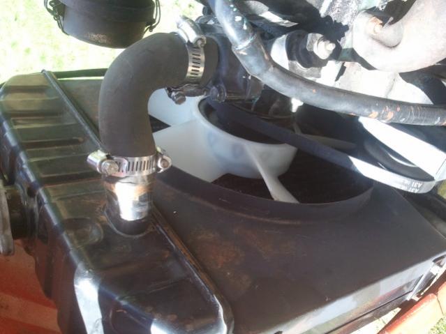

It has a water pump and a alternator both of which I wanted, it just required me to alter the radiator just slightly with a couple of copper fittings to get it to work right.

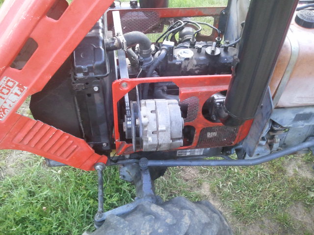

I'm fitting the 125 amp GM alternator to it right now should have it done here shortly. That won't have any problems running the lights, and keeping it charged.

125A alternator is around 2.3 hp to run when fully loaded, so that's a big hit unless you really need the juice.

tmessenger, It's not pulling too hard... In fact I didn't even notice it, but I do suspect the battery is fully charged and the lights didn't pull it down too much.
I got the alternator brackets made, installed, and set up. I will still need to do a little more work on the side shield and the hood, but it will do for now. It's ended up being narrower than I first thought it would be, the loader will fit fine around it.

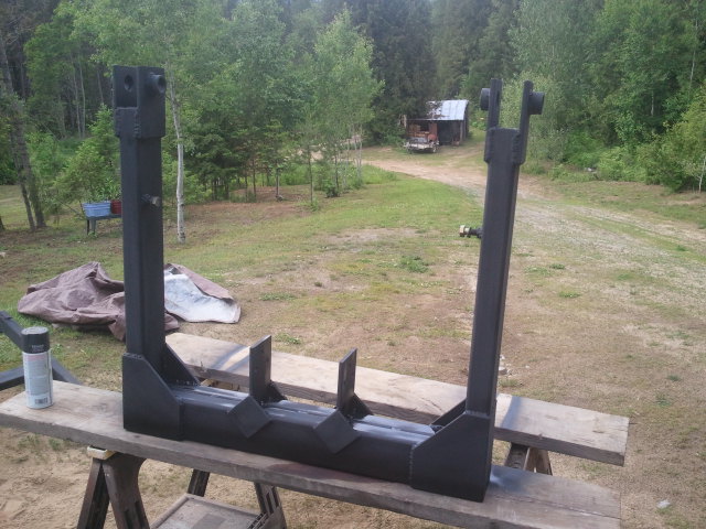

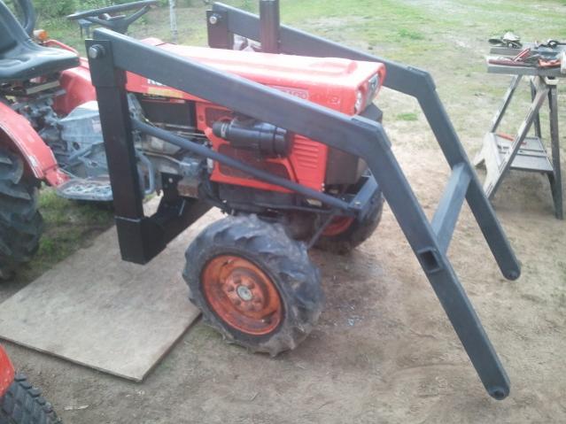

Going like a mad man here the last few days building a loader for our B7100HST.
I looked at 100's of pictures on the internet , made a few sketches of what I wanted and dove in head first.
I wasn't really sure of the size of the steel to use so I went to the heavy side of it, 3/16". I read most use 1/8" and 1 1/2" cylinders or an upgrade with a 1 3/4" cylinders, I'm using 2" so I want to keep the strength.
Well take a look and tell me what you think.:D
These first 5 pic's are just tack welded together for fitting.

Second day's work... Can't wait till it gets all done so it can help me build a shop so I can quit working outside in the dirt.;)
Now that all the frame work is done and I've figured out the length of the cylinders I'll have to wait for them to show up to get more done.
I tried to find a bucket to no avail so I'll have to start making one of those too.
I'm also making a grapple bucket for this too so I can pick up brush with it.
I have the single handle loader control and will be using a push button 3rd control for the grapple.
If the weight of the loader and bucket make it hard to steer I'm thinking of going with a completely hydraulic steering unit, No more steering box or linkage. I have the unit here just hanging around not doing anything.:p
Here I've pulled the frame all off the tractor and welded all of it together with all of the supports and reinforcements, then reinstalled all of it.
I was worried that it wouldn't line up when it was all done, but it ended up being within a 1/8 of an inch so I'm happy with it.
When the cylinders get here I'll put the rest of the supports on the loader arms. :cool:

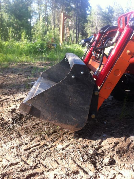

I've noticed one thing that may be a glaring error. The bucket position appears too far forward. You may need to try to bring the bucket closer to the front of the tractor for better stability & balance.
I recently bought a damaged bucket that I believe was from Massey, Mahindra, or a Branson. In any case, I got it for $50. I hired a fabricator to modify the bucket brackets and install new lower cylinders from Surplus since one of the original cylinders had a damaged rid which required an expensive custom repair or a replacement. Because the original setup of the B217 had limited range of the bucket and no upward curl at ground level, I decided to redesign it correctly.
And the desired result which I'm very pleased with...
This is a 1 3/4" cylinder and it worked beautifully. You can take what it's worth from the info given.

How and where does the loader attach to the tractor? Will your loader have a sub frame to transmit forces back to the rear axle? I have only seen the U shaped piece that looks like it will bolt near the center of the tractor. The Kubota sub-frames go from the rear axle all the way to the side of the engine block.
