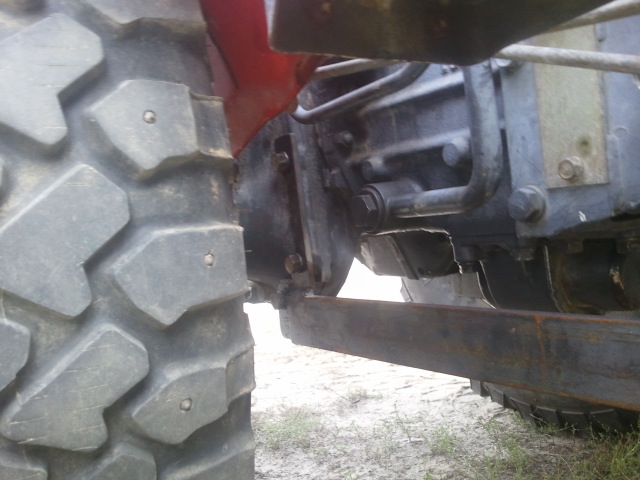

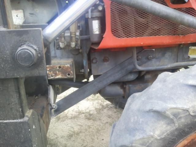

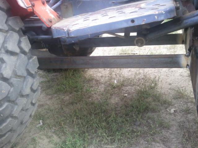

I finished adding to the sub-frame, without these the main mounting bolt were getting worked a little.
With the rest of the supports in place it doesn't move at all!:D

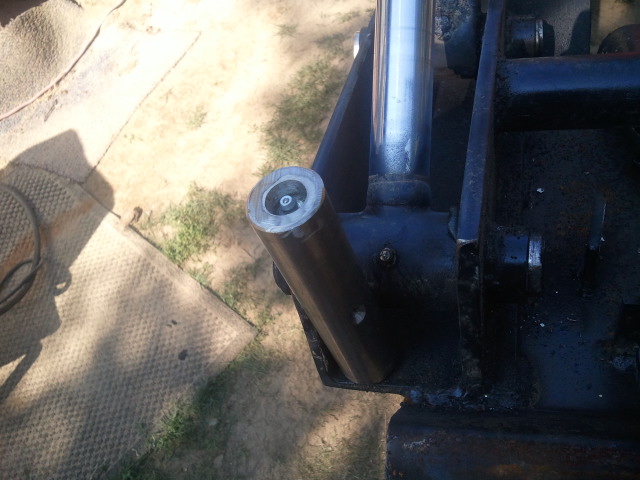

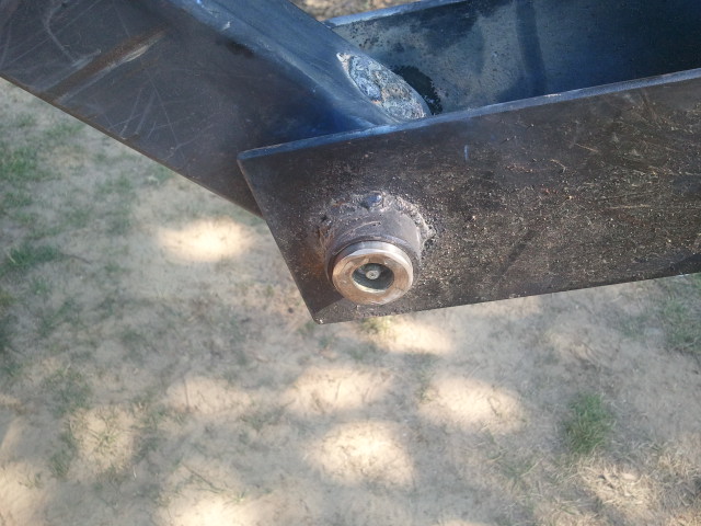

I wasn't happy about the grease zerk fitting location on the 2 front pins on the loader arm, so I ended up making grease pins instead, much better way to do it!
Looks like that will also take some strain off the belhousing connection which is a good thing. Pretty sure all the factory subframes reinforce that area ,i think my 8200's subframe goes all the way to the rear end housing.
Nice job on the pins, thats a lot of drilling.

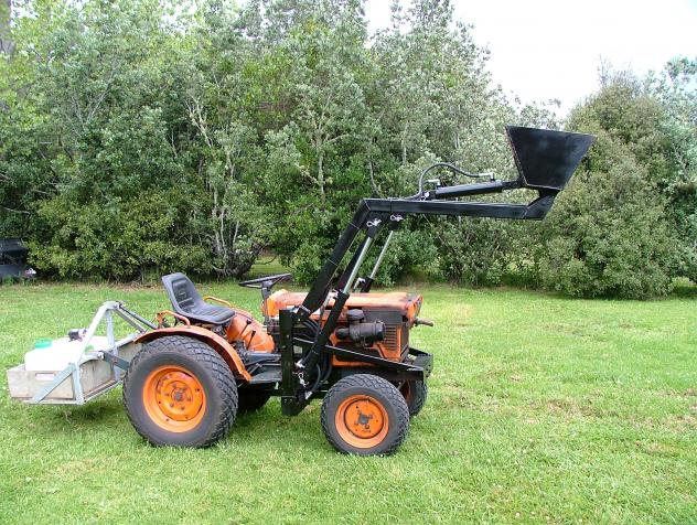

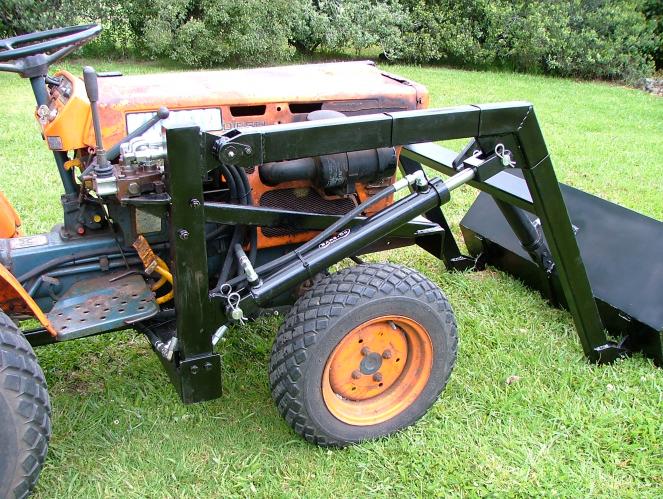

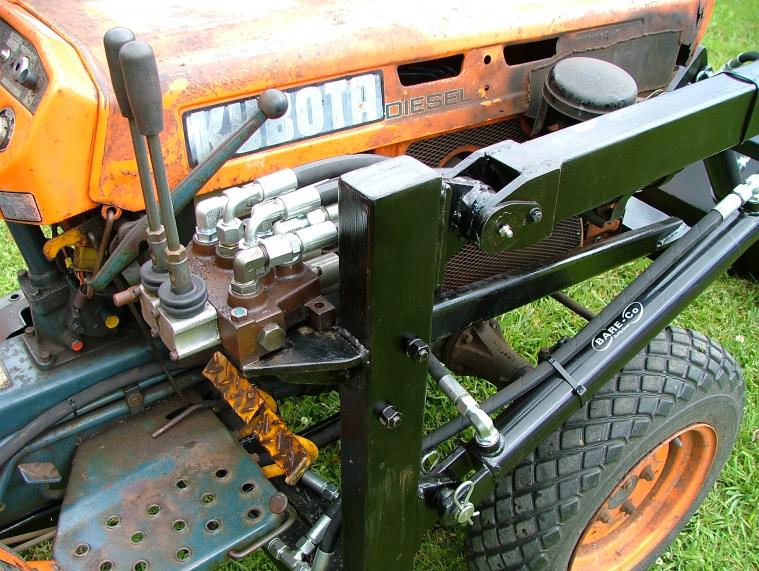

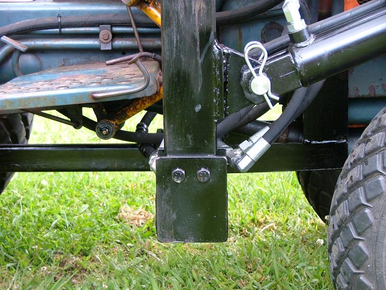

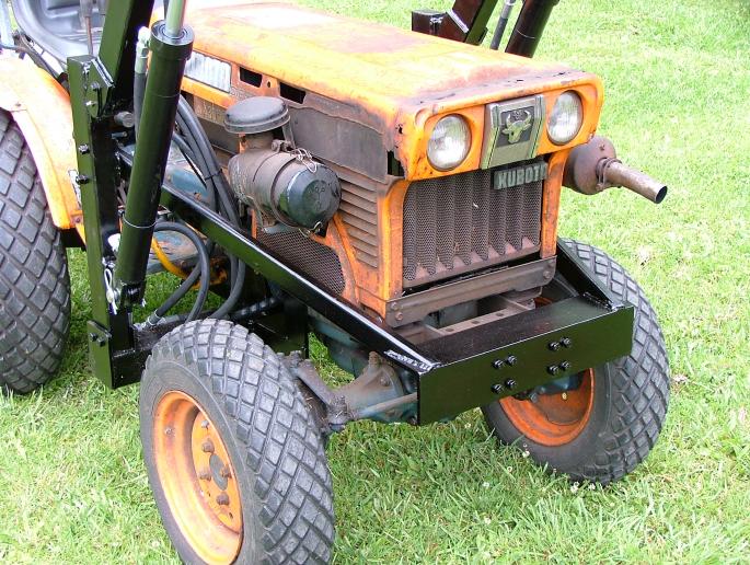

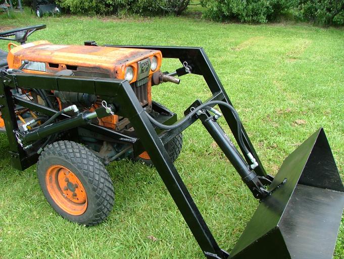

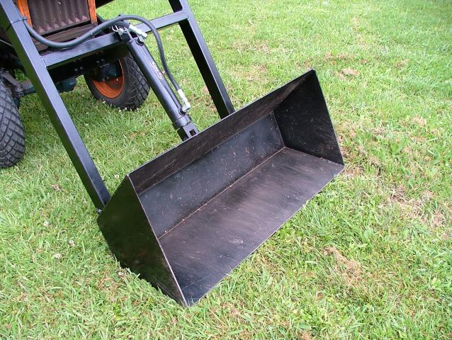

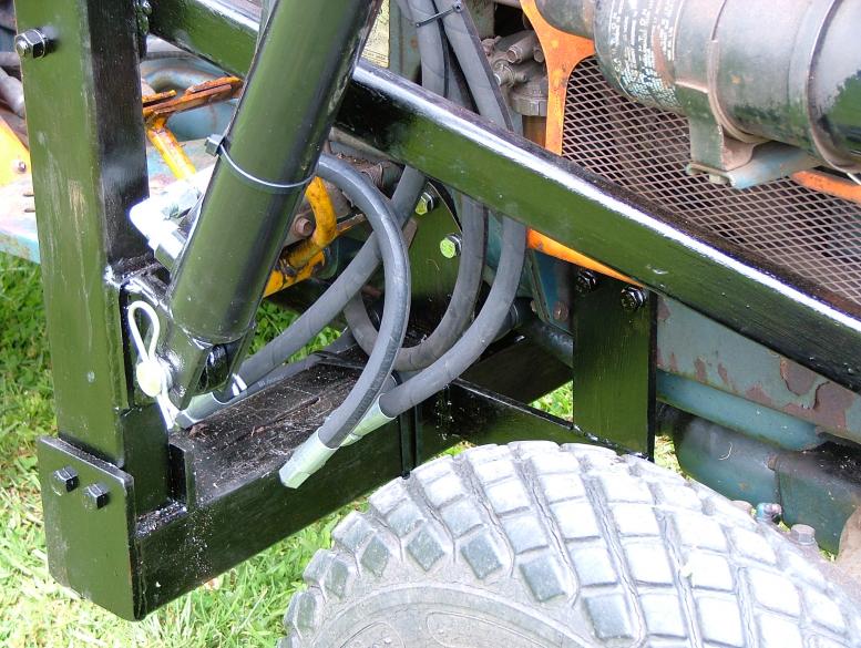

Wolfman, I have finished my FEL on the old B7100 manual, and it works well. I would post photos, but this site rejects anything big enough to actually see, so I'm a bit baffled about that.
The cross frame bolts to the front trio of bolt-holes on the transmission case which were probably intended for a belly mower mount. There's an ear each side going forward to bolt to the lower pair of aft bolts on the front suspension bracket, and another longish bracket going aft to bolt up under the rear diff. So the weight and twisting moments are taken on three points as widely separated as seemed practicable.
The two uprights of the frame are bolted to the ends of the cross frame, and there is a pair of forward braces from part-way up the uprights going to a bit of 100 x 100 angle bolted to the front of the front suspension bracket. The whole thing's probably overkill, but it's not likely to either fall apart or damage the tractor.
The hydraulics work well, using the existing pump and taking the feed as I said in a previous post, off the outlet under the seat.
Later: Have uploaded photos – see next page.

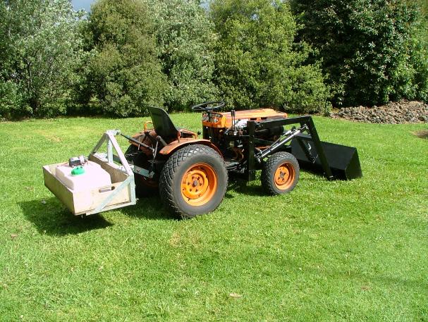

OK, here are some pictures. Please excuse the rust on the engine cover - all Kubotas tend to have this problem, I'm told, and as it's not structural and a replacement cover is ridiculously expensive, I'm putting up with the holes.
The steering was very heavy with the extra weight on the front, so I have increased the tyre pressure from 14psi to 20, and put the 50-litre spray tank full of water on the 3-point at the back. This has made a world of difference.

Great job,
You could have probably saved some money with smaller hoses.

The hoses are 3/8", which is common in these parts. I had a professional in to do them, by the way. I don't have the gear to swage the end fittings. I haven't had the bill yet, and I'm not looking forward to it!
The hood has been weld-repaired by some previous owner. I did wonder about glassing and spraying it, but the tractor is a tool and not an art object, and as a pensioner I need to be a bit careful not to spend on inessentials.
