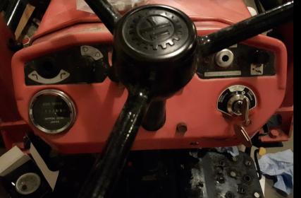

I'm wanting to install a temperature gauge on my '80 B7100.
I've bought the in-line fitting to attach an analog gauge to the rad. hose.
Is there anyone out there that has installed a 2" gauge in the dash panel somehow?
I've attached a photo of the dash on my unit.
I'd like to install in the dash (maybe beside the hour meter) to keep it looking factory, but am open to any suggestions others may have.
There is some sort of "heat sink looking" piece behind the dash, beside the hour meter, but maybe this could be re-located?
Thanks in advance for the advice.
I added both an oil pressure gauge and a temp gauge. My hourmeter was bad, so I yanked it and added an oil gauge to that opening. Who needs to constantly monitor the hourmeter anyway. I just use it for my maintenance schedule. I installed a new one (different style) under the hood instead. I ended up adding a temperature gauge, but I installed it to the left side of the dash (hangs off the side), while seated on the tractor.

I thought I would finish up this by posting about the solution that seems to be working for me. I bought a Bosch mechanical gauge ($25), and a 34 mm radiator hose T with a 1/8 npt fitting. Had to tap out the T to accommodate a 3/8 npt fitting (pipe thread - minimum for a mechanical probe).
Installed the gauge in the existing hour meter spot, running the cable along the intake side of the engine. Needle vibrates a good bit under running, can jump around some, and records temps at idle at about 215 degrees, and run full out at from 220 - 225. Gets awful close to that 230 mark, though.
