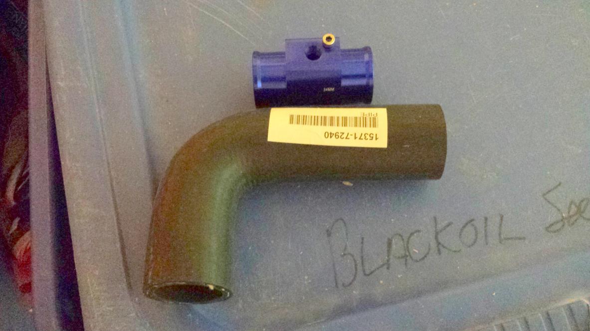

I think I'm going to go with this and get rid of this mess.

for the cost of the hose and adapter..... that flame might end up hurting the ol pocket book! New radiator vs the hose.......mmmm.......
I'll let you know how the hose turns out in a few !:)

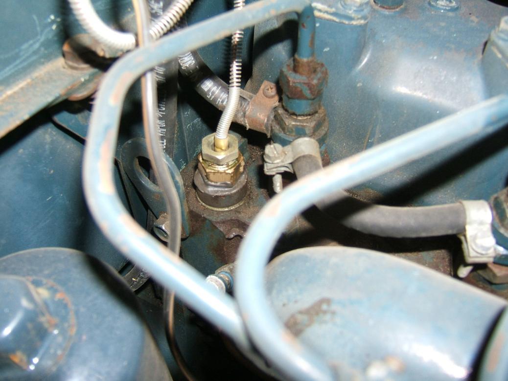

Othumpa, is that where the freeze plug is? I wonder if that is a good place to have it... I would think in the 7100 with the open symphonic system, the hottest reading would be near the top of the motor or radiator...:confused: But you guys know more about these tractors than I do, that's just my thinking in it...
The more I look at that pic it looks to be near the top of the motor. I'll take a look at mine tomorrow and see if I can make that work with a bushing. I'm guessing you used JB because it is metric threads?
14,240
6,415
85Hokie, you sure this is correct size, "34mm! you pick your color!"
I'm almost positive the hose is 1 1/4" ID. which is 32MM.
Olthumpa, on the old L series, at least on my L305, the tapped hole in the head is 16mm x 1.5 thd.
I replaced the old factory electric unit with a mechanical. I bought the fitting at O'Reilly Auto. It was in a bag with 4 other fittings, over near where they sell the gauges. Price was like $9 for the bag.
