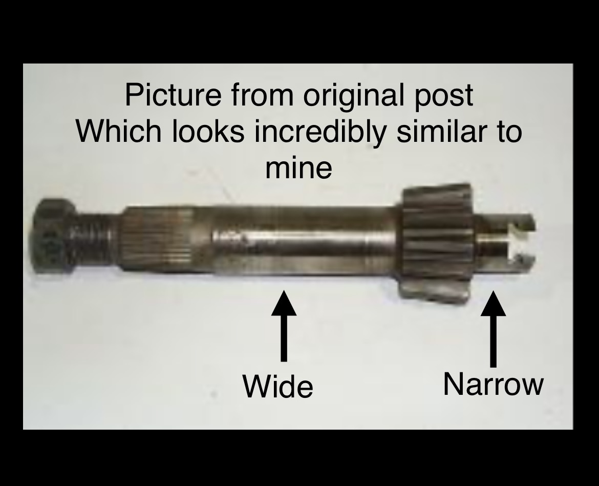

Ok we'll back up a little:
First: The chances of the OP coming back on here is slim to none, as this thread is 10 years old.
Second: I'm not seeing anywhere where he states the dimensions?
Third: He also states that the shaft is the one I posted:
I'm looking at the pic and I'm not seeing a difference in the shaft ends, I'm also not seeing it on yours.
Yea the center is fatter but that surface simply does not matter as long as the bearing surfaces are the same then it will work.
Give me the tractors serial number and maybe there is some variable there that we do not see.
Also if you would give me the measurement of your shaft just like they did in this picture:

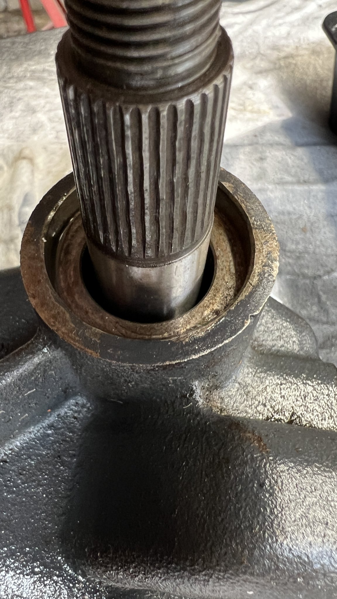

I was hopeful the user kubotasam would see my post as under his profile it said he was last active yesterday. But as I’m new to this type of forum then maybe I’m wrong.
it’s very late here but I’ll post more pics tomorrow to try and explain better. In my steering box the shaft behind the splines does not sit in a bearing, it sits in the metal casting of the steering box with an oil seal on the outside. (I’ve attached a pic that I happen to have on my phone, I’ll get better ones tomorrow). Therefore the diameter of the shaft needs to be the same as the opening or it will move and break, and one in the pic you posted which is the same as the replacement I have doesn’t fit, it’s too small. I’ve literally put it in the steering box and it won’t work. I wish it would as I currently have a very immobile tractor that I need to use.
(just an edit to say that you have given me an idea that I could replace the oil seal with a bearing which may solve my problem. )

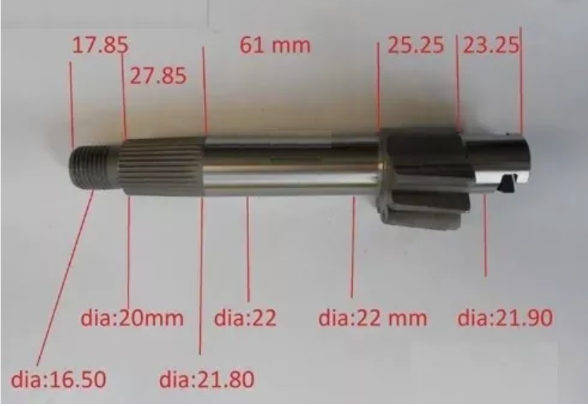

I think we might be getting to the bottom of this.
Some EU units are not the same as the USA units, hence why there might be some confusion.
Or yes it could be very possible that someone has swapped parts around, and that does make it very difficult to find the right parts.
Try comparing dimensions on these:

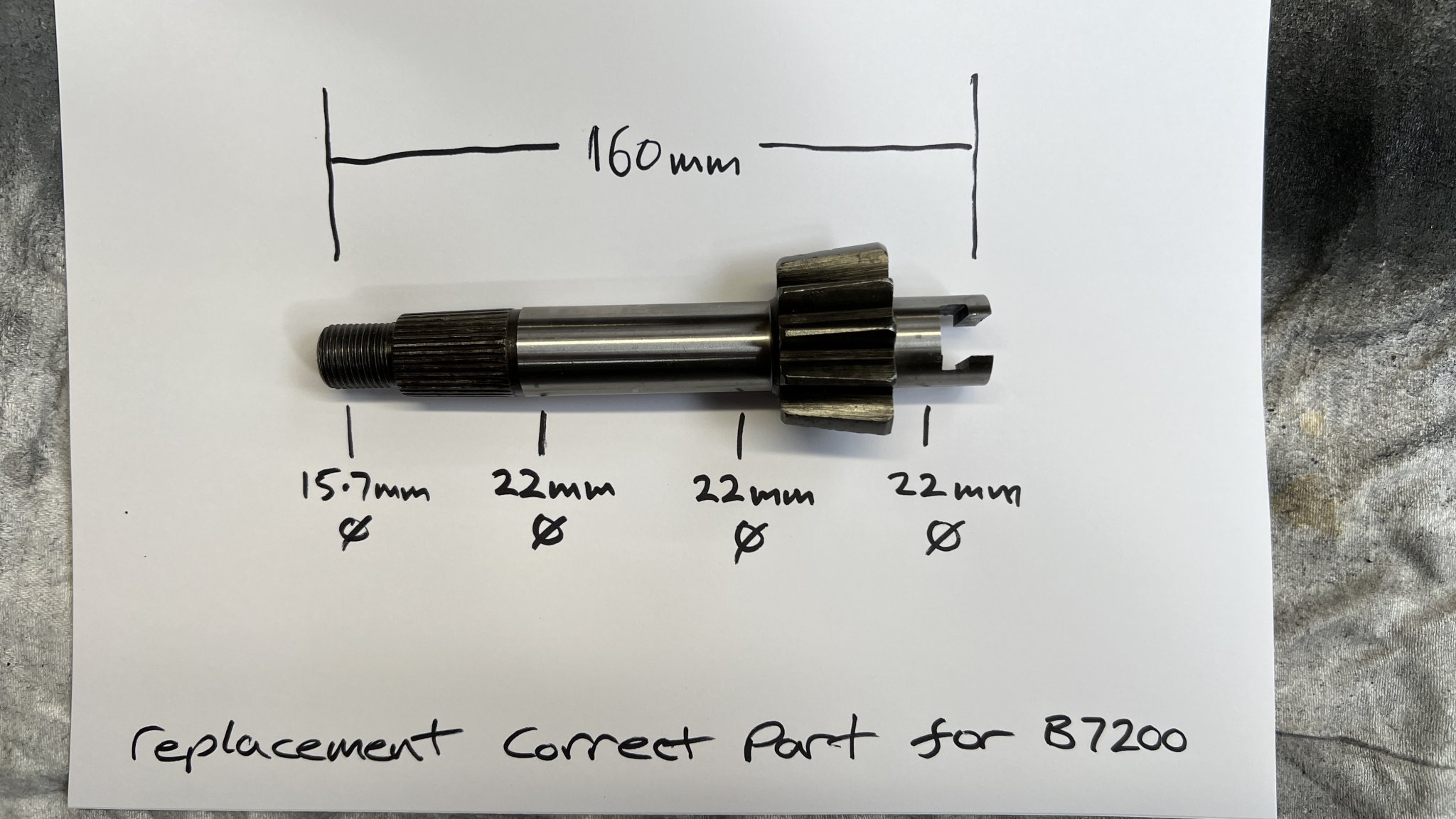

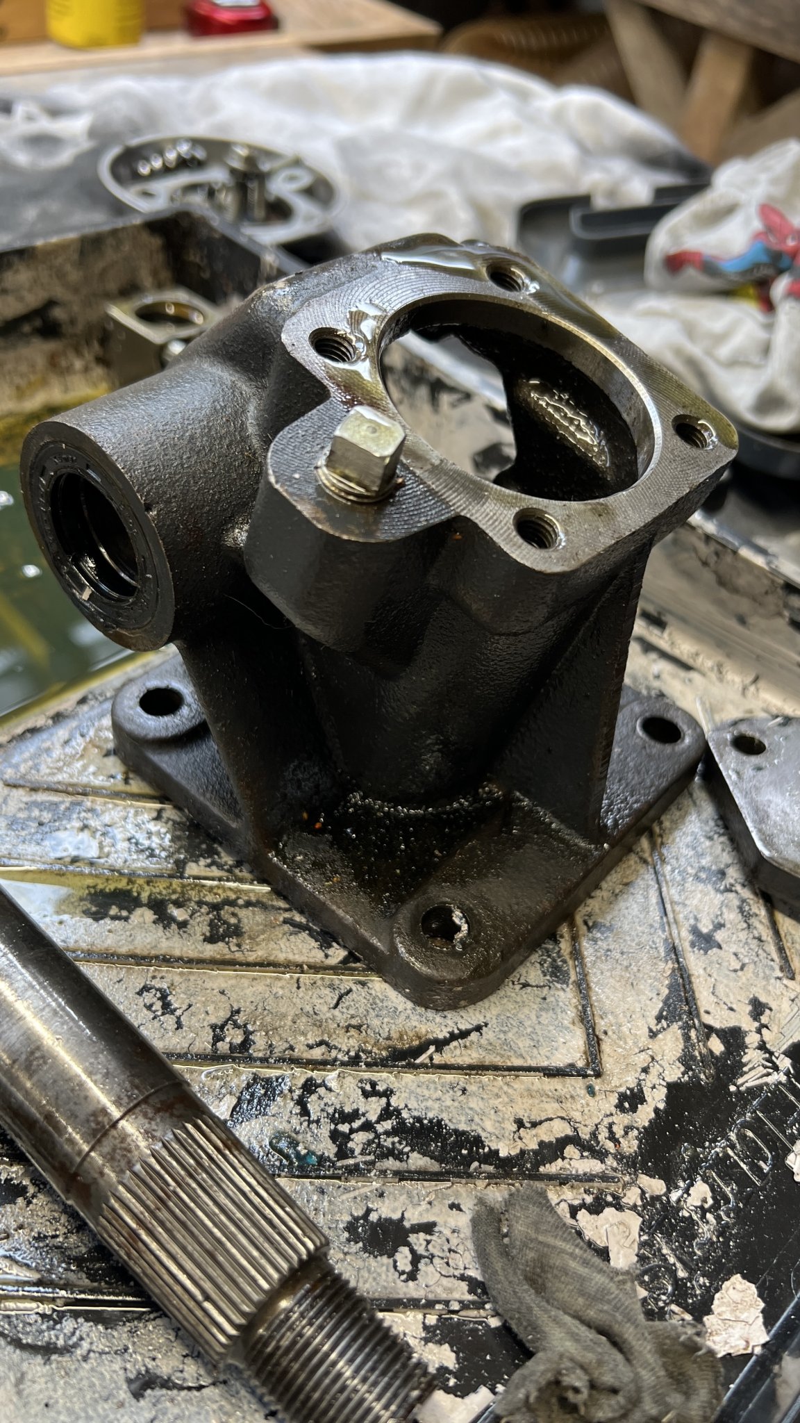

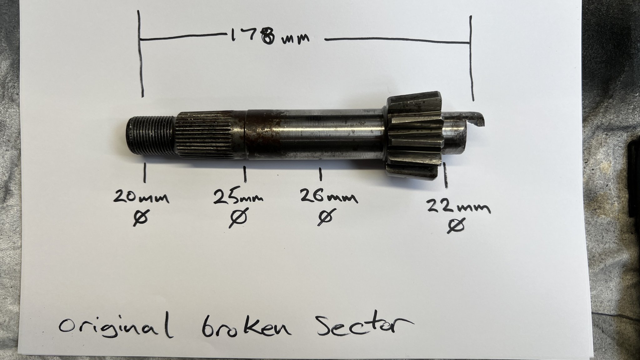

Ok, I’ve attached some pics of the old broken sector and the correct replacement which doesn’t fit, along with a pic of the replacement in the steering box. You can see a gap around it in the housing. It may be possible to get a bearing of the correct size to replace the oil seal and hold the smaller shaft but this then gives me the problem of the new sector being too small for the pitman arm. The serial number is B7200D61121. I hope all this helps and makes sense as it’s driving me insane.
thanks again for everyone’s help with this.
edited to add the teeth on both the old broken sector and the new replacement are exactly the dimensions.

Russell, the OP had a B7100, Kubotasam put up a picture that @MrRedfive thinks looks like the sector shaft he needs.
The B7100 and the B7200 took the same sector shaft.
Now to complicate the issue further, his B7200 is in EU, and the serial number does not come up as a B7200, it comes up to a B8200.
His steering gear case does not match a B7200 or a B8200.
It's possible that someone has changed the steering gear to some unknown case.
