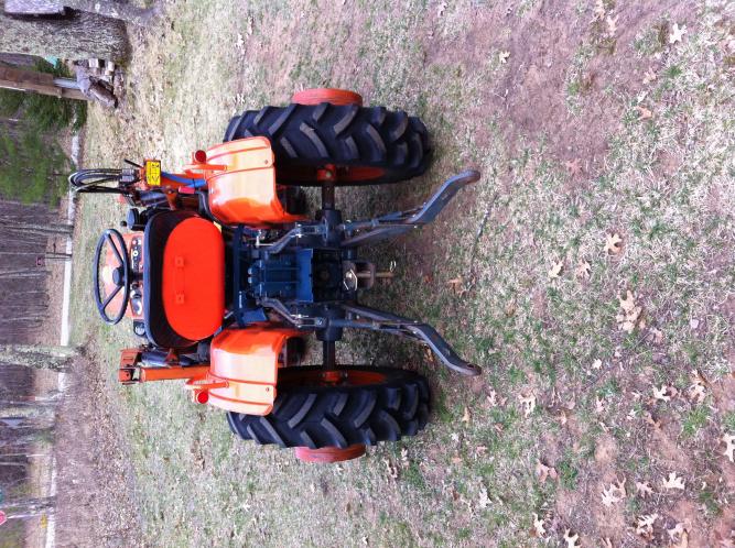

I recently got my paws on another B7100 seat pan, (1st pic) and in my never ending quest to make my tractor better/prettier, I ordered a new seat cover. Imagine my surprise to find it does not come with padding. All the parts houses I called say there is no padding available, no part number, & it doesn't show on any parts lists.
The seat pan I got had well-rotted, random pieces of foam & carpet padding glued to it. (completely unusable)

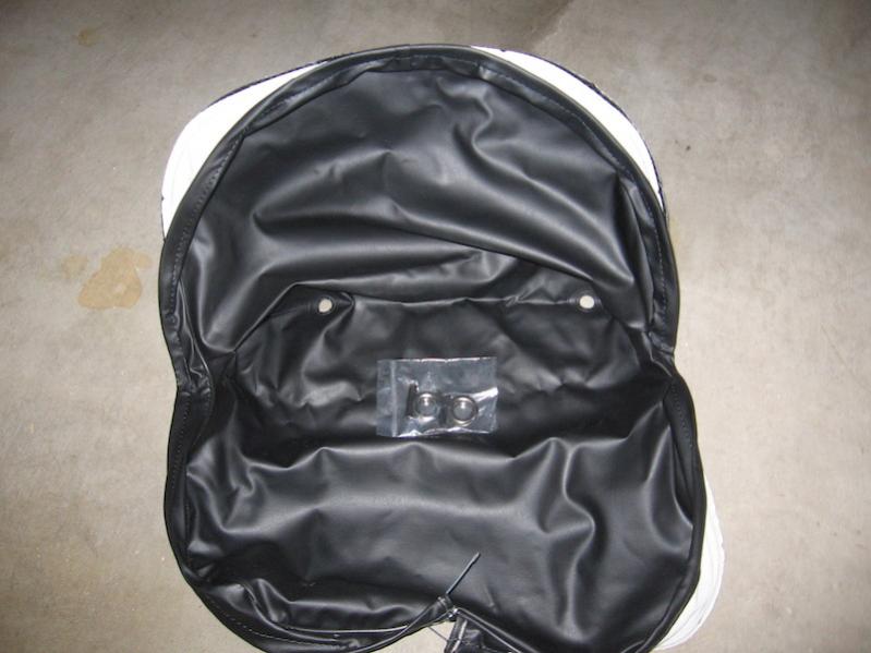

My current seat cover (2nd pic) is somewhat different from the factory one, (no grommets, aftermarket?) and is heavily padded, 1.5" to 2".

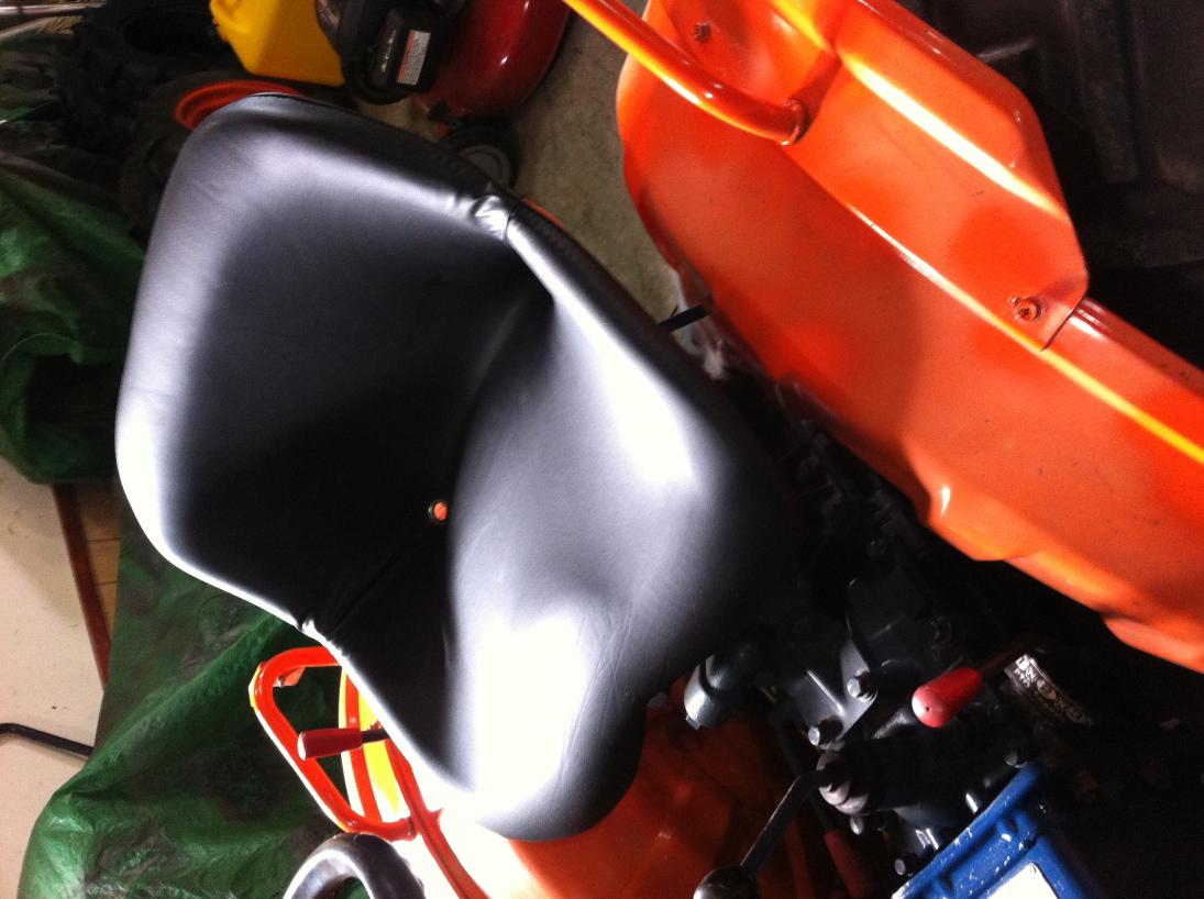

3rd & 4th pic is the new seat cover.
