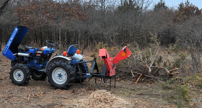

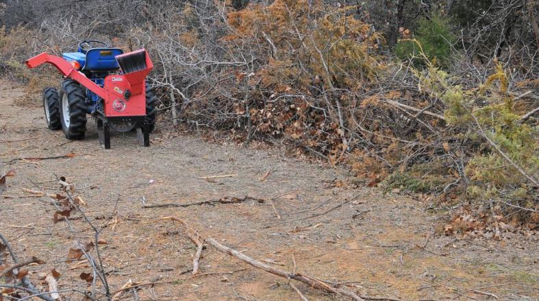

Of course, all this advice is excellent and should absolutely be heeded. But also, these things are not often the binary decision we make them out to be.
I've put a ton of carefully crafted time on a (theoretical) 4" capacity DR chipper that was well oversized for my little Ford 1200 tractor with an earth-shaking 13 PTO hp. What was equally important is that I also wasn't running the chipper to its full capacity. I just needed to mulch up a bunch of cedar and oak tree limbs, most less than 2 inches. Plus, the feed rate into the chipper also matters a great deal. To talk in extremes, if you go excruciatingly slow, the tractor won't know if you are chipping a big piece of wood or small because it's only taking a bite of whatever you give it. With a chipper, a lot can be accomplished by managing inertia of the chipping wheel. That little tractor is still going strong even though it has to watch the Kubota get all the 'big' jobs.
14,365
6,628
Sgt, do you put the limbs in that orange chute, or up there where it says FORD on the side? It looks confusing.:D:D

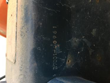

Not sure what to tell you D2. Here is a pic of my serial number. A B7001 is a grey market tractor from everything that I’ve read and been told. I’m not here to argue with anyone. Y’alls are the experts. I’m just trying to use my great little tractor to it’s full potential. I’ve taken my tractor to the local authorized Kubota dealer and they’ve worked on it without question.
Btw.. the PTO chipper that I was interested in sold for more that I was looking to spend. So it’s back to the drawing board for me. Buy another standalone chipper or wait for a small PTO chipper that I can make it work with my lil tractor.
Thanks and Cheers
Z
Your own statement of your personal experience confirms you DO NOT have a grey market tractor. A Kubota dealer will not work on a Grey Market tractor!
