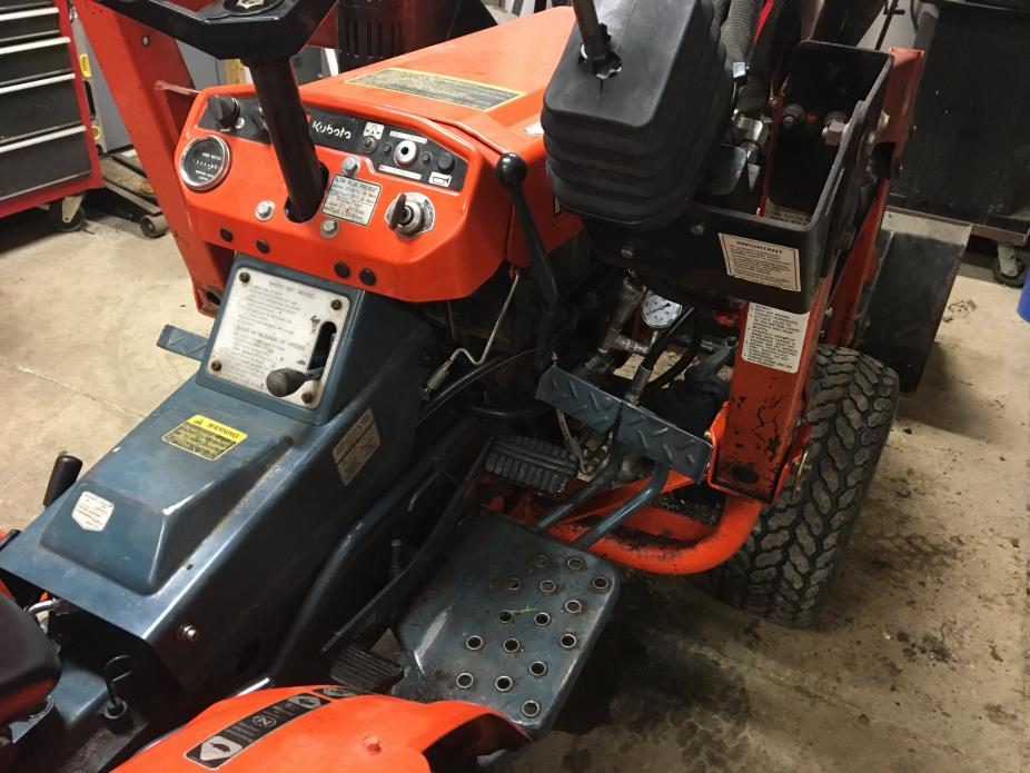

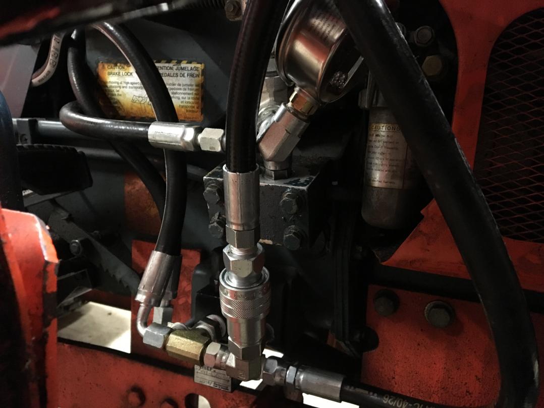

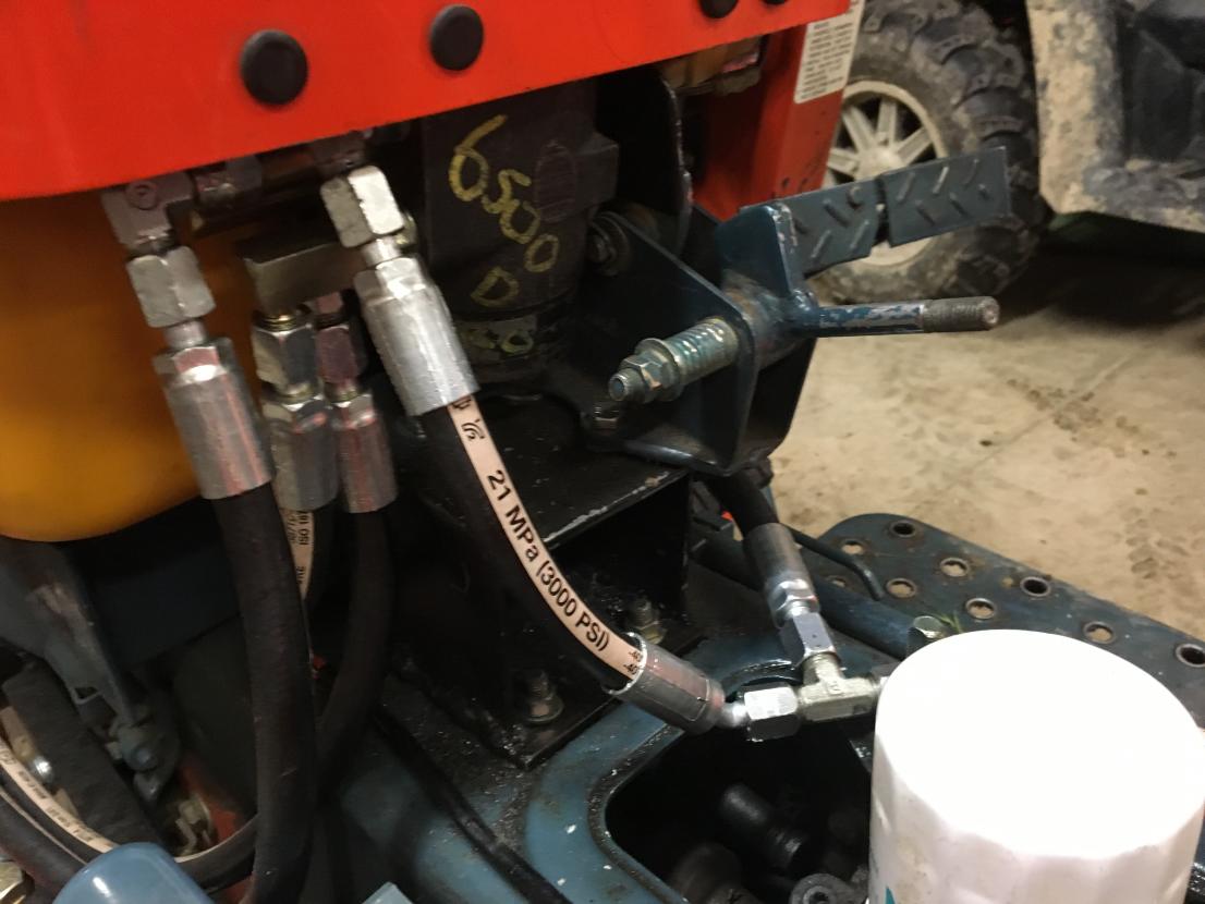

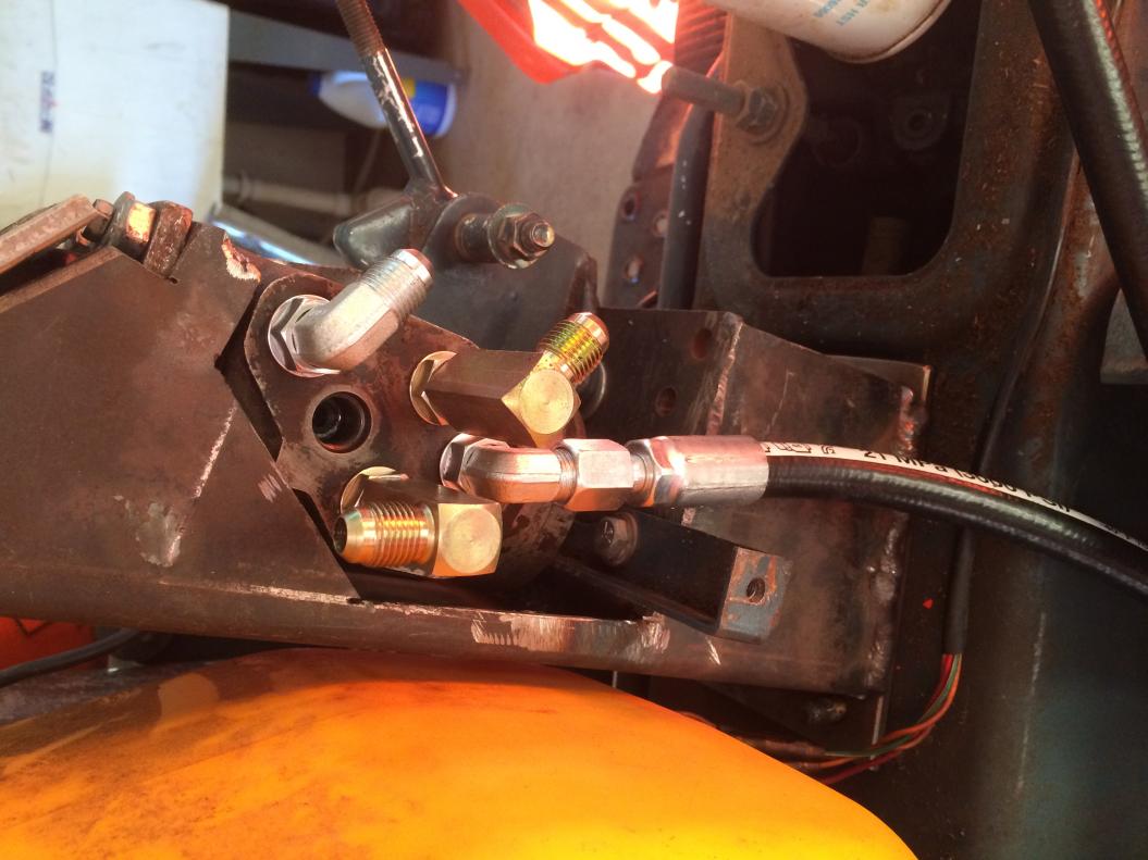

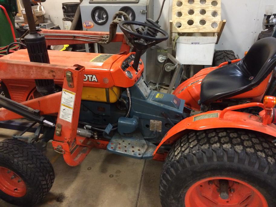

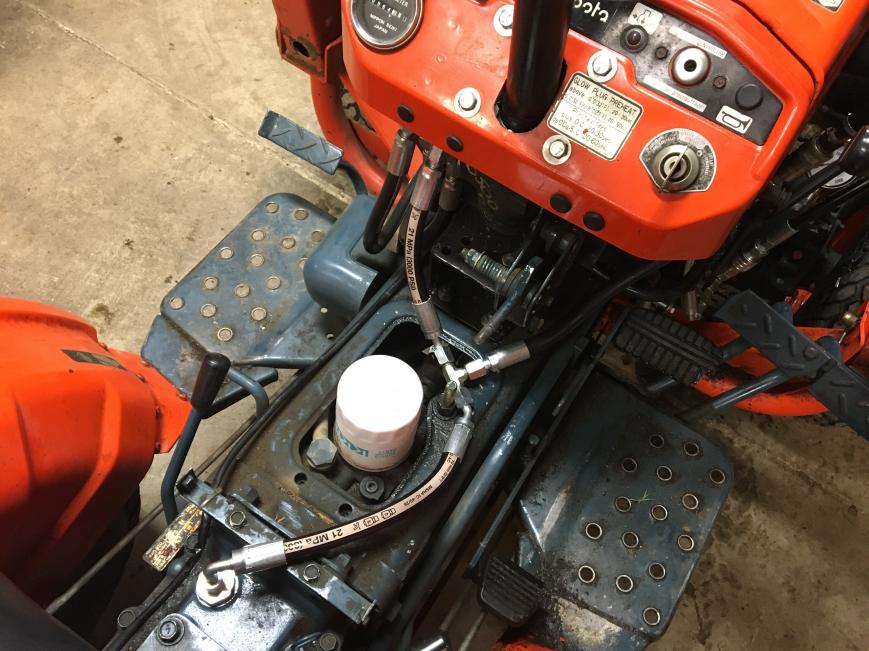

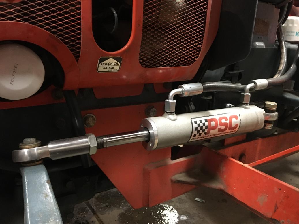

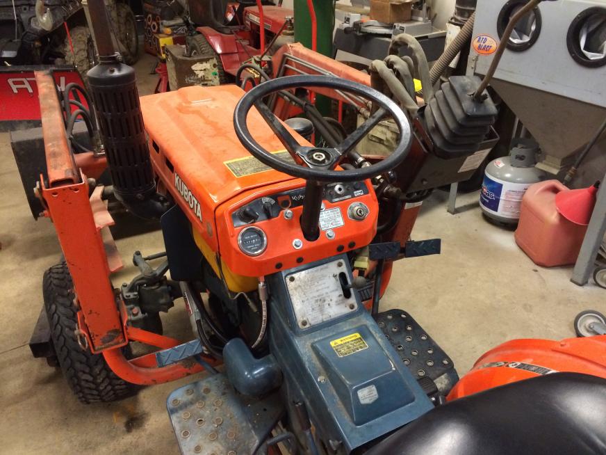

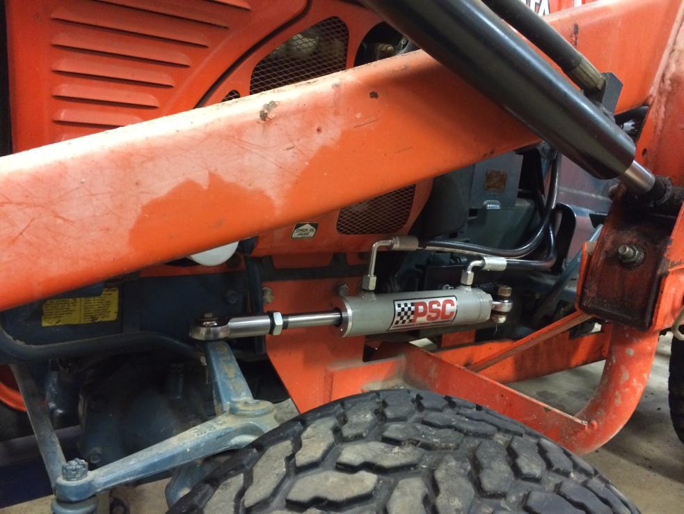

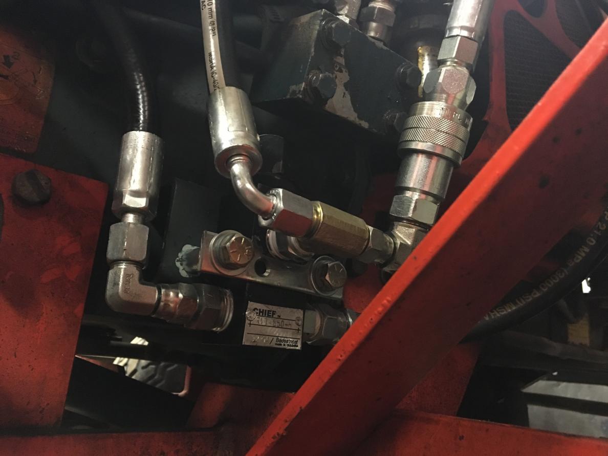

So, I'm a new member here, but I have learned a lot from this board over the last few months and for that, I thank you all. I recently finished my project of adding power steering to a 1995 vintage B7100 and thought I would share some pics.
I'm not a fabricator and some of this isn't very pretty. However, it did clean up in the bead blaster and looks better with a coat of paint on it. Most importantly, it works. I can get more pics and provide more detail if anyone wants them.
Let me know what you think.

Welcome, and nice work! That's a clean install.

Thank you all. I will try to get some better pics of the finished product. I didn't keep track of the cost as I didn't want to know how much I spent (and I threw away all the receipts). But, if I had to pull from memory, it would look like this:
-Orbital valve, column,- about 100.00 shipped off ebay
-cylinder - Decided to buy new because I new it would work, had threaded ends, and all mounting hardware including brackets - about 175.00 shipped
-Hoses for cylinder and a few fittings - 65.00 from local shop (all Parker)
-Few more fittings - about 30 bucks
-Final three hoses for In, Out, and PB (and a few more fittings) - 200.00
Made the mistake of going directly to the Parker store for this round
-Had the wheel laying around
-all brackets made from scrap steel already on hand
I probably have close to 50 or 60 bucks in fittings that I didn't need and will be returning.
So, total came in somewhere just shy of 500 bucks and a weeks worth of my time (not including the MONTHS of planning it all in my head). Most of my hoses have 90 degree ends on them which REALLY drive the cost of hoses up. I could have saved close to 100 bucks if I had re-used some old fittings, used pipe thread fittings instead of JIC, and bought all hoses from local shop instead of the Parker store. I just wanted to limit the number of connections (fittings) I had in the system. I still want to replace the old hoses from the FEL and connect using the PB port from the FEL instead of the "out". Next is to rebuild the FEL valve and one lift cylinder because they leak.

Nice work!!! Where did you tap in for the hydraulic supply?

Update......
Sorry I've been away from the board for a while. I have been tweaking my setup for a while as I ran into some issues and finally got it all corrected last night.

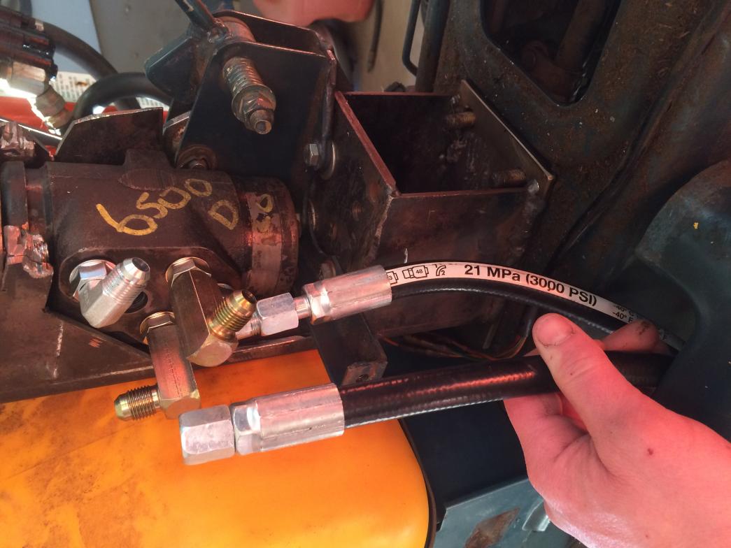

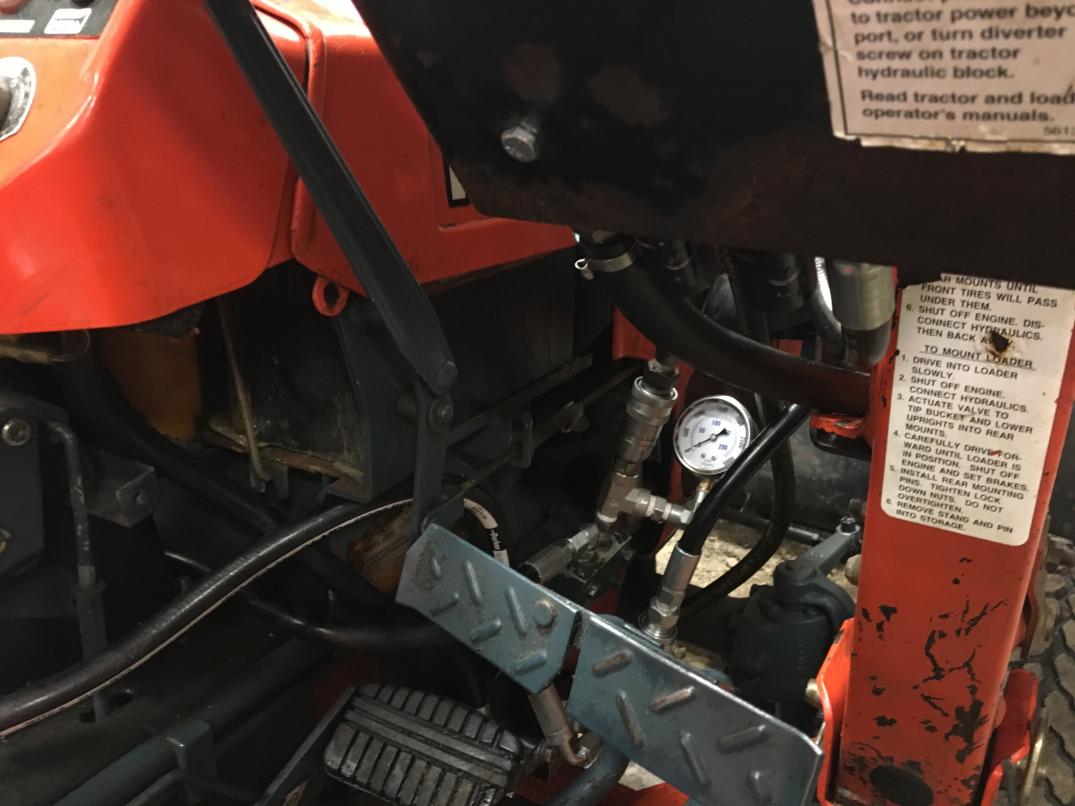

I was wrong to assume the steering control unit had an internal relief valve, it does NOT. Therefore, when the cylinder bottoms out, the steering valve would continue to build pressure. Since there was no relief, this turned into back pressure against the loader valve. One turn too sharp and the pressure blew a crack in the casting of the loader valve.
Well, I tried to have it welded, but it just didn't work so I sourced a new valve body, reassembled it, and put it all back together.

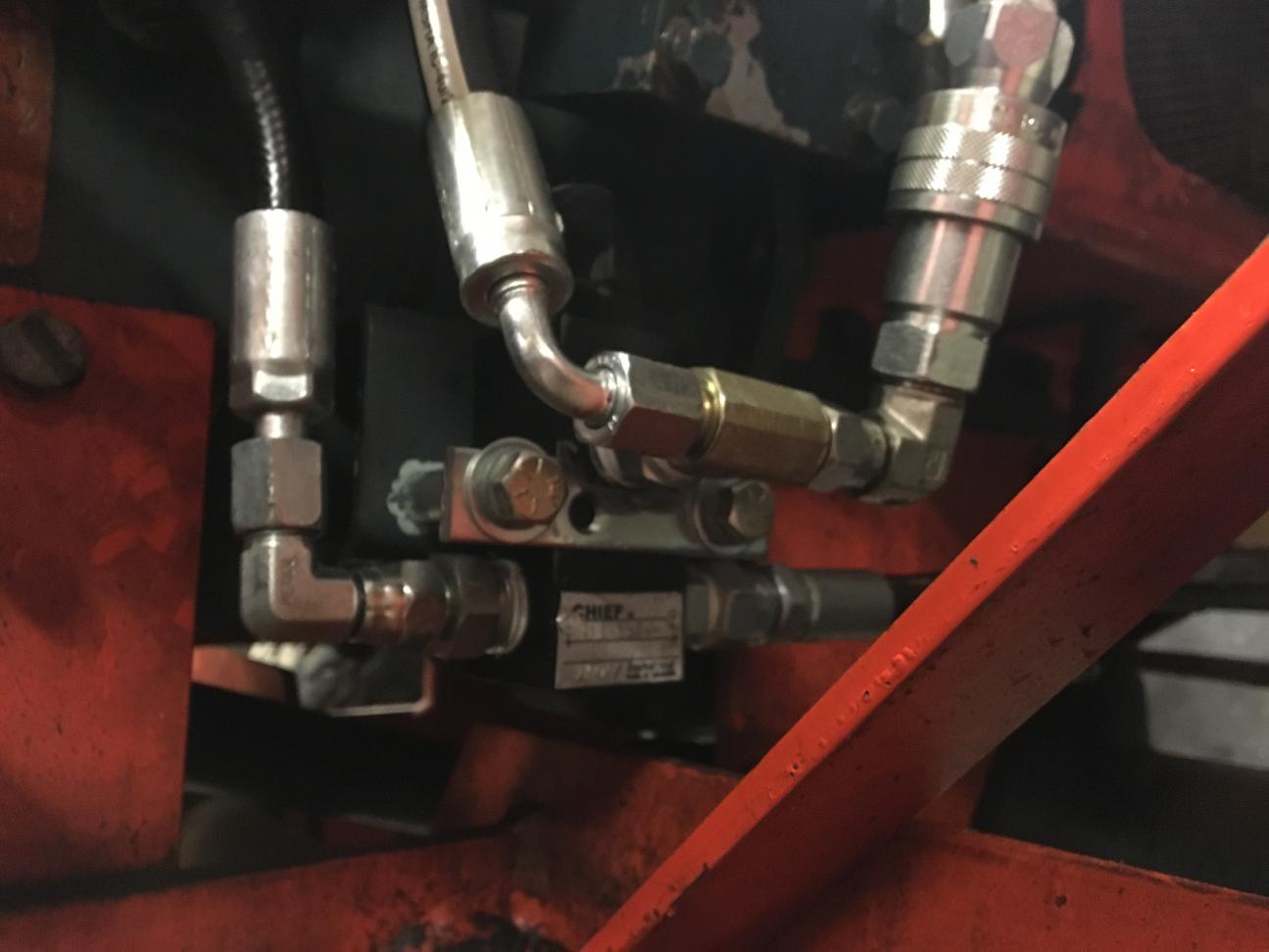

Except this time, I installed an external relief valve in line with the pressure line to the steering valve. I also installed a gauge to make sure the relief was adjusted properly. Now, everything works perfectly and the steering stops when the cylinder is fully extended or retracted (like it should)
SO....My final plumbing goes like this:
from diverter block on tractor to FEL valve
from FEL valve power beyond to steering valve (via relief valve)
from steering valve power beyond to diverter block
and then back to the 3 point like from the factory.
I have the FEL, steering, and relief all returning to the tank via the fill port in front of the seat.
I used quick couplers on the FEL valve so I can still remove it. I simply disconnect the tank line (line stays with loader, just the coupler end on the tractor), disconnect the pressure line from diverter block (again, hose stays with loader), disconnect the power beyond line from the FEL valve and attach it to the pressure side of the diverter block. Not sure if you followed that, but it's really pretty simple.
Anyway, enjoy some new pics. Let me know if you have any questions, I'm happy to help. I may even entertain putting a kit together for this as everything is "bolt on". Let me know if you think anyone would be interested.
