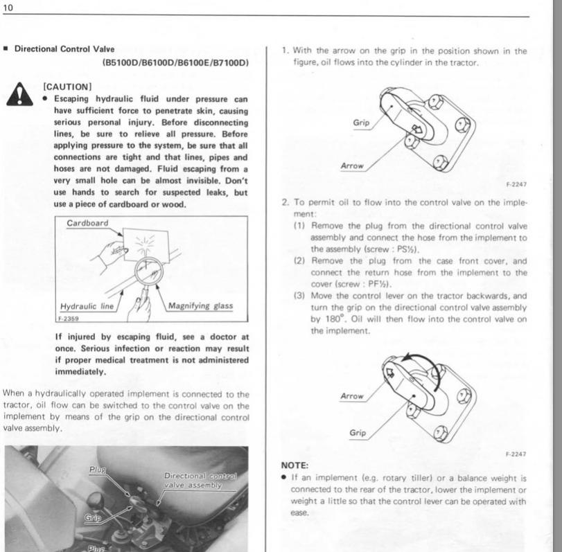

How about the positioning of the directional control valve under the front of the seat? If it's wrong it can deadhead the pump.
The "lever" shown in the diagram is apparently missing on my tractor. There is a stem with a pin through it that is turned cross-wise to the orientation of the fitting or the lever shown in the diagram?? Looks like the stem should be turned to the right; will check.

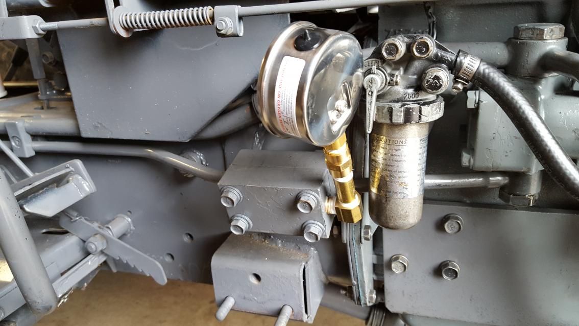

After looking at the repair manual numerous times to determine how to check the hydraulic relief pressure, I finally decided the poor picture is showing the pressure gauge attached at the banjo fitting where the high pressure line connects beneath the seat coming from the pump mounted on the engine. The manual calls for a special adapter and that makes sense you would need something special to measure pressure at that location. I followed the high pressure line back to the pump and found my tractor has an apparent accessory block in line. There is a 1/4 plug that I was able to remove and install the gauge at that location (see picture).
I started the tractor and let it run at a fast idle and watched the gauge. The manual says to let it warm up a little and then move 3-point lever to up position. It says the pressure should be 1570 - 1710 psi. There was 0 pressure before moving lever and with lever moved to up position, I saw a short bump in pressure of maybe a few 100 psi and then back to essential 0 as the arm lifted. I have the control rod loose. when the arms got to the top, the pressure jumped to over 1500 very briefly and the lever was returned to the neutral position by the control arm. If I try to move the level back to the up position with the arms already up, the pressure jumps up but there is just a sound like gears try to mesh but you cannot get anything else to happen. As someone said before, I am probably hearing the pressure relief valve. It all happens so fast, that I don't really see a way to really measure the pressure. Am I missing something here??? Should I be able to hold pressure on the lift lever to get a reading on the pressure gauge for more than a split second??? With the sound of gears grinding or something similar, I am not comfortable applying more pressure to the control arm.
Can you upload a picture of this? Like Lil Foot said - seems that this could be part of the problem? I have never turned my lever, never had a need to - but if it was turned 180 degrees or even 90 degrees out of whack - would that deadhead the system? The 3-point controlled from this? Or is this simply a way to add another loop in the hydraulic system?
I have checked this pretty closely and I do not believe there are any problems at this point. This is only used to "add another loop in the system." There is no back pressure on the 3-point system when not in use.
A picture is attached.

I checked the pressure on the hydraulic line running from the pump to the connection beneath the seat. There was essentially zero pressure as the motor ran and would get a slight bump as I raised the three-point lift. At the top of the lift, the pressure would spike and then the lift lever would be returned to the neutral position at which point the pressure went back to zero. I do not hear any noise or otherwise signs of problems with the pump. During all of this time, I could usually get the motor to idle for up to 5 minutes before bogging down and dying.
