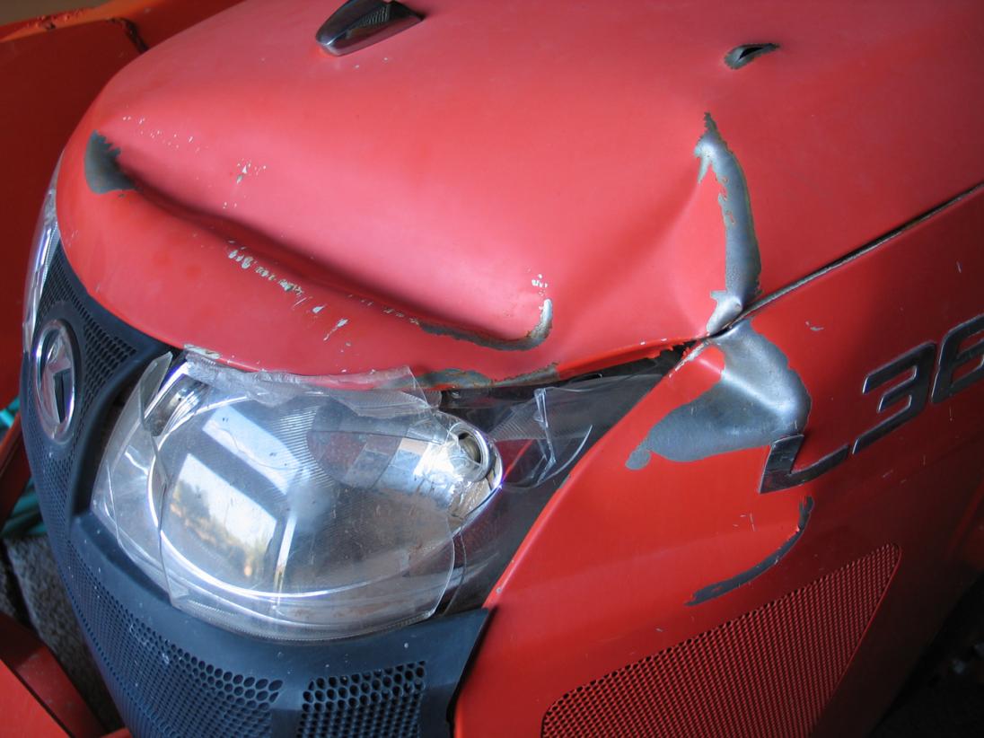

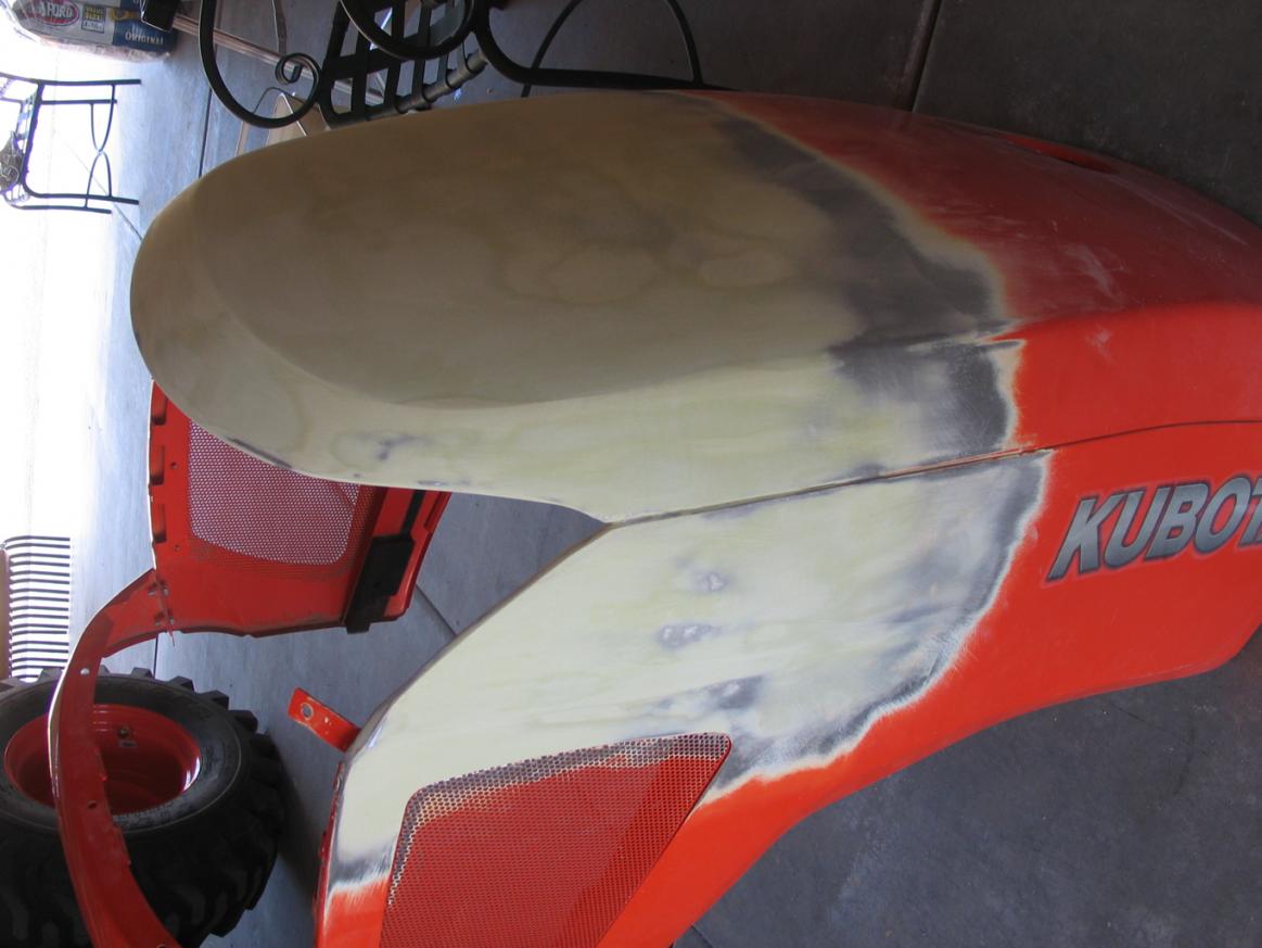

I was looking for a "decent" hood to replace the one on my 7100. PO dumped a load of rock over the back of the bucket completely demolishing the front of the hood and headlight area. I'm not interested in new or perfect, so though I would see what a "decent" hood might cost. I explained what I wanted, he had one with just a few minor dents, and sent me a pic. The hood (stripped, just the sheet metal) was at best *rough* (but not as bad as mine). IIRC, he wanted over $300 + crating and shipping fees. I told him I would pass.

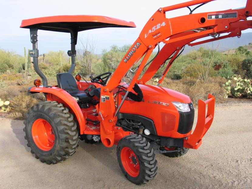

For all you guys with dented sheet metal, don't forget your local body shop!!!
I started out with a severely mashed hood and after a little body work ($300) I did a little paint and the guys at my dealer never knew until I showed them.
