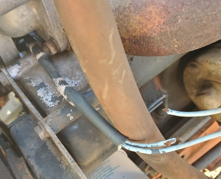

Swapping a first generation motor into a 2nd generation tractor. Older motor has a 3 wire dyno existing motor has a 2 wire dyno. Thinking the regulator and wiring must go with the existing dyno right?
Managed to get the dyno off the existing motor using a gear wrench on that lower middle nut one click at a time. Can imagine what kind of chore it is going to be to get that nut back on. Any tricks?

Bob, before you get to taking the dynamos off and exchanging them, I think there is another wire on the regulator that is not used on the two wire dynamo. I believe is yellow is color and on the end opposite the black ground. You can use that yellow to connect the third dynamo wire.
Someone else will help to confirm or deny this!!!! Be patient.

From memory, on early B5100, 6100 & 7100 the lighting system was not direct current but alternating current which is what the dynamo puts out. The third wire was paired with one other to feed the lights.
Owners of these early machines learned this when they installed LED lights which would either flicker or not work.
Kubota did this for electrical efficiency's sake as not rectifying all the dynamo output saved more energy for lighting. The downside was that the light's brightness varied with engine speed.
My suggestion is to tape off the third dynamo wire and try it in operation on your tractor with the 2 wire regulator. If you have acceptable charging voltage at the battery and your lights work, then you are all good.
The dynamo wont care is one wire is not used.
If you have no lights then we can work through a solution.

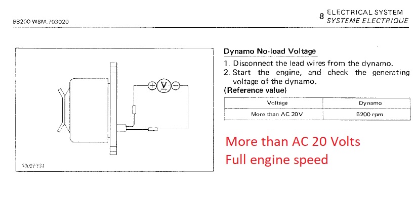

To start with you are likely not checking the dynamo properly.
You need to check it disconnected. You need to measure alternating current voltage between two wires or any two of the three if you have three. From memory around 30 volts +.
The dynamo rarely fails it is that simple.

Please do the AC voltage check at full speed.
The voltage should be greater than 20 volts AC at full speed
Voltage to ground is meaningless. The dynamo has two wire coils that do not connect to ground. Permanent magnets provide the rotating magnetic field.

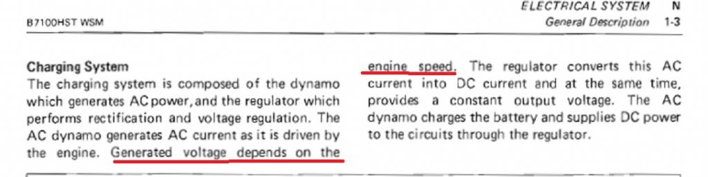

The regulator condition is determined by default. If the dynamo is good and there is low DC voltage at the battery, then the regulator is bad.

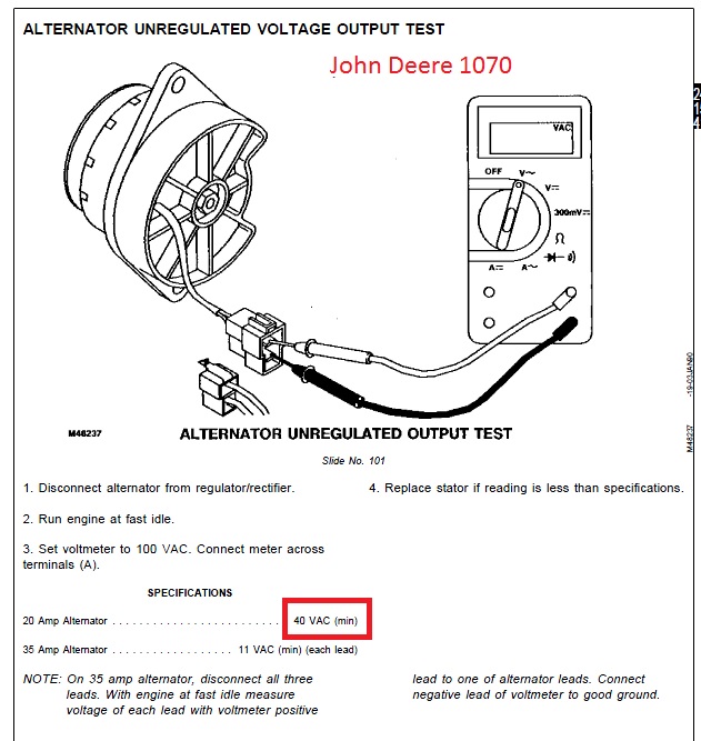

Easier to switch to a John Deere dynamo. 35 amps with three output leads. You would need to use a JD regulator.
Even a two wire JD is rated for 20 amps. Much more than Kubota's.

I would've expected to see more ac voltage than that but I'm not that familar with the B7100 dynamo. Most of what I see is zero turn diesels; most of those will make 30-90v AC depending on the speed of the engine.
