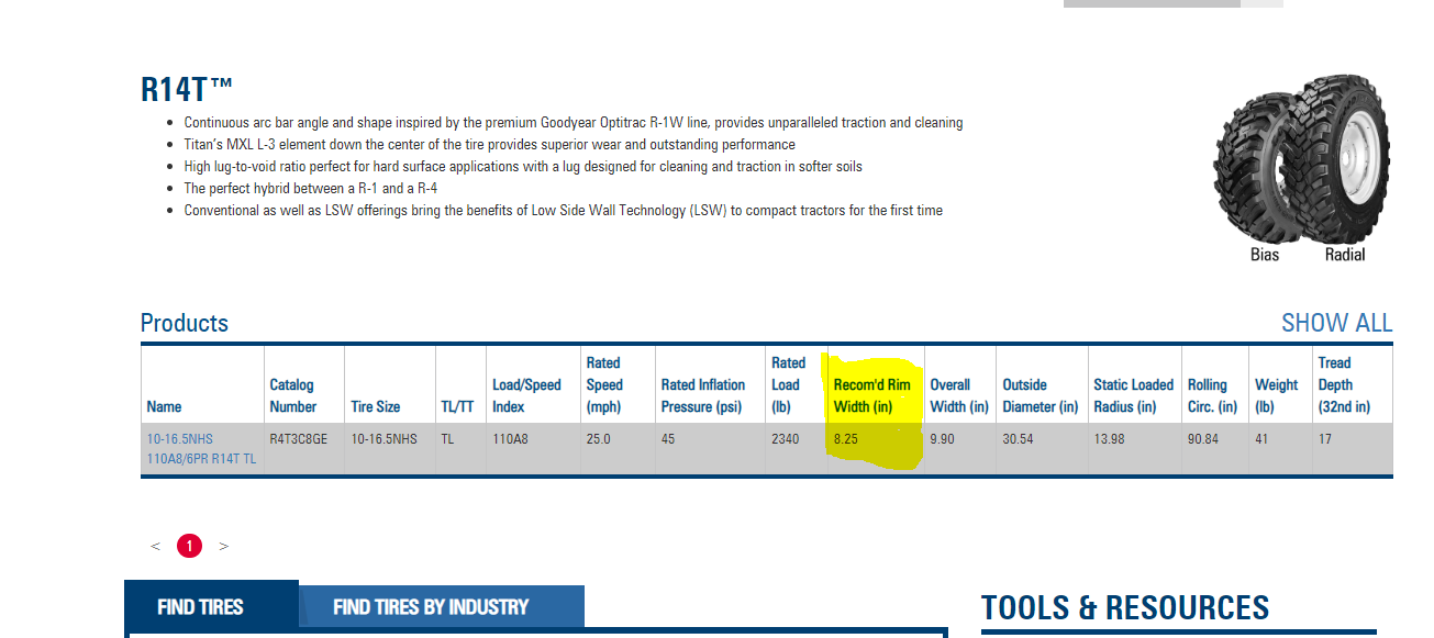

One last question - anyone know of any issues with mounting a 9.75" width tire on an 8.25" wheel? It doesn't look like anyone, anywhere, offers a 6x6 16.5" wheel. Anything 9.75" wide is an 8 lug setup.

You missed this part, so yes you'll be fine with the width
And you should be fine on front tire height as it would clear the original AG tires.
Oops! I copied the wrong link - the 12-16.5 is recommended for a 9.75" The 10-16.5 is only 90" RC which would cause the ratio to be out of bounds.
