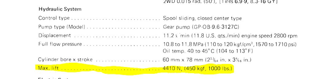

You need to double check your manual as I have 6 different manuals and they all say 1000Lb (450kg)lift on the 3 point.
EDIT: See correction here! https://www.orangetractortalks.com/forums/threads/b7100-flail-mower-maximum-size.49823/post-444535

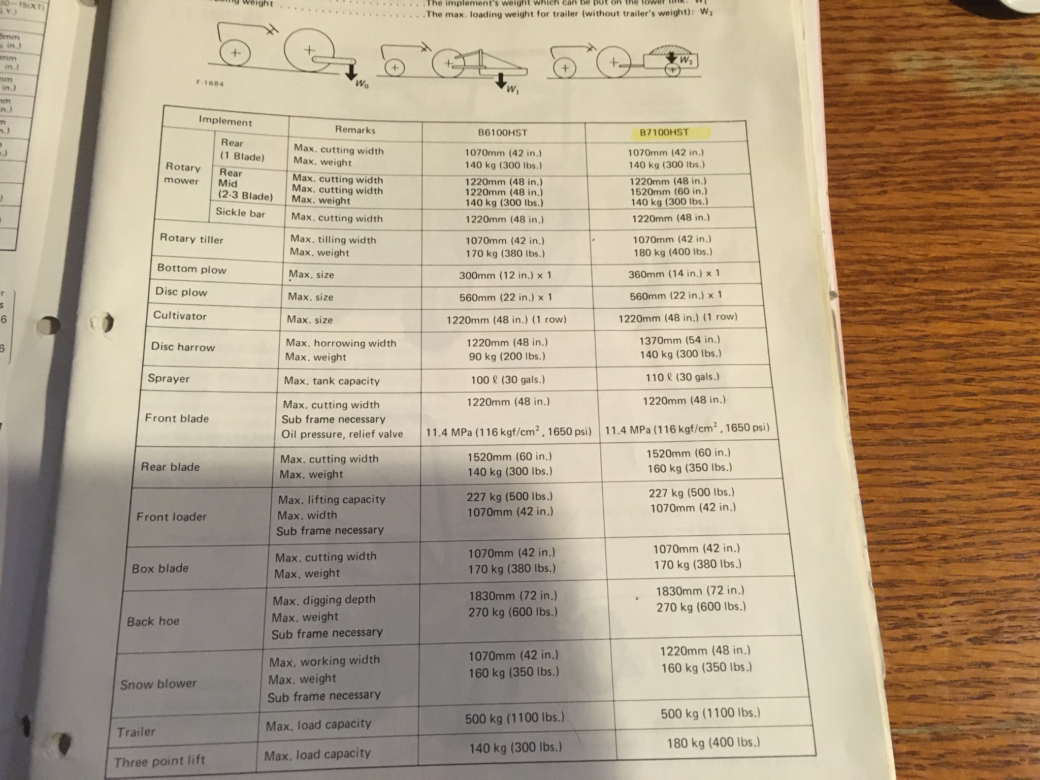

Maybe I have been reading my manual wrong, I always thought 400lbs seemed pretty weak. Here are pictures of the pertinent pages from my manual. I am reading , last row -three point lift, second column -max load capacity , fourth column 400 lbs.

Ken,
My deepest apologies I should know better then to try and get my info off the WSM's on the fly.
Here is what I was looking at:
Its the lift ability at the ends of the top arms on the three point arms.
Egg on my face. :oops:

Thankyou for your time and advice! I have been quite confused about the lifting power just like Ken.
Thought that w1 was static load and w0 was lift capacity.
1000 lbs is the best news for a long time😄
