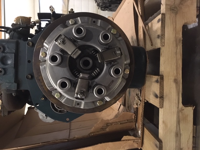

My D1105 engine arrived today. All I had time to do was open the crate and give a quick inspection. Also, I did a test fit of the clutch and pressure plate. Here are some pics of the brand new B7100 clutch and pressure plate loosely bolted onto the stock D1105 flywheel with no fitment issues whatsoever, as I was expecting. I guess that’s that obstacle sorted out.
I MAY need to machine a pilot bearing, not sure. This clutch did not come with one so I’ll have to order one separate and see how it fits. Also, this flywheel will have to come off and get resurfaced before being put into use.
Aside from that, the engine looks like it’s in excellent shape!

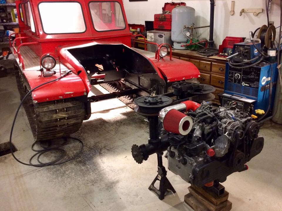

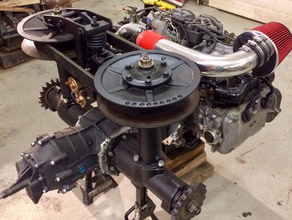

Cool! My last swap was a computerized Subaru 2.5 engine into a 1967 Swedish track rig called a Snow-Trac.
